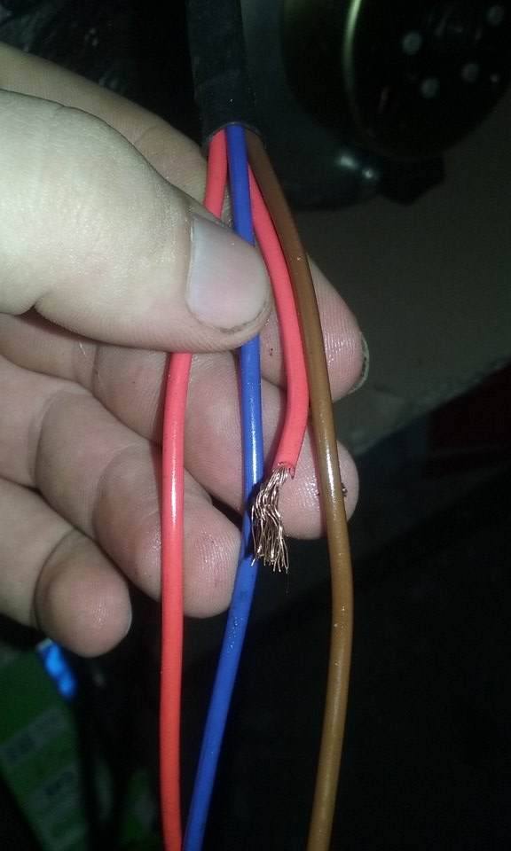

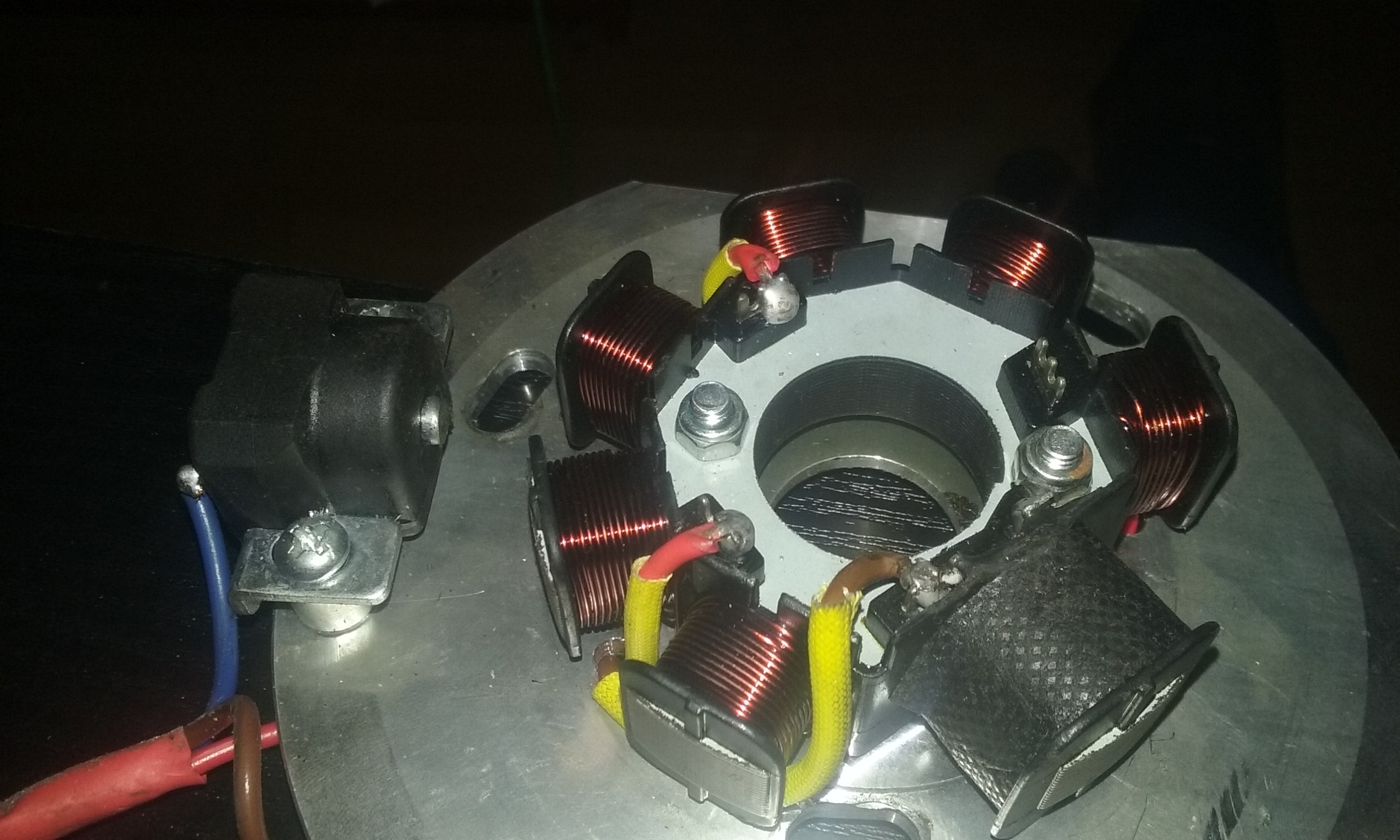

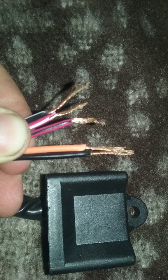

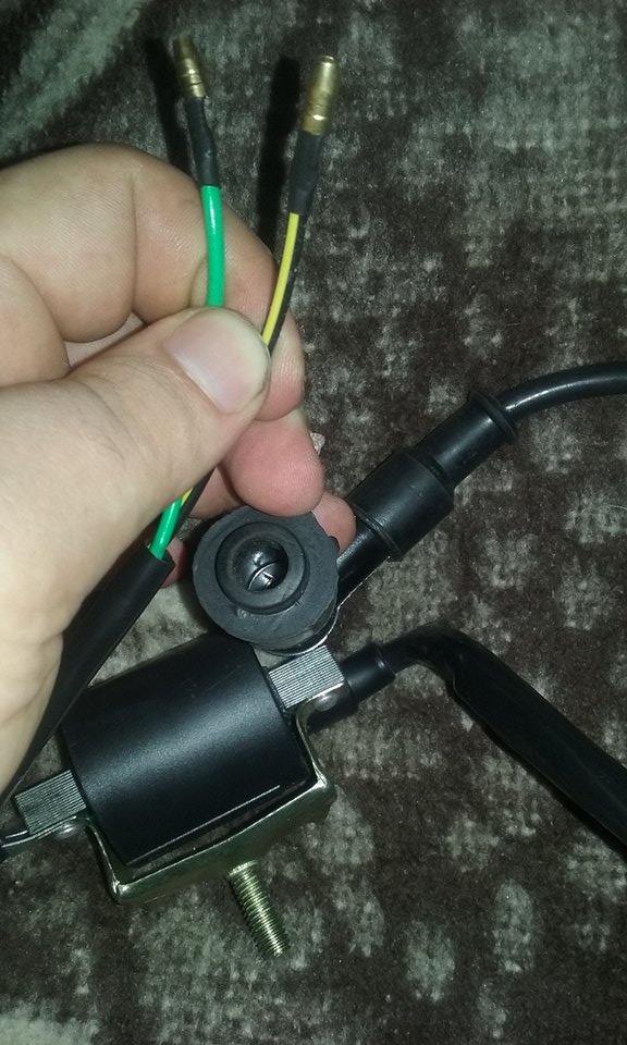

    hello i got ignition to CDI but i didn't get instructions how to connect the cables

    coil
    1.green - mass
    2.black yellow-plus
    module
    1.orange -coil
    2. black - coil and frame weight
    3.black white - quenching
    4.red white - pulsator
    5. red black - module power supply
    In your cables, you need to see which one goes to the pulser and which one to power the pulser

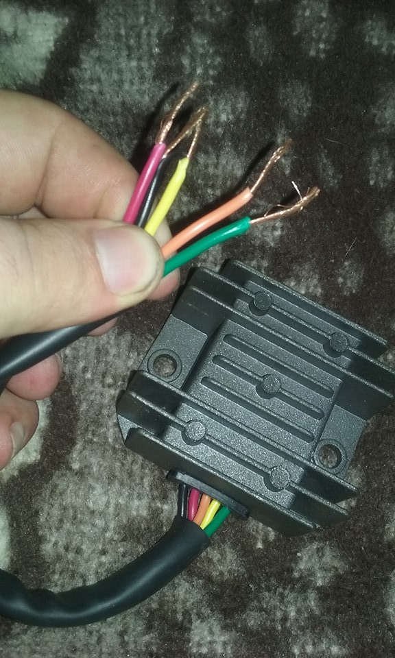

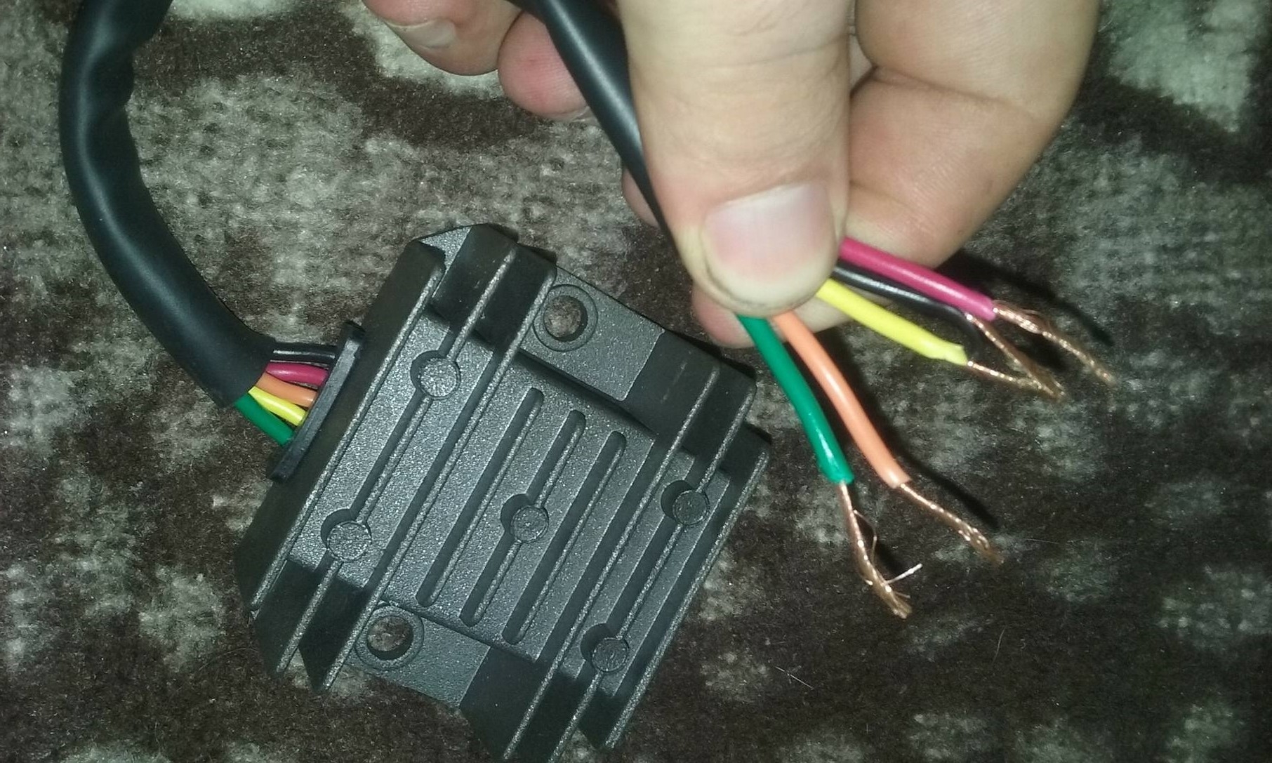

    WSK 125 Electrics: CDI Cable Connection Guide and Ignition Instructions Needed
    and what should I do with these 4 plus

    1. brown-power module
    2.niebieski-pulser
    3.2x red - to the regulator
    As for the regulator, I don't know what kind of regulator it is, but there are simpler regulators for PLN 15 and up to and including perfect performance

    so one red can go to the lamp and the other to the battery
