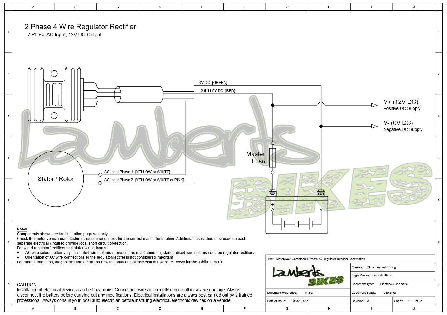

What is the difference between a half-wave and full-wave rectifier/regulator wiring method on a motorcycle charging coil?
The two wiring methods are just different ways of using the same charging circuit: one is a half-wave rectifier/regulator that grounds one end of the coil and uses only one half of the AC waveform, while the other is a full-wave arrangement that rectifies both ends of the coil [#21683671][#21683677] In half-wave operation, the unused half of the AC waveform is simply ignored, and the rectifier/regulator can be cheaper and simpler [#21683674][#21683675] That does not mean you only get half the usable charging power, because the regulator still converts the AC to DC and limits the output to roughly 13.5–14.5 V for battery charging [#21683677] For a motorcycle, half-wave rectification can still provide all the power needed for the lights and battery charging [#21683677][#21683679]

  • Half-wave rectifier only outputs 5–6 VDC for charging

  • Half-wave rectifier explanation for bike charging output
    #8 21683677
    Alan Gallagher

The discussion addresses the difference between two wiring methods for rectifier/regulator units in a 12V charger ignition system for a 1976 RD400 motorcycle. One method connects a single wire from the charge coil to two wires on the rectifier/regulator with the other end grounded, while the other method connects both ends of the charge coil directly to the rectifier/regulator, with separate positive and negative 12V outputs. The key technical distinction lies in the type of rectification: half-wave versus full-wave rectifiers. Half-wave rectifiers use only one half of the AC waveform, resulting in lower DC output voltage (around 5-6 VDC in some cases) and potentially reduced power output, while full-wave rectifiers utilize both halves of the AC waveform for more efficient power conversion. Half-wave rectifiers are simpler and cheaper but may not fully meet the power demands of a 12V battery system. The choice of components, including different transistor types, may reflect design updates or cost considerations. The AC voltage from the motorcycle’s generator typically ranges from about 14-15 VAC at idle to higher voltages at increased RPM, which the rectifier converts to regulated DC voltage suitable for battery charging and lighting. The discussion also references specific ignition system components and highlights the practical implications of using half-wave rectification in motorcycle electrical systems.
