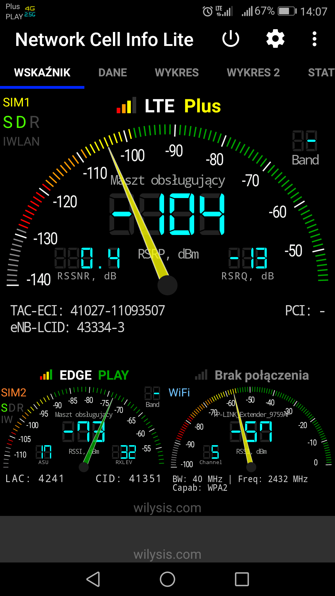

    I am looking for a comprehensive 2in1 solution - i.e. an external router + antenna in one.
    At the moment I tested MR-200 + various types of external antennas. DUD.
    Yes I know - that the MR-200 is not a high-end router - but it has external antennas - so you could test different antennas.
    At the moment I found the following models:
    - LTE Router Technologic ODU-3-16-N02
    - MikroTik SXT LTE
    Are they worth anything?
    The location of the building where I need LTE is:
    Pomorskie / Rychnowy.
    At present, the MR-200 has approximately 1Mbps in the building, after temporary transfer to the roof it already has a stable 22 Mbps - which is worth:]

    Operator selection and equipment purchase is preceded by operator tests at a specific location. Purchase of MR200 for PLN 500 is an error, at this price you buy a router with aggregation of LTE bands and the possibility of forcing specific LTE bands and aggregation. In Plus, the closest BTS Plus in Człuchów in MOS, LTE1800aero2 and LTE800Sferii operate on it as well as aggregation of these two bands. In Rychnów, the range on LTE800 Sferia is slow because it is only 5MHz bandwidth in MIMO and DL up to 37.5Mbps. Operator selection is weak, Plus can be overloaded. What MR200 antennas have you tested? What LTE signal parameters do you have on your Cell Cell Info phone? This location uses Orange and T-Mobile which have their LTE800 in Rychnów. Plus 3BTS LTE1800NetWorks in Człuchów. Even Play, which in Człuchów has three BTSs with LTE1800, LTE2100 and LTE800 and LTE-A of them is a better choice. Purchase of Mikrotik for PLN 470 is another mistake, it has only LTE category 3 modem but works only on LTE1800 and LTE2600 and the built-in antenna has 9dBi gain. A better device is Technologic, it has a 3G / LTE modem working in all bands available in Poland, but only 3 categories. Price 550 PLN adequate to the possibility, 16dBi antenna gain questionable. Do LTE Plus tests on your phone with NCI and show screenshots, plus DL / UL at peak times. Home and roof tests.

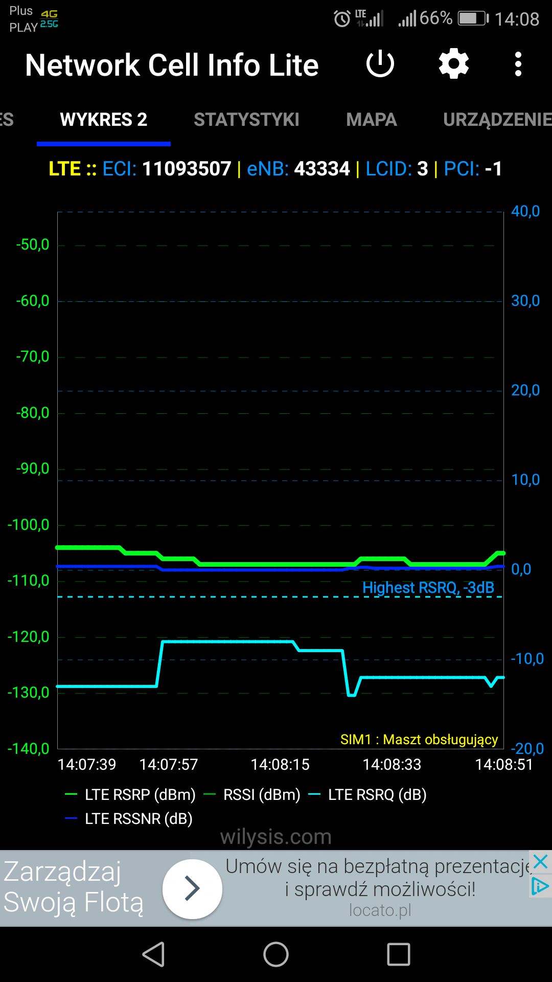

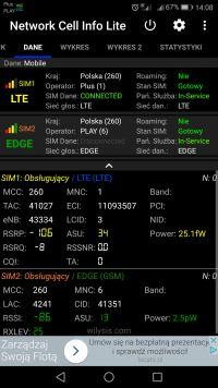

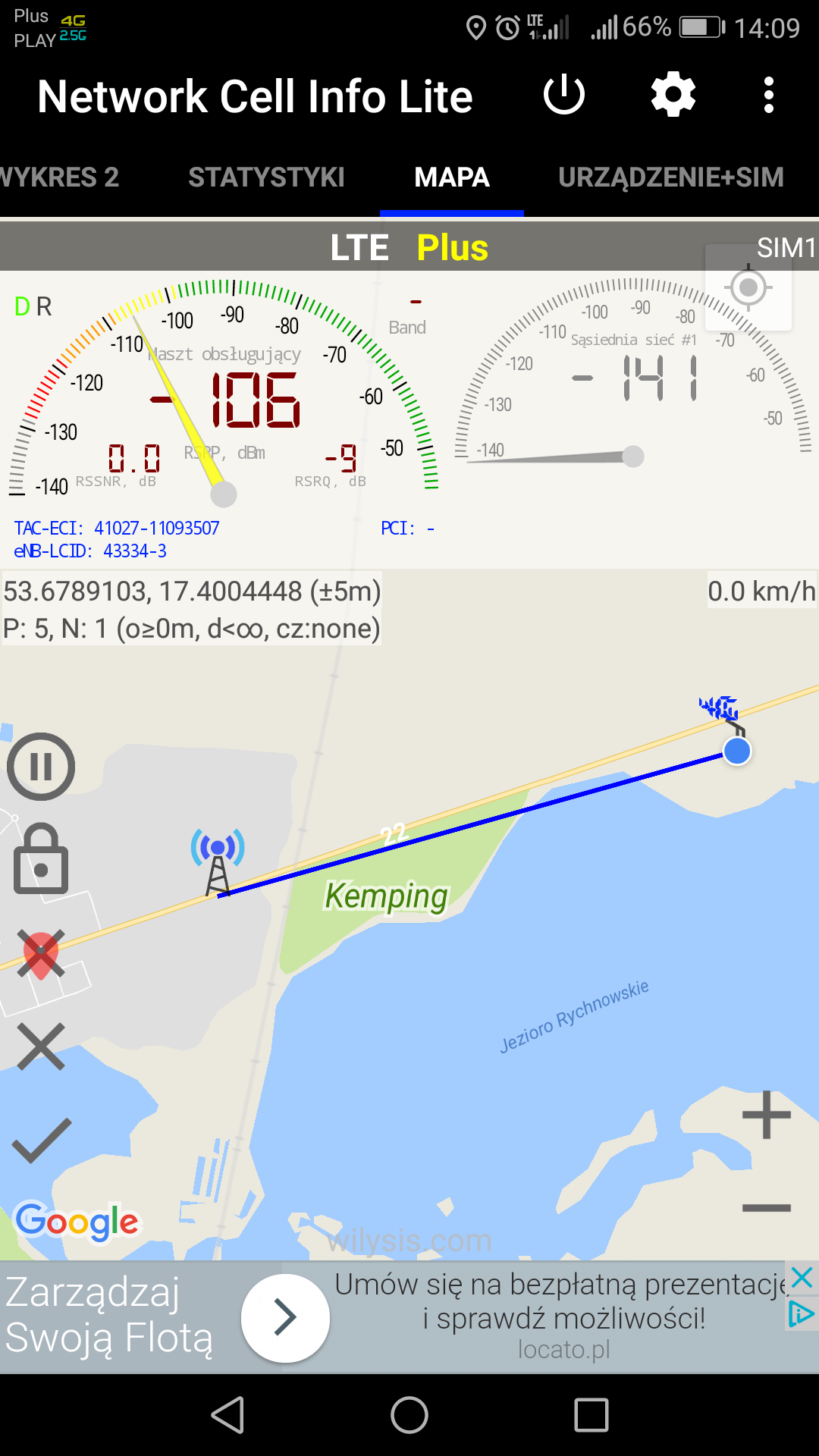

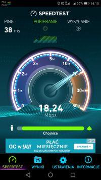

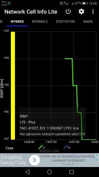

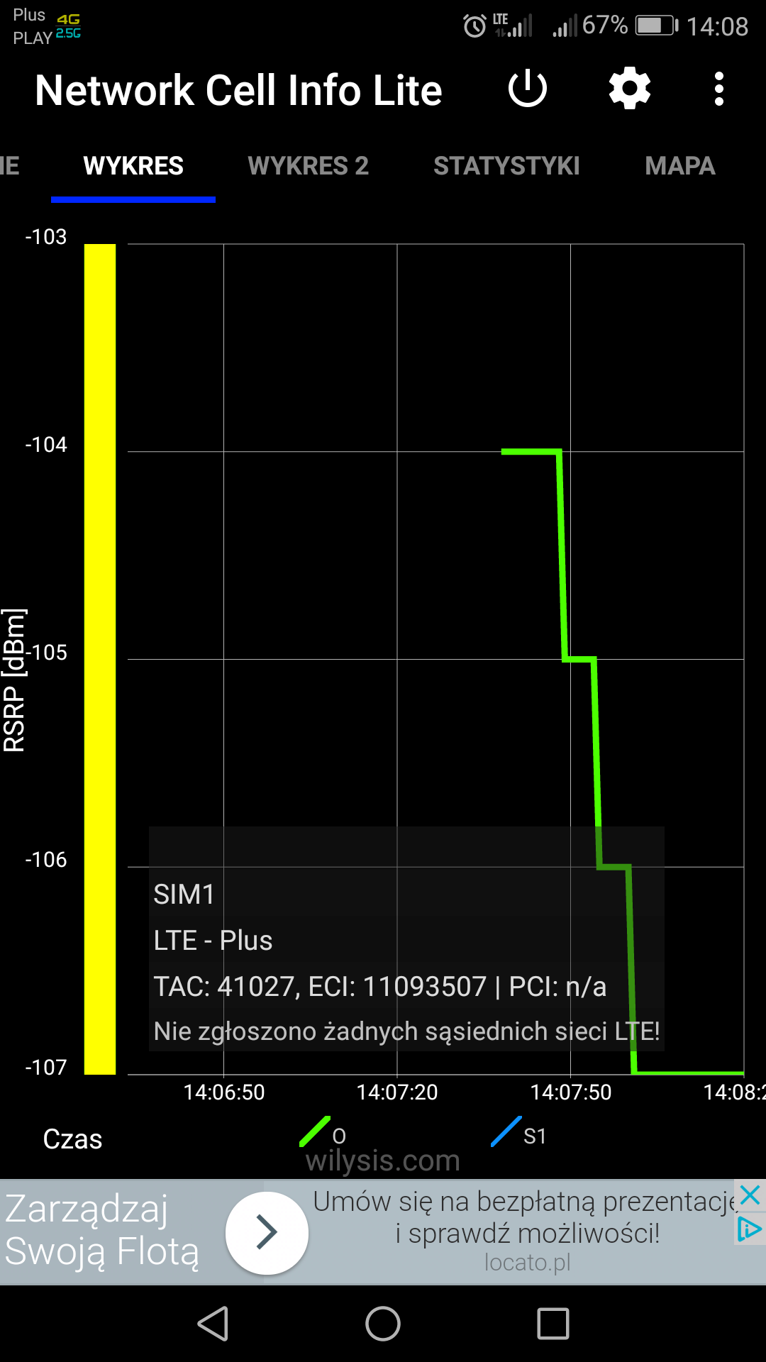

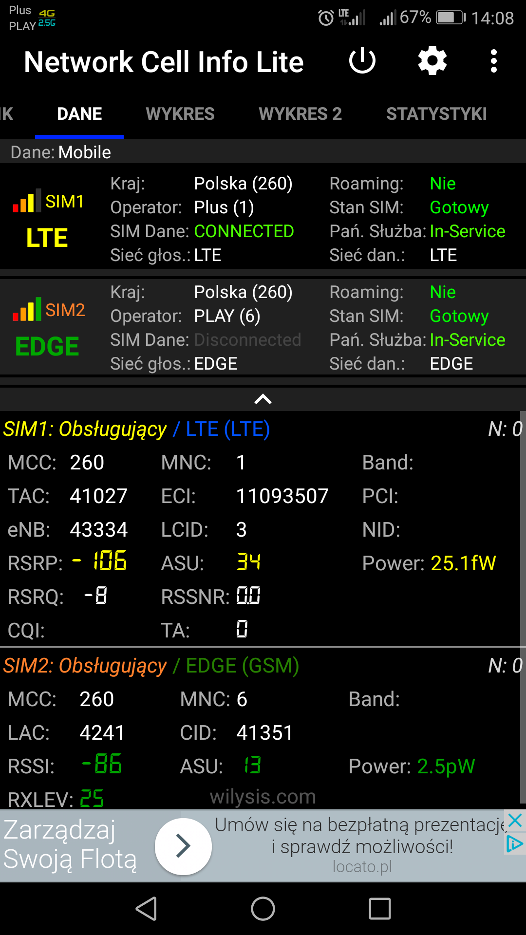

    This is a connection with the second Plus BTS at Słowackiego 19, the signal parameters are weak. There are licenses for LTE1800Aero2 and LTE800 Sferii but rather one of them works. You won't force a specific LTE band on MR200. You need to confirm under BTS whether LTE1800 is working and perform a test near it, compare the ECI with that in Rychnów. Speed tests are only relevant in the internet summit. MR200 is a router with WiFi in AC but LAN ports at 100Mb / s which is odd. A better choice is B315s-22, new for 350 PLN and used for 250 PLN. Works with LTEWatchH and Toolbox 0.9 with which you can force LTE bands, shows CID and BTS data. From routers with LTE-A for about PLN 500 you can buy B618, B525 or E5186, they work with these programs. Replacing the router will not help, the signal parameters are weak and an external directional antenna is required for the selected band. You didn't answer what you tested.

    You didn't answer the question about the antennas you were testing. It is still not known how the LTE1800aero2 BTSs in Człuchów on MOS and Słowackiego are loaded and what speed they provide during internet rush hour. For this you need tests under them in your direction. Well, why just an external CPe on LTE instead of a router and a decent directional antenna?

    If the connection to LTE1800 Aero2 from Słowackiego is confirmed, then an effective antenna is http://www.cybertech.com.pl/p154,antena-dualna-lte-4g-15dbi-mimo-do-tp-link-archer-mr200-tl -mr6400.html cable as short as possible, maximum 10m. the antenna fits all LTE and LTE-A fixed routers with SMA connectors. As for the test, in the Network Cell Info application it showed you ECI and eNB BTS from Słowacki. You do the same under it and compare ECI.
