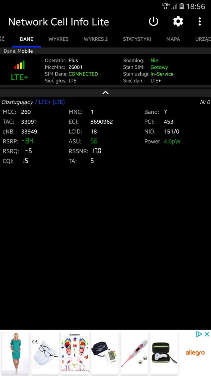

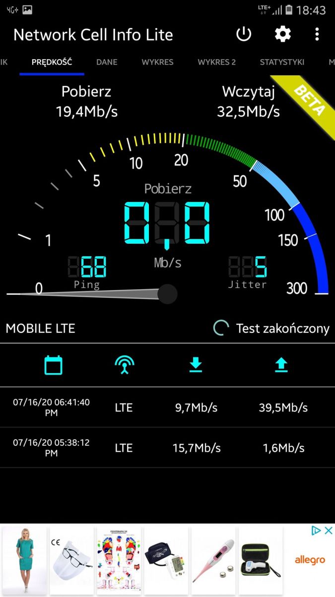

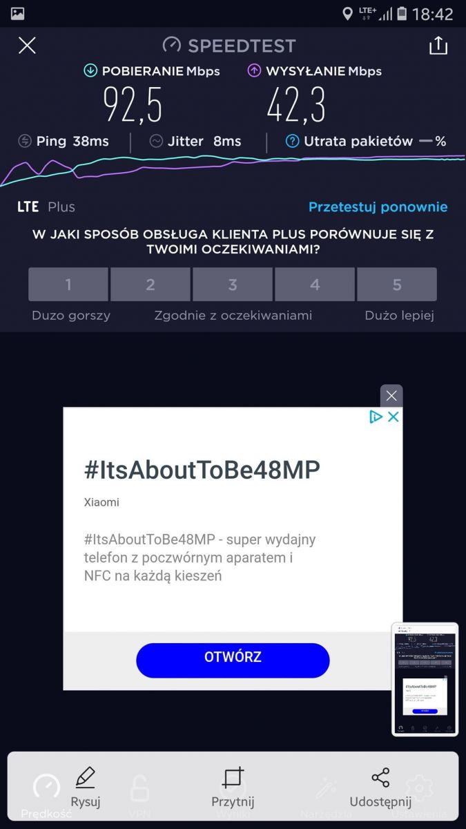

    Screenshots of internet tests plus Which lte router to choose and which external antenna to choose. Which lte router to choose and which external antenna to choose. Which lte router to choose and which external antenna to choose.

    Coming back to the merits of the matter, the speed tests after 18 were ambiguous, the results were completely different. The station load changes in 2 minutes in a massive way, a test should be done between 20 and 22. The station is saved by FDD LTE2600, the test is made in its vicinity, the signal parameters on LTE2600 are correct, for this band in LTE1800 aggregation.
    I'm going CPE LTE is to use them at a reasonable distance from the BTS without the need for an external antenna. In the case of odu-300, a distance of 500m disqualifies the device as a CPE LTE.
