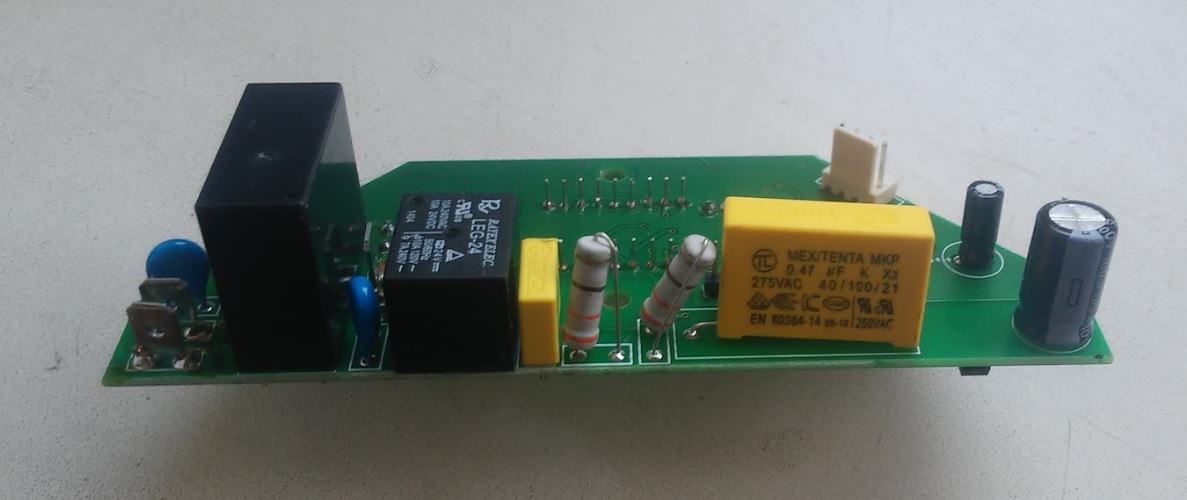

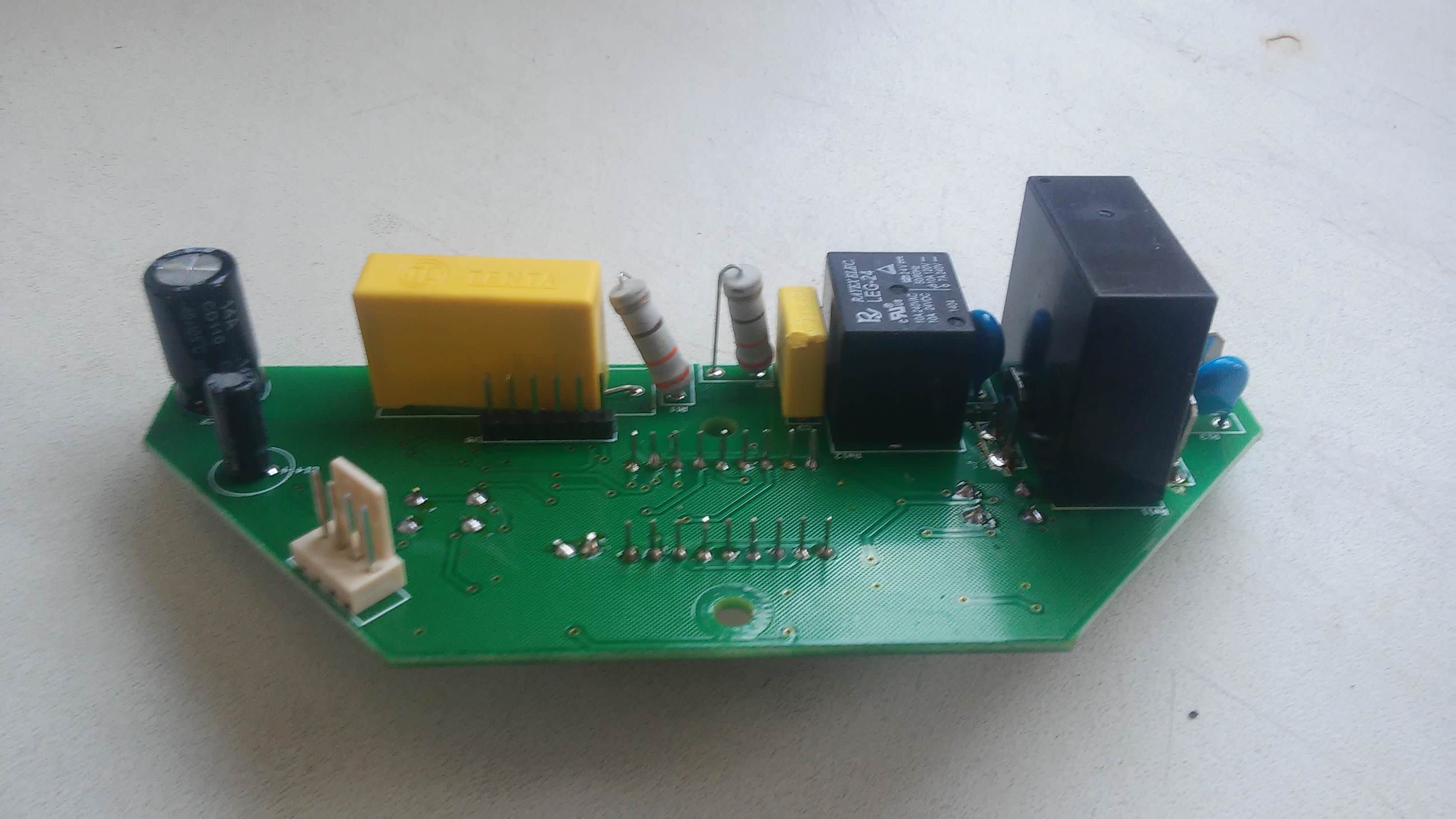

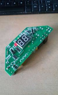

    Hello, I am the owner of the Galmet Neptun Kombi DHW exchanger with electronic control.
    I can't heat the water for some time, the exchanger starts up, then turns off after a second and so non-stop, sometimes after a few resets it will work and heat the water, but it happens sporadically. After pressing + and - on the temperature controller, it shows error E3, i.e. according to the instructions
    5.2. Thermal switch
    The thermal switch is an independent protection with a separate temperature sensor which, in the event of a thermostat failure and heating the water to 85 ° C (+- 3 ° C), cuts the power to the heater at both poles. after the thermal switch is triggered, the error code E3 flashes on the display and all the thermostat functions are inactive.
    5.3. Resetting the thermal switch
    The thermal switch is non-triple, it means that after activation (turning off the heater) it requires user intervention to restore it to the previous state. After the thermal switch has tripped, disconnect the device from the mains for at least 5 seconds and then reconnect the power supply. if the temperature has dropped below 85 ° C, the thermostat will return to normal operation
    Unfortunately, the attempt to "Reset the thermal switch" has no effect.
    I also recorded a short video of how it looks in practice
    Galmet Neptun Kombi DHW Heat Exchanger: E3 Error and Thermal Switch Resetting Galmet Neptun Kombi DHW Heat Exchanger: E3 Error and Thermal Switch Resetting Galmet Neptun Kombi DHW Heat Exchanger: E3 Error and Thermal Switch Resetting
    I unscrewed the electronic controller from the exchanger. What does the thermal switch look like in this model, where to look for it? Or maybe you know a different solution to the problem?
  • #2 16618256
    Loker
    Posts: 3368
    Help: 575
    Rate: 721
    Bad photos.
    First, to check the electronics power supply, i.e. (probably) the big yellow capacitor.

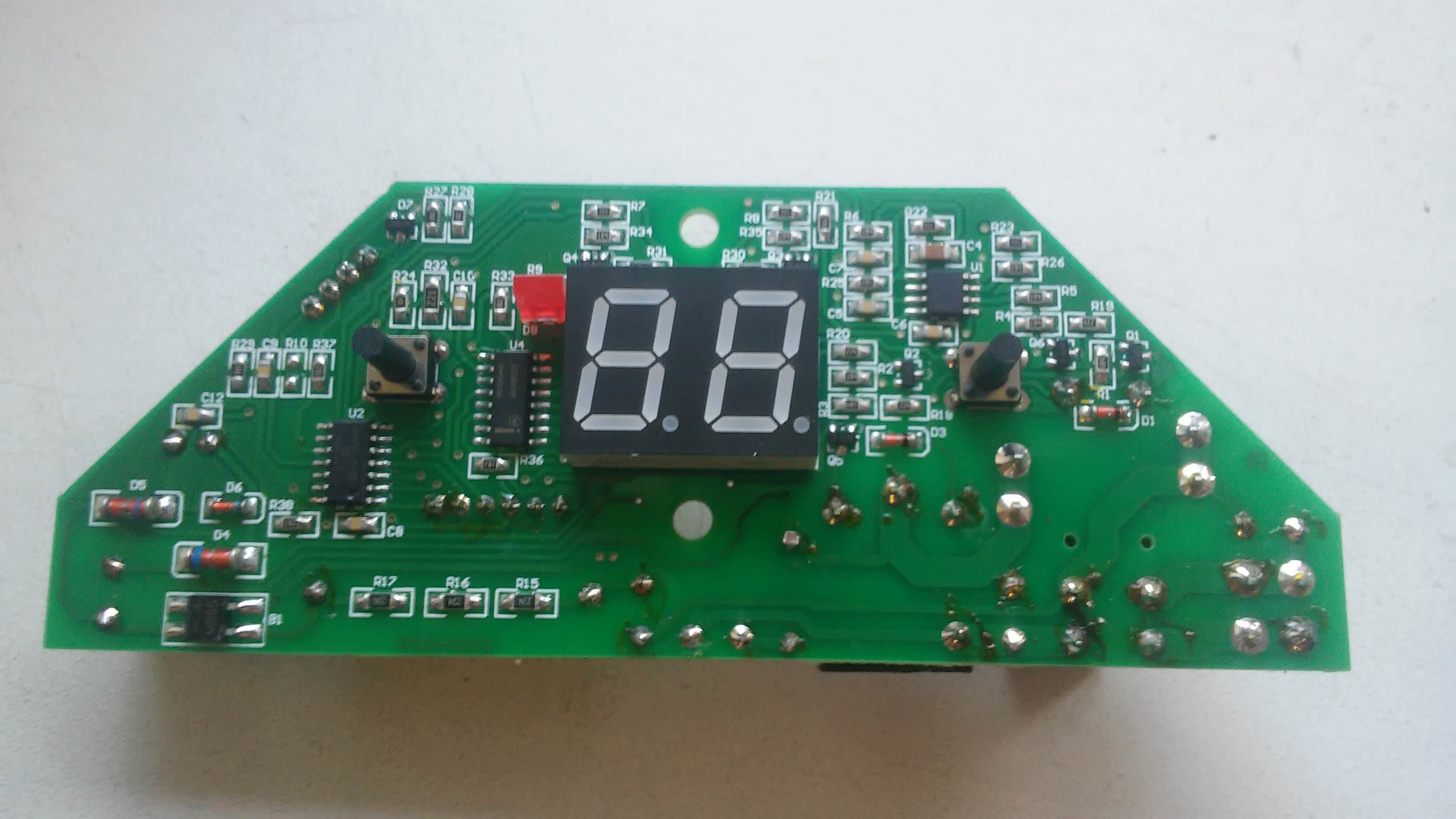

  • #3 16618330
    JakubPPL
    Posts: 46
    Rate: 12

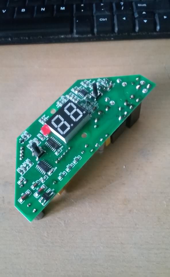

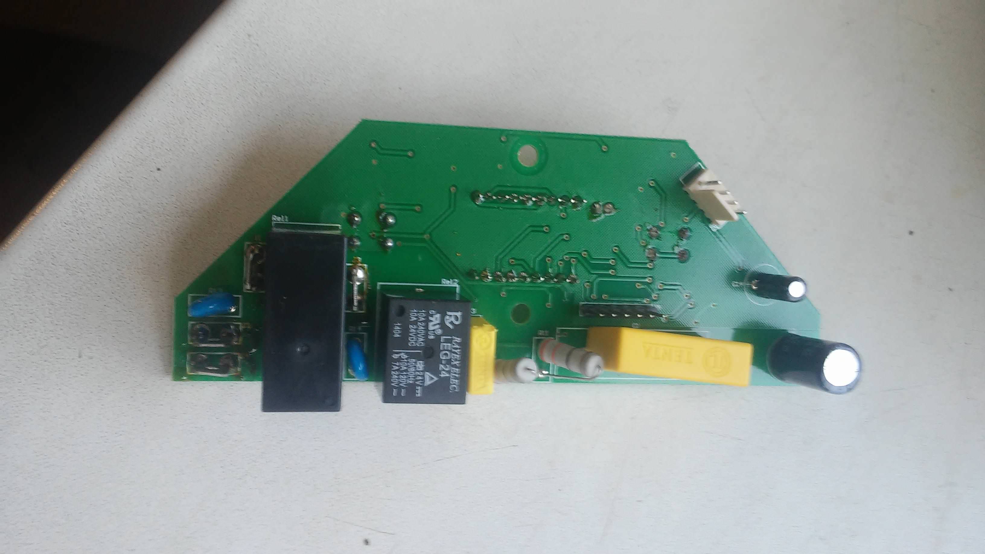

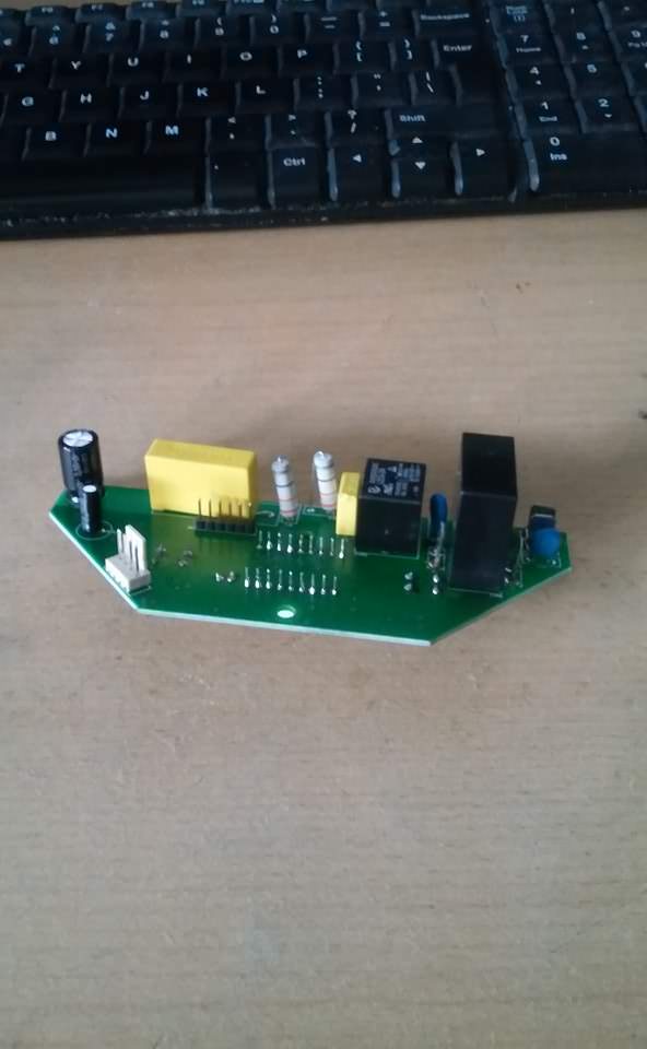

    I took new photos, unfortunately the quality is not amazing but I do not have access to a good camera at the moment
    Galmet Neptun Kombi DHW Heat Exchanger: E3 Error and Thermal Switch Resetting Galmet Neptun Kombi DHW Heat Exchanger: E3 Error and Thermal Switch Resetting Galmet Neptun Kombi DHW Heat Exchanger: E3 Error and Thermal Switch Resetting Galmet Neptun Kombi DHW Heat Exchanger: E3 Error and Thermal Switch Resetting
  • #4 19999317
    figzbig
    Has it been repaired? If so, what was the cause?
  • #5 20052407
    lechistan68

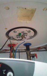

    On the panel you have a four-pin jumper to which a black wire is probably plugged in, it enters the boiler there you have a thermal switch, you need to pull it out. Probably it is failing.
  • #6 20060721
    figzbig
    It was the same for me. Error E3. It turned out that this yellow capacitor is out of order. Everything works fine after replacement.
