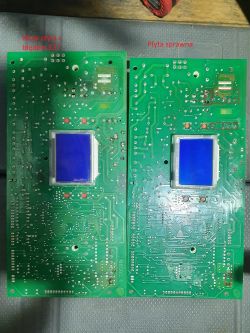

    I had a problem with the E37 error in the Immergas Victrix X 24 furnace. It helped to drill the aluminum rivet connecting the switching diode with the heat sink, apply thin thermal paste to the contact of these elements and screw it again with a screw and nut.
    I've fixed a few cold solder joints before but that didn't eliminate error 37, but it's worth doing.
    Is another thread describing that "replacing the disc helped" but closed so I can't add anything there
    PS Unfortunately, today after a few days the error appeared again. I'm still looking for the cause. Maybe the capacitors are worn out? How to measure the capacitance of electrolytic capacitors?
    So I ended up giving the board to a friend from the forum who deals with it professionally. You can also find his announcement about fixing the e37 error on the Internet.
    Fortunately, I didn't do it myself, because the problem was not where I suspected. I decided that it's not worth learning from my mistakes just to fix one of my albums.
    The service was done properly and efficiently. The furnace is now running without an error signaling.

    Unfortunately, the "repairers" do not want to reveal this ... after all, they earn money ... but if someone would like to try to repair it themselves, I upload photos of the repaired board with marked places that, in my opinion, were resoldered (recognition "by eye" after shiny new solders and elements that were matted on my board ... Note!!! I got a working board in exchange for my damaged one with an E37 error, so there is no certainty that the one that was working before the repair had the same problem).

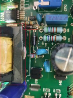

    The E37 error is caused by too low supply voltage or more often by a fault in the viper53-based switching power supply. This power supply should output voltages of approx. 28 V (C55) and 240 V (C58). The controller will spit out the E37 error if the latter voltage at the output of the power supply drops below 197 V.

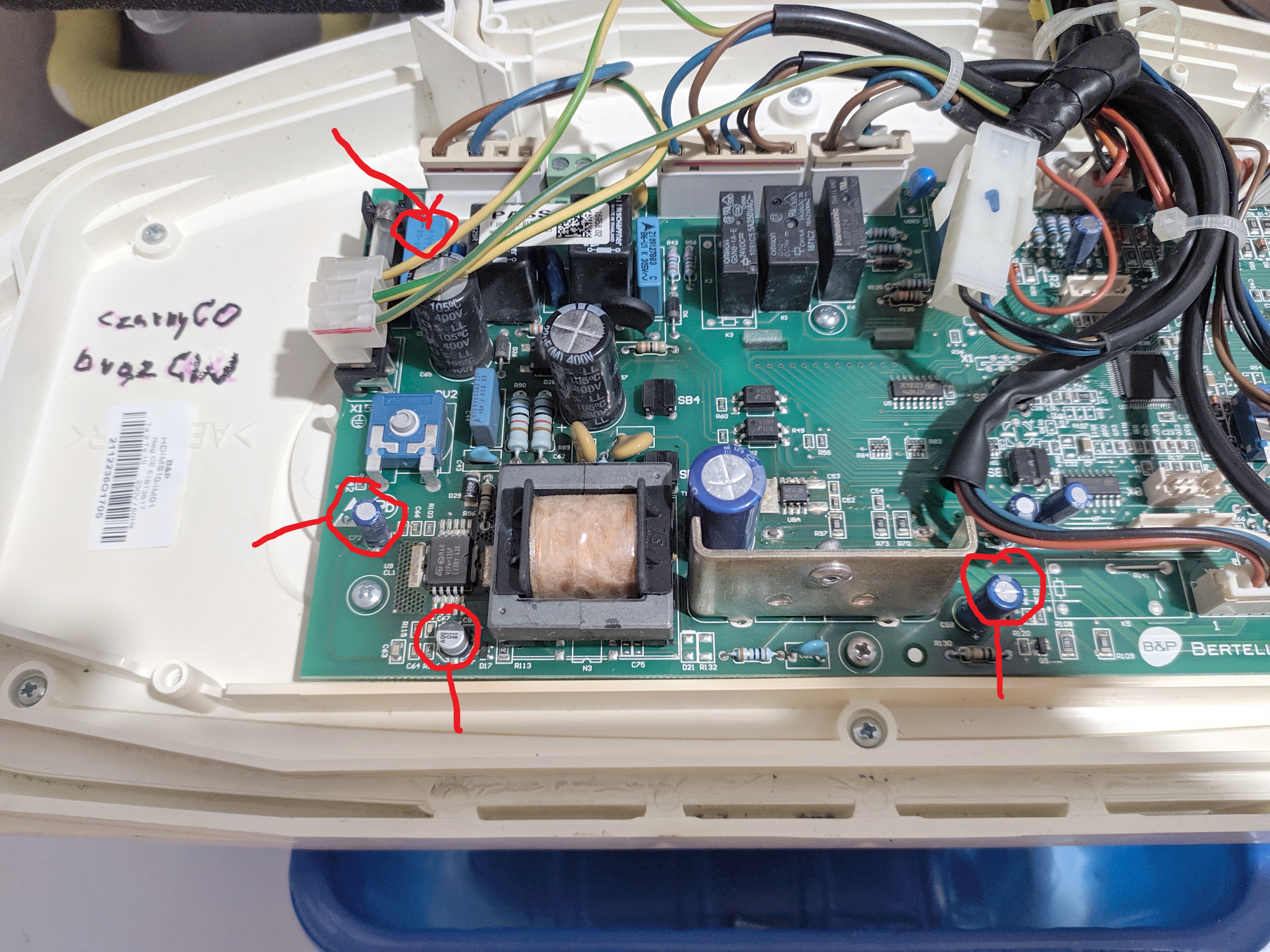

    Hello, my Vitrix 24 got error 37, in addition, sometimes it did not heat the water in the tank. The capacitance of the capacitors is not critical, but it is recommended that they be 105 degree capacitors and branded ones, e.g. Rubicon. The following have been replaced:
    C50 -330nf/305V to 220nf/275V X2 MKP
    C83-10uf/50V to 22uf/63V
    C58-1uf/400V to 4.7uf/400V
    C72-22uf/63V to 22uf/63V
    Marked in red in the photo.

    I also replaced the electrolytic capacitors first. Everything worked perfectly fine after that... for a couple of days and then the error came back. It's not the capacitors that are causing the problem. At least they weren't on my record.

    A week of trouble-free operation of the furnace has passed, so it was a shot at 10. Repairers are offered to buy an RLC element tester, once available at the electrode or in online stores for several dozen zlotys. This greatly facilitates and speeds up the repair.
    Other faults that I removed were a leaking 3-way valve. Unfortunately, nothing could be adjusted from the existing o-rings. I used cut silicone sealing tabs similar to a computer power plug.
