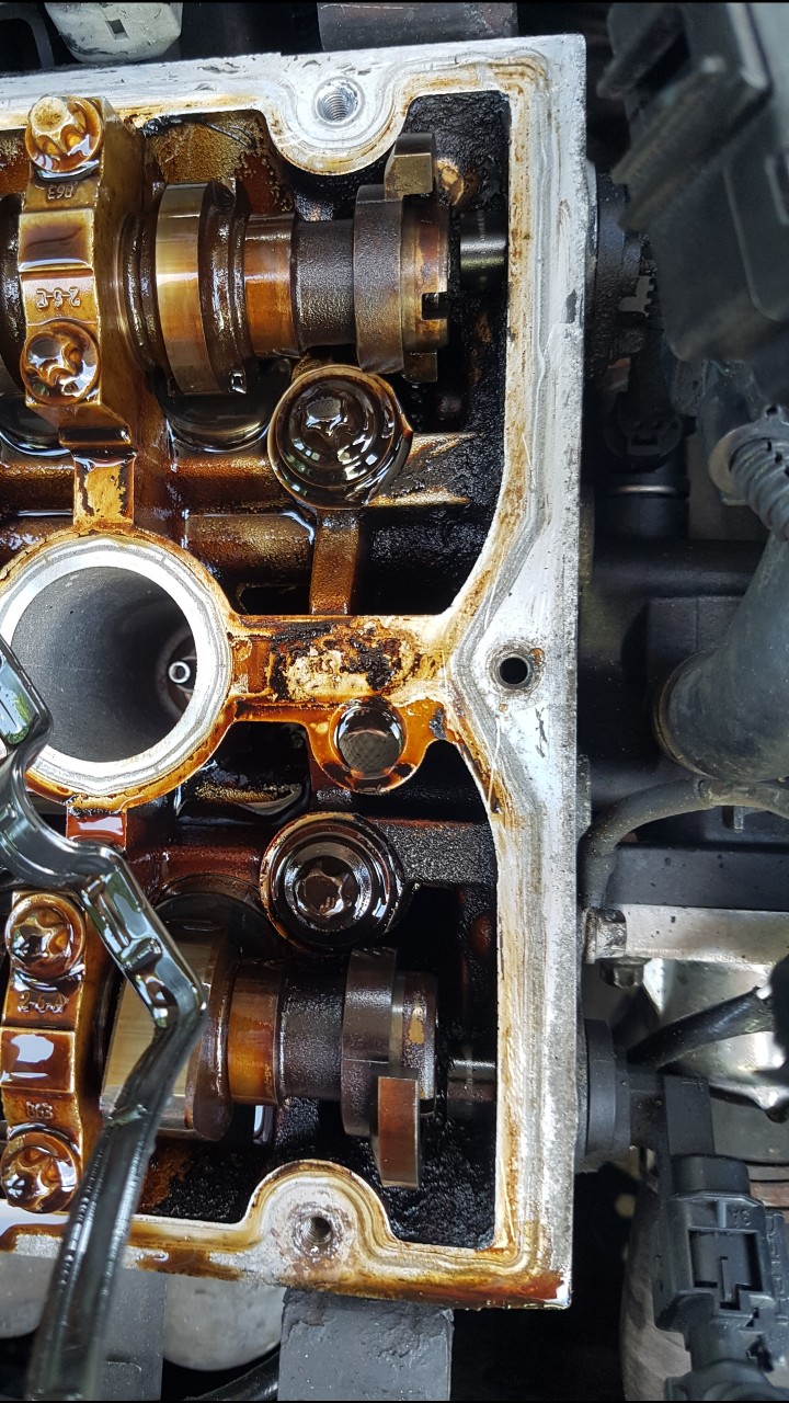

    Hello everyone. I have astre h 1.6 xer and I have such a problem with sensors. I will say in short two original ones, the mechanic bought new counterfeits and the case looks like that after driving about 30 sometimes only 100 km the car loses power and you can hear the buzzing sound as if the exhaust is leaking and the computer shows an error from the suction side sensor. I bought a used original But there is a problem immediately after starting the car, I even tempted to start a new Continental company and there is a problem with the exhaust although I started working for a while But not the first time. Despite this, the car behaves best on the original, except that it is so raining and you have to stop for a minimum of 10 minutes and works again. I have no more strength. I measured the resistance on the middle and right pins and on those that work is about 15 and on this new and used is 0.27 and probably 0.26 so the difference is huge. Can anyone know what the measurements should be. I have no more strength and the sensors are not cheap. Thanks in advance. Greetings. ;)

    Buddy, we start the sensor diagnosis by checking its power supply and output signal.

    It is best to connect an oscilloscope and compare it with the signal on the shaft.
    Then it will be known if the sensor signal is strange or timing fault.

    Now you crash camshaft sensor error. Check if it gets voltage from the computer 5v power supply. How is it you need to connect a two-channel oscilloscope and compare the signal waveform with the waveform of the shaft sensor. How will they run apart you have the cause in the timing. Unless you do not get any signal from the timing sensor is then the sensor to be dumped.

    This error you have says that the motor controller does not see the sensor so it can be: damaged installation between the sensor and engine controller, damaged sensor, damaged motor controller.
    Check the installations by unplugging the battery and then the engine control unit and check these three wires under light bulb loading. It is best to check the sensor with an oscilloscope when a problem occurs or buy the original (from the same company as it was in the original). Continental does not make sensors, I would not consider it a decent sensor.

    Welcome back. Today I checked with a diode whether the sensors are working. I checked both original and original both work. Then I checked the car and it turned out that the original ones do not work and the original ones do not give a signal. So I come to the conclusion that maybe the distance between the sensor and the shaft is too great. Some time ago I checked and it seems to be ok. I attach a picture. Now my question is whether and how the roller can "push" more to the right one and the other, and why could it come to the fact that it just stepped back? Thanks in advance. :)

    It is not possible. What is the gap on the original and what on the replacements?

    Hello one last time surely. I was able to solve the problem. There was too much "crescent" distance from the sensor (you can see in the photo that there is a trace). I don't know why they changed their place. With a screwdriver and a hammer, I brought them closer to the sensors and, like a hand, turned away. No mistakes. The car smokes after the first one. The engine is totally quieter and the car has regained acceleration. Thank you so much for helping everyone. I hope that this topic will be useful to someone someday. Best wishes. :)
