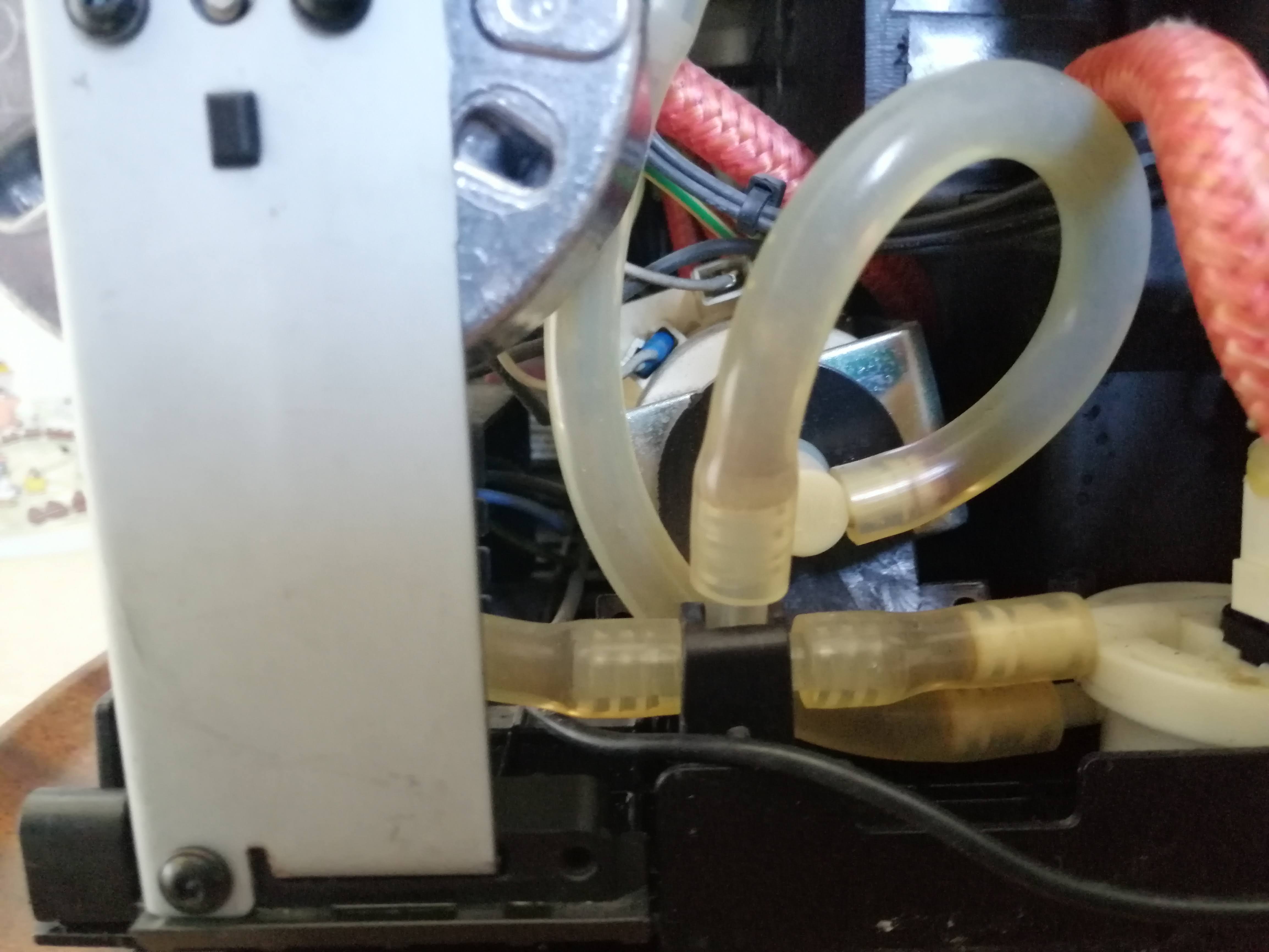

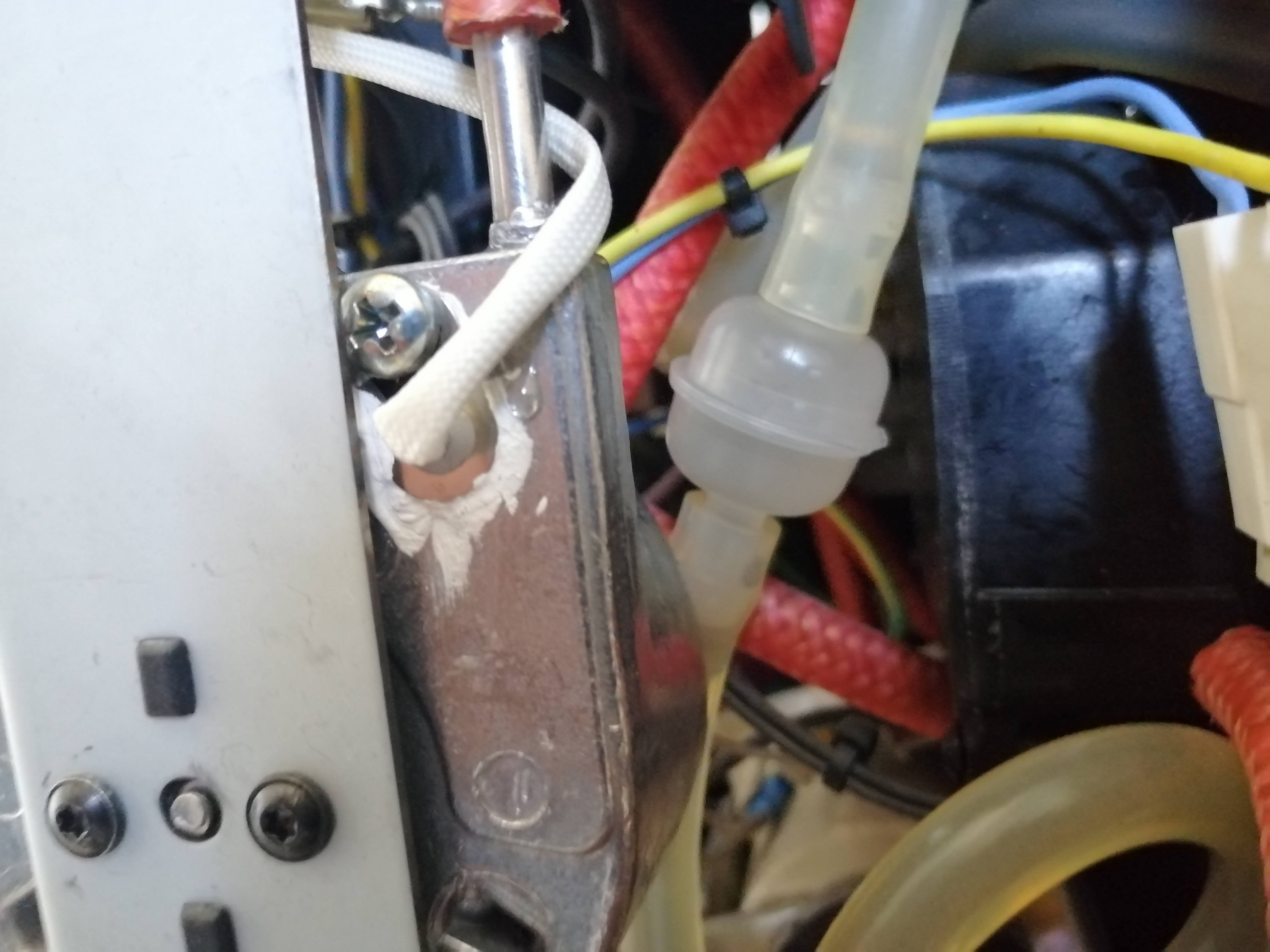

    I finally came to what causes problems with filling the circuit. The plastic body above the breather solenoid valve is the culprit, it is broken and needs to be replaced. After replacement, the problem goes away. I warn you that the seal alone gave nothing.

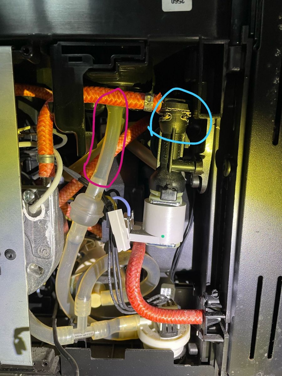

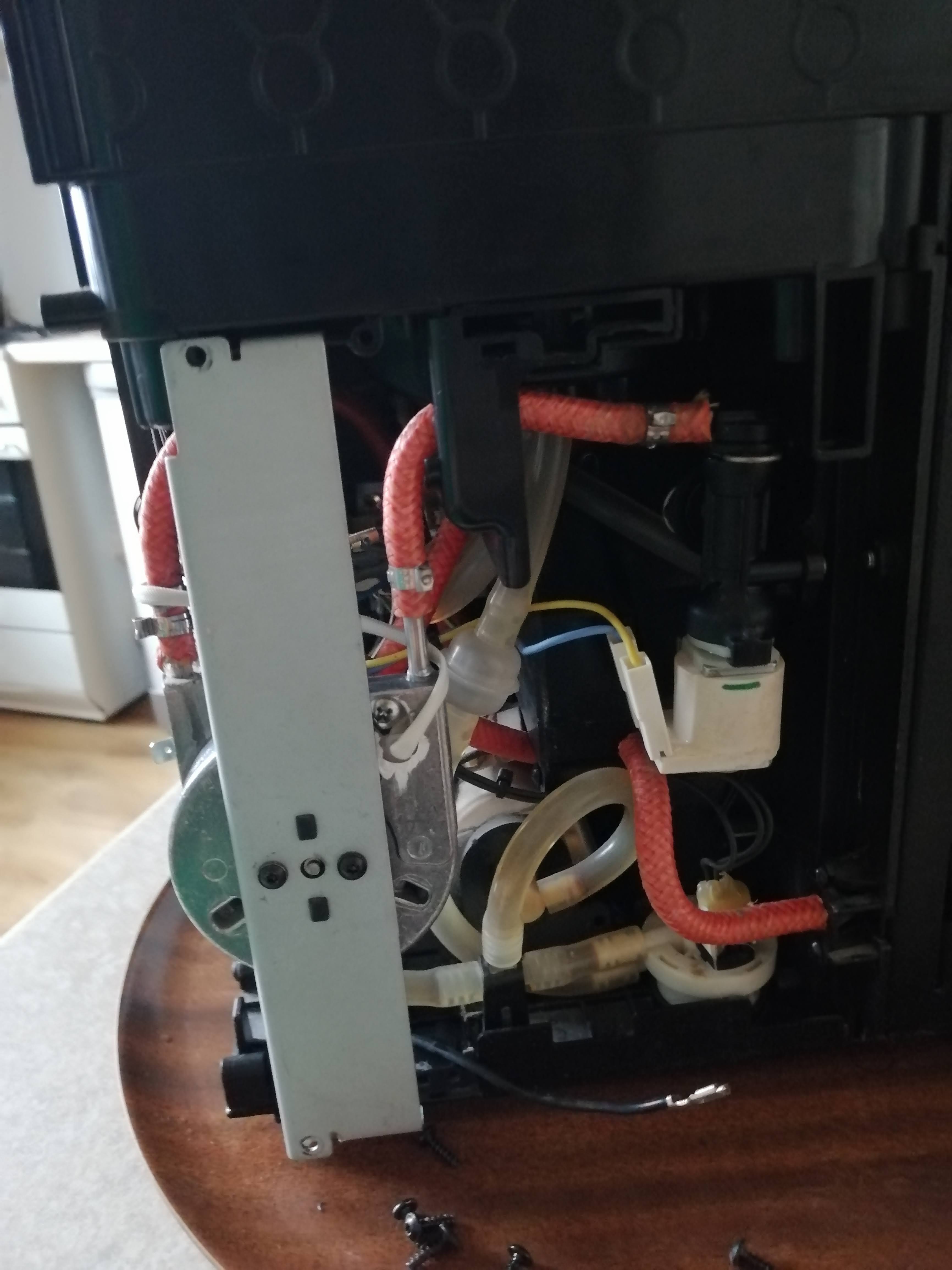

    Edenmajster
    Hello everyone.
    I'm struggling with a similar problem and I'm just starting to find the cause, and in the process I'm replacing the gaskets and balls in the pumps, as the machine will be over 12 years old now.
    I see a leak on the solenoid valve (highlighted in blue in the photo) - I have already ordered new gaskets.
    Interior of a coffee machine with marked areas of leaks and deposits. .
    In the hoses I discovered a deposit (marked in magenta in the photo), rather dark, it does not look like a scale, but either a coffee deposit (???) or some organic impurities (read: mould (?))....
    Question for you: how to clean this throughout the circuit? Generally, there is a remedy for limescale, but for dirt like this I don't really know what to use, apart from manual cleaning.
    On top of that, while I can see the cleaning effects in the transparent hoses, it comes with difficulty in the braided ones and the only idea I have is to replace the braided ones completely. I assume the same is true of the pumps and boilers and here I am completely out of ideas.
    It may not be a big problem, but I prefer to ask now that I have access to all the guts and not downplay it.
    Thanks in advance for any help!
