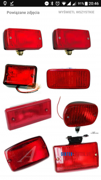

    You assume and you have.
    Converting Ford Mustang 2012 Schmat Lighting from US to EU Standards .
    Ori US have DOT approval with us not valid. Everything cool EU beautifully something will happen and someone will stick to it.

    This is neither an aesthetic solution nor the only one: as I mentioned, the provisions of the Polish KD oblige to have fog lights but do not limit it to the manner of its implementation. That is why I prefer to rework the factory lamps so that it both looks right and fulfills its purpose.
