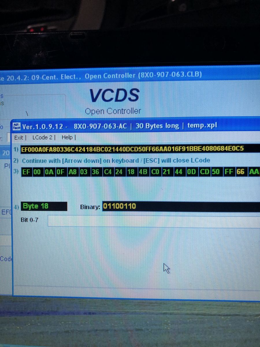

    Rate: 17
    I've already figured it out. The separation of foot and direction is done in the coding, so it doesn't require anything to be changed in the adaptations

    alvarokr
    Posts: 11
    Rate: 17
    The only thing I can help you with is to check with yourself what you have in the long encoding... channel 09 and byte 18 - in my case after the change it is 01100110.
    Save your own before editing and give it as in my case..if something didn't go right you can go back to what you had
    A computer screen with the VCDS program open, displaying controller coding on channel 09 with byte 18 highlighted and set to binary value 01100110. .

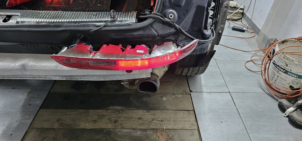

    szymon5s
    Posts: 29
    Hello everyone.
    I bought an Audi Q5 2016 from Canada, I changed the rear lamps, I swapped the pins in the upper ones (red and yellow), I did the coding according to the corrected one and everything works properly except the lower lamps.
    In the lower lamps, the turn signals are lit together with the parking lights. This means that when I turn on the parking lights, the parking lights and turn signals are on, and when I turn on the hazard warning lights or the turn signals with the parking lights turned off, the turn signals and parking lights flash. When I press stop, the same lights also come on, i.e. the parking lamp and the turn signal. Unless I'm confusing the parking light with the brake light. So I'm posting a photo of the lights shining
    Image of the rear part of a 2016 Audi Q5 showing a tail light issue.
    Can anyone tell me how to separate it?
    Let me tell you right away that I have checked the coding several times and there is no error
    The fog lamps in the lower lamps also work properly
    And one more thing. Shouldn't only the overhead lights be on when the hatch is closed? Because both the upper and lower ones are on, so maybe there is a problem with the flap closure sensor? It does not show any error on the display or in VCDS.
  • #28 20990369
    yarro13
    Is it necessary to change the red and yellow pins? I bought lamps from a car from the states, converted to EU, the pins were unchanged and they worked.
    My question is whether the pins are the reason - When the lights are on, the brake light on the flap lights up with the turn signal/When the lights are off, it blinks together with the turn signal.
    You will advise what and how
  • #29 20990962
    szymon5s
    Posts: 29
    If the lamps are US and modified, you do not need to replace the pins. If you buy EU, you need to replace them, at least in Depo lamps.
    As for your problem, it looks like bad coding. Did you code according to this corrected coding?
  • #30 20991997
    yarro13
    I have coding 2.
    All I had to do was get rid of the flashing lights in the bumper. The position may be lit, but it blinks with the direction.
