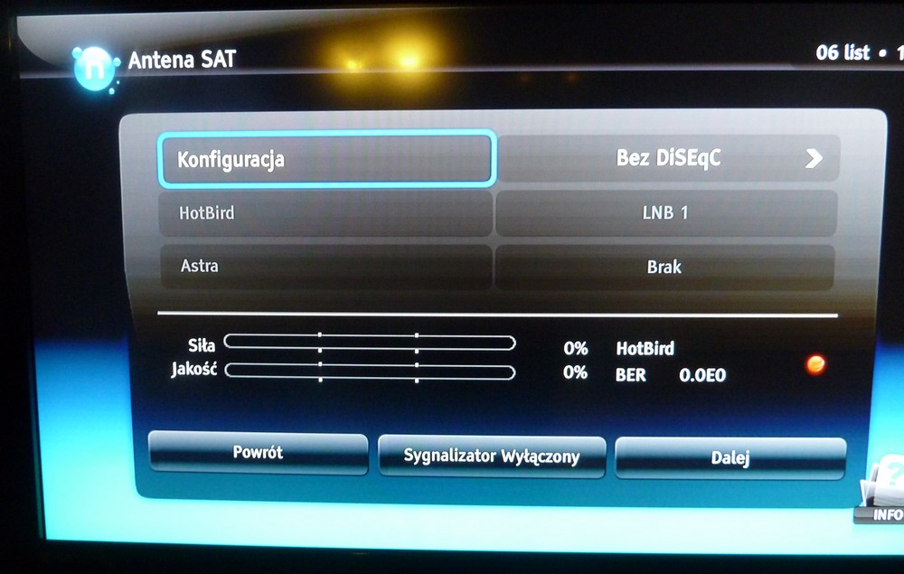

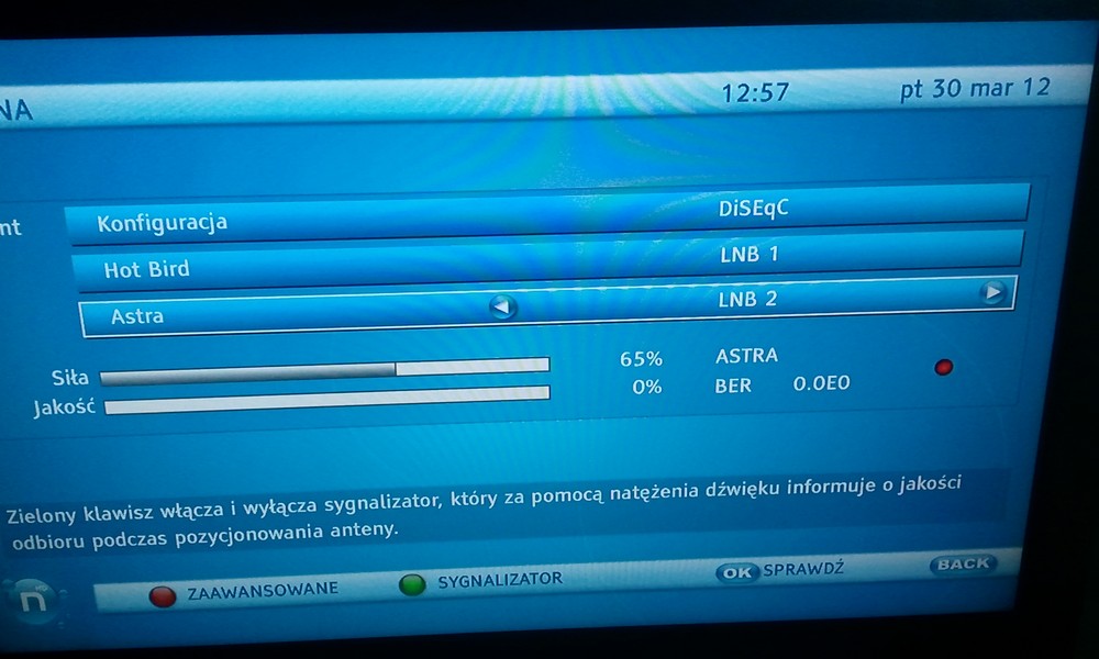

    I've already added such a topic, but because of the trees I had to mount the antenna somewhere else. The case looks as follows: I made a makeshift handle, unfortunately the handle has a small deviation (it has more than 90 degrees, has about 95). Is this deviation important? Perhaps this can be reduced by the elevation angle? Trying to set up the Cyfrowy Polsat antenna failed to set the quality, I will add that the "hand" (not screwed antenna) for a moment was quality. The decoder is operational, I was in the NC + salon there was a strength of 90% quality 100%. Interestingly, a small antenna nc + "grid" (with holes) managed to set the quality 40% more did not go. Even more interesting is the way of searching for a satellite, the decoder with a small monitor stands on the fireplace (the antenna is mounted on the fireplace holder). It is also worth mentioning that there is a tree in the radius of the antenna (attachment, yellow line is more of the center in which the antenna is directed).

    I would like to note that the topic does not have only one question. Is the handle important? In addition, I will not pay that I will screw the handle ...

    And you think that who's here, like you? Everything is to be vertical.

    What a telex colleague suggested could have been used in analogue tuners. With digital it is so that one should wait for the appearance of the image. So you can set the whole day and you will still be at the back ;-) Without a meter it will not work.

  • Use decoder beeper to align the antenna
    #14 16633964

    Install the SatFinderPro program on your smartphone, for example.
    With his help, you set up all the angles of the antenna and direct it in the right direction.
    With it's help I quickly set and signal strength 80% signal quality 70%.

    Setting the antenna alone was too difficult, 2 hours I tried and nothing. Finally, I called a professional.
