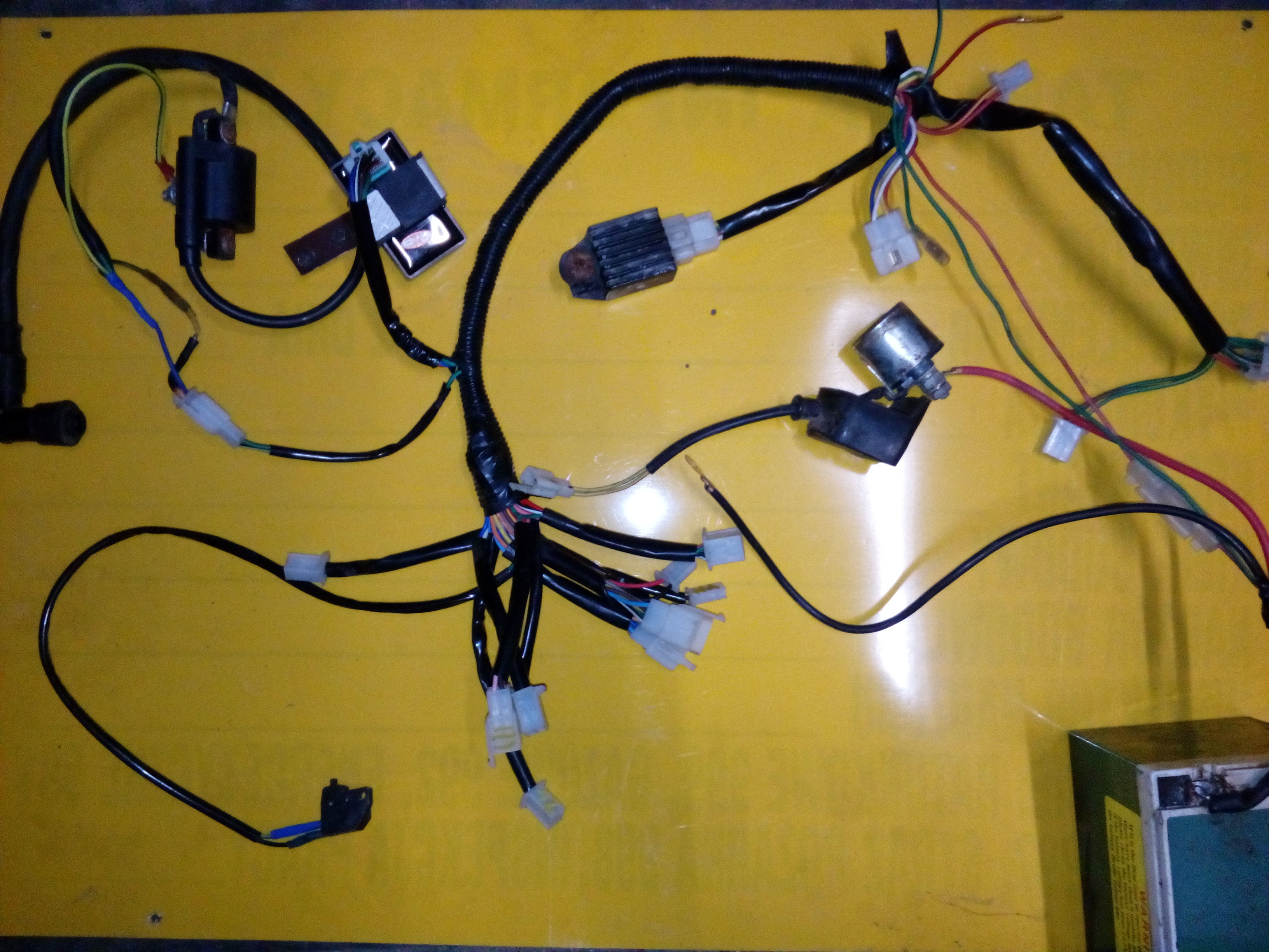

    I have a problem with the installation in a quad 107cm (110). A new electric beam was purchased because the old one was damaged.
    I connected the CDI cables (module), the HV coil wires and the wires from the coils next to the magnet.
    The success is that a spark appears on the coil and can be fired.
    Please help me connect the remaining wires. I mean connecting the ignition switch (the ignition can be switched on and off) and the option of using the starter. Colors and cubes do not coincide and I do not know how to do it. The beam is probably expanded (direction indicators, short lights, long alarms, etc.). I have only 1 lights at the front, one at the back + stop, no directions, In the pictures I have placed numbered markings of cubes and colors of wires. I hope that my colleagues will help me solve the problem.
    in case of something, I connect the cube according to the need. Regards and I am waiting for help :)

    Gentlemen, help me. I stand in a place and I do not know how to take it. Tell us where to start, how to try to solve the subject of ignition
    Red and black at the ignition switch when the ignition is on,
    on the off-ignition, black and white is the transition

    I am asking for a photo of all the cubes from the bundle and cubes from the accessories, no one will help you because I do not know what it is for the bundle you bought, usually look at the number of pins and layout in the cube and guess where it should go.

    I thank my friend for the fact that you were the only one who wanted to bend over my problem.
    Below I send photos with digital signs. In the first post there are descriptions of colors and the appearance of cubes. If you still have to take some pictures, please write them.
    Best wishes and thanks again

    Did you solve the problem? I have the same problem. How did you connect the coil cables at the magnet and CDI module? It doesn't start at all :( .

    I finally deposited it and it works. What you have what is missing may help.

    I want to connect a new installation and there is still no spark, so I checked the magnetos with a meter and they will not shake, so I rather need to order a new one, but thank you for wanting

    How many oh do you have on your coils?

    It showed me 0 I measured this black and blue cable to this sensor which is screwed there, I could have done something wrong
    Added after 3 [minutes]:
    It showed me 0 I measured this red-black cable to this sensor which is screwed there, I could have done something wrong
