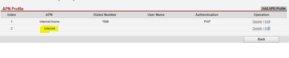

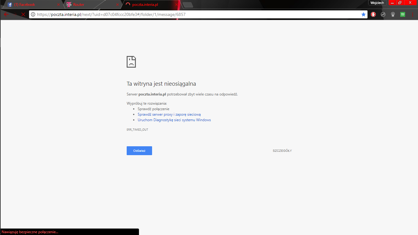

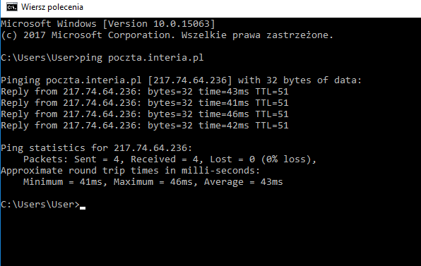

    Hello, how about the subject of mobile internet at Play? My problem is the following 4 days I don't have internet. So I have a modem huawei 593s-12 I have LTE range and yet I can not load any website. Only fb works completely normal and google but only searching results does not go to pages anymore. The situation is on 2 computers at home, and similarly on the phone, except that the images on the snap and uploads on Instagram also work correctly, but no other pages can be loaded.
    Oddly enough, I can ping all sites and the pings pass. I tried to reset the router calling the supplier and even today I was in the Play salon and I was replaced with a sim card. The problem persists, the grandmother at Play said that if replacing the card does not help, you need to buy a new modem. However, I want to make sure I can't do anything else to fix it.
    I tried on dns addresses 8.8.8.8 and 8.8.4.4 and on automatic obtaining I attach 3 screenshots

  • #2 16630212

    And what subscription is on the card? What does the use of transfer look like in the current billing period?

    What would I try - check the router status - if it's possible - are you sure you're catching LTE coverage. Check if you get the answer to the command "ping -f -l 1100". Transfer the card to a smartphone for a moment and see if the internet works.

    Yes, I know that even unlimited net has limits to 100GB, probably, but because after that the speed should slow down and not blow off the net completely, I rejected this one because fb was loading quickly. I did as you said, threw the card into the phone I came a little so that it caught the range of 3.3.5 and 4g along the way it happened to me that the phone several times emitted a message that no SIM card but it was fine after the restart. I thought that maybe some dust had accumulated in the router's SIM slot, I blew it, I inserted this new card several times into the SIM slot to make such small abrasions and works. I write this only so that someone in a similar situation would know what helped me. Thank you for your commitment to the subject, you can close

    I did it but it did nothing but the dormitory is already working so thank you for the advice given
