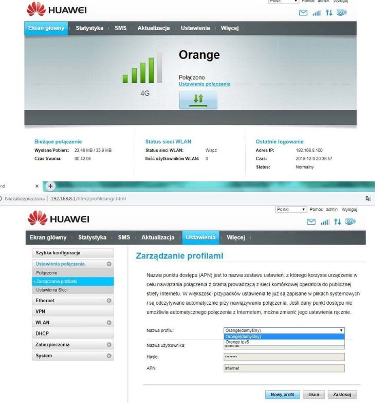

  • #6 19270474
    kamilasta
    Level 4  
    I have this manual. I even managed to connect the router to the computer :) I will be happy to enter the data provided by Kocurek, but I do not know in which tab
    Switching Internet Card Operator from Plus to Play on Huawei B525s-23a Router
    Profile management tab for entering carrier settings
    #7 19270511
    jimasek
    Posts: 35287
    Help: 3783
    Rate: 2681
    kamilasta wrote:
    I have this manual. I even managed to connect the router to the computer. I'd love to enter the data provided by Kocurek, but I don't know in which tab
    You're not quite "blonde" :)
    Connection settings -> Profile management and there in a given profile named, for example, play, you enter the data provided by a friend @KOCUREK1970
    It should be something like this, except it's Orange

    #8 19270569
    KOCUREK1970
    Posts: 35667
    Help: 3861
    Rate: 5489
    kamilasta wrote:
    I will gladly enter the given data
    Sometimes, you need to additionally "mark" a newly created profile as default/default.
