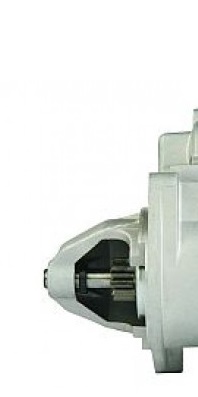

    Knocked out sleeve in the box:
    Sample photo.
    Alternatives to Replacing Golf III 1.6 75PS Starter Bushing Housing?
    Practically the box housing to be replaced.

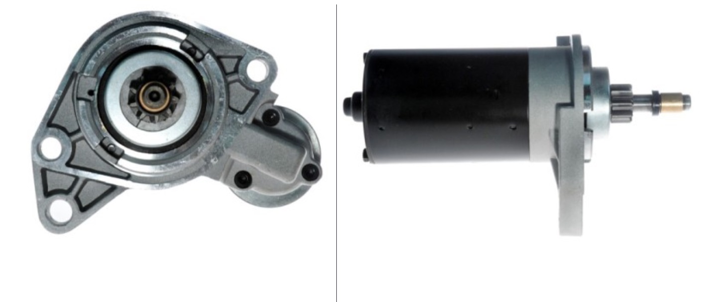

    The starter is as follows:

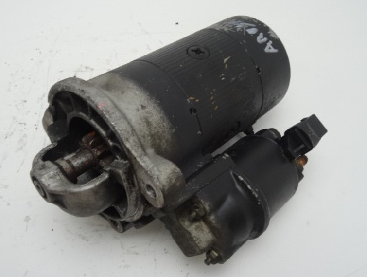

    Once I got some replacement with a closed starter head:
    Sample photo.
    Is there any replacement not to replace the housing ??

    You do not replace the housing, only the sleeve. Even on a car it can be done

    There are models of the starter with support on the bendix. You'll find something.

    You pick out the remnants of the old one with a narrow, sharp screwdriver, paste in a new one and it's ready.

    If you have an egg in aluminum, paste the sleeve on the poxipol and screw it on immediately. After half an hour, you can fire up. Before gluing, degrease the hole in the box and coat the starter shaft with oil.

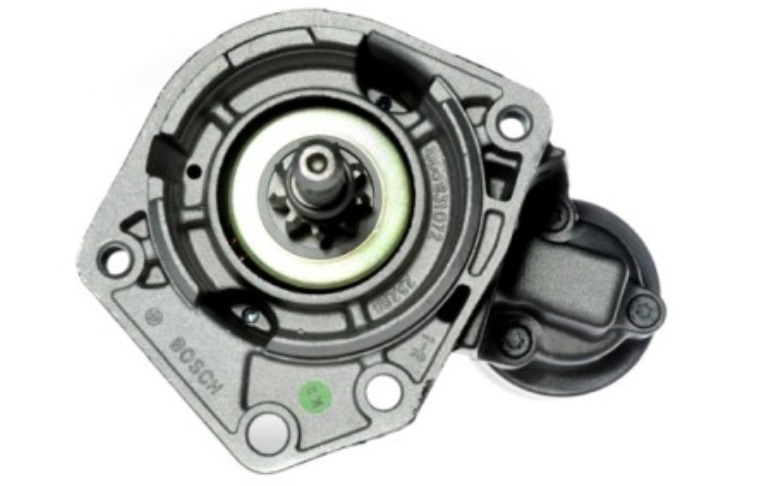

    It turned out that I have such a starter from AEE with a supported axle. Unfortunately, I have misled you a bit. I have a starter on the back of the engine. And it looks like this:
    Must be on M8 bolts. Unfortunately, the one on the front does not fit ...
    Added after 10 [minutes]:
    Thanks so much for the hints. The case was cleared up. I need such a contraption:
    Only MAGNETI MARELLI 63223039 made such starters.
