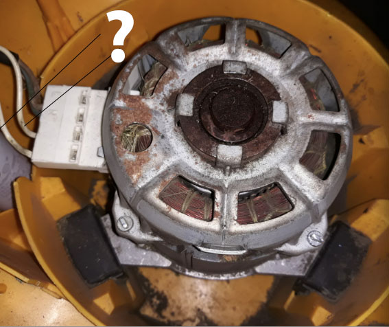

    I would like to remove the engine from the Stiga e331 electric mower but I don't know how much because the engine is mounted in some rubber and I don't know how to go about it. And I need to get it out to unscrew it and replace the bearing. Thanks for the hints.

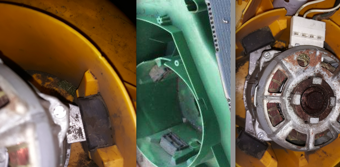

    From the photo, the housing of an identical model of the mower, it appears that the engine sits only in the rubber:
    Removing Stiga e331 Electric Mower Engine: Tips for Rubber Mounts & Bearing Replacement , ... look carefully at the geometry of fixing feet in rubbers, .. and rubbers in the housing: Removing Stiga e331 Electric Mower Engine: Tips for Rubber Mounts & Bearing Replacement
    Removing Stiga e331 Electric Mower Engine: Tips for Rubber Mounts & Bearing Replacement ... From this photo it follows that the rubbers themselves are not solid, but they have a more flexible structure, because the chamber, ... and the side edges are not parallel to the axis of the engine, ... and this is a vertical blockage, when removing the engine from the housing.
    Take a look, because you can see how to pry to deform, move the rubber, and the engine will "pop out"

    And all of these rubbers can not be removed?

    In my opinion it is he who is pressed into this "plastic" body, together with these rubbers / shock absorbers. And the same should be taken out, or "pull out" along with these rubber inserts. Before disassembly, for lighter removal these are the places (red arrows):
    Soaked / smeared with e.g. dishwashing liquid e.g. Ludwik might be easier to remove.

    I don't even want to move. Sitting firmly.

    I used WD40. I tried to knock on the wood with a hammer from below and it didn't work either.

    No WD-40 for rubber it may be a bit ... :| that he would not dissolve them, that these gums would not "swell" from this center. I suggested some dishwashing liquid because these rubbers got a good "slip" in the housing and it was easier to pull them out. Similarly, how to lubricate sewer pipes when folding / pressing into the flares one into the other, then it is easier to install after lubrication and the gaskets in the flares will not be damaged, and easier / lighter assembly, and the rubber seal will not suffer either.

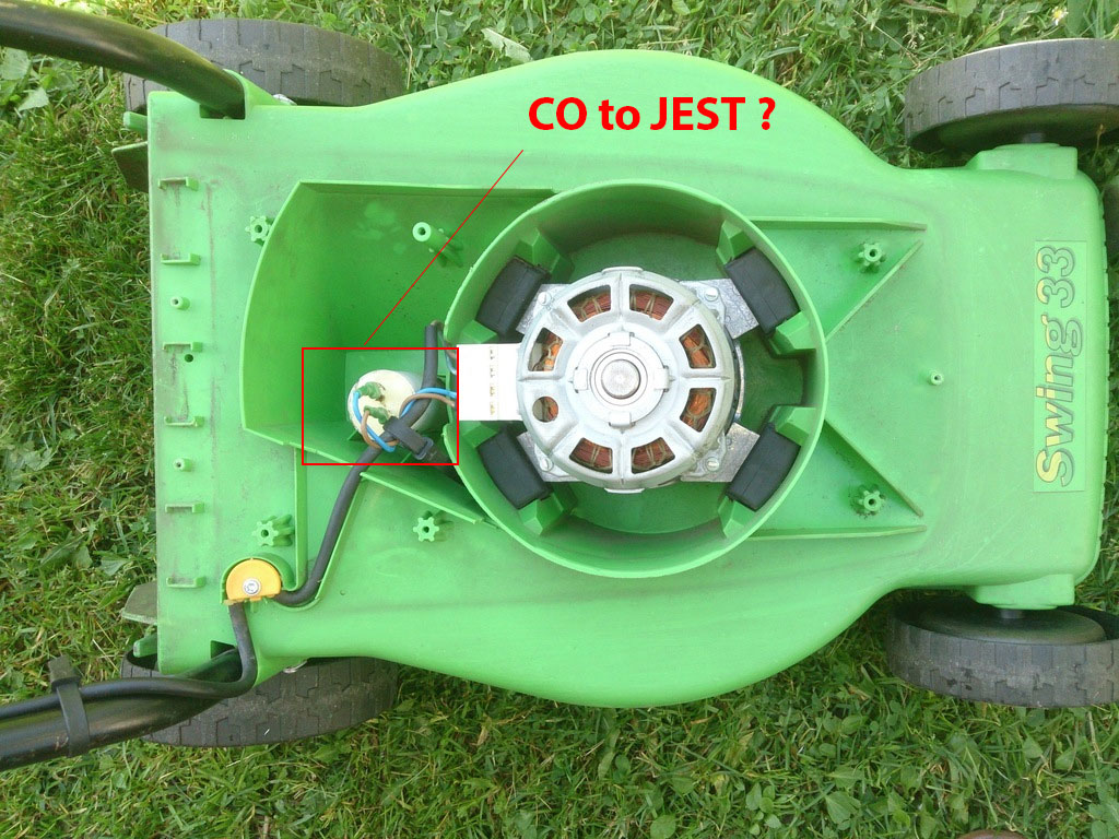

    Hello and welcome. I'll get on the topic. I got such a mower in the fall and I don't even know if it works but the two protein circuits are not connected to anything - they are loose - my question is where to connect them?

    Capacitor. Purchase possible in a good electrical store, read the values \u200b\u200bof the old one.

    The problem, because I don't have the old one and I don't have parameters, instructions. Maybe someone has one and can tell me what it should be like.

    You choose the capacitor according to the motor power.
