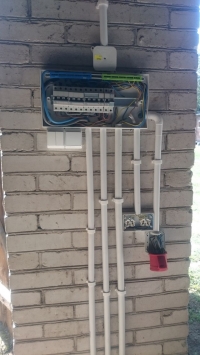

    I have a question for you because I need lamps for a large workshop.
    Height is 8 m, width is 14 m, and the length is about 35 m. Beams on which lamps are supposed to have a gap of 7 m and I want some 3 LED lamps on these beams, strong. The garage has no windows, etc. ... it's dark. Will someone flash what lamps would do the job?

    I do not know if I understood the outline of the room well, but with such dimensions and proposed location, for LEDs it will be quite ... dark.
    More expensive solutions will not be returned.

    Fluorescent lamp can not be there, because it is too high, and I would put it in the last resort on the sides
    It will be a workshop, but so far you can say the shed like the floor after pouring out, everything will be covered with sheet metal so it will be dark.
    Photos
    Best High-Power LED Lamps for Large Garage Workshop: 8m Height, 14m Width, 35m Length, 7m Beams Best High-Power LED Lamps for Large Garage Workshop: 8m Height, 14m Width, 35m Length, 7m Beams Best High-Power LED Lamps for Large Garage Workshop: 8m Height, 14m Width, 35m Length, 7m Beams
    I was also thinking about the 3rd one in the middle and two on the sides. 3 50w led lamps would give advice? On one rafter?
    The entire installation of the new footbridge, so as to make it meet the standards.
    I do not understand what can not be done? What point?
    This requires at least 300 lux of general lighting and possibly additional work lighting.
    Developers wrote:
    3 50w led lamps would give advice? on one rafter?
    If you do not want to have eyes, that's enough.

    Developers wrote:
    The entire installation of the new footbridge, so that as something to meet the standards
    By the way, I think that (apart from lighting) the rest of the installation does not meet the standard.
