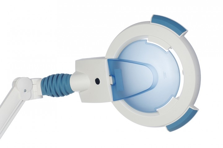

    As for the LUPA lenses themselves, apart from the aforementioned 3D, 5D and 8D variants, you can add round, oval and almost square shapes, plus those having an additional small glass with higher magnification plus anti-reflective coating. I am irritated in each of these lamps, this idiotic flap, maybe someone smart will come up with the fact that the flap can be unfastened or possibly moved in a plane and not open vertically, and it would be quite an interesting solution to iris diaphragm something like in photo cameras.
    When it comes to the arm, in fact, if we have a tight desk, it is worth taking a lamp with a stand, but if we have a sufficiently wide supply on the sides, i.e. when we spread our hands wide, the lamp should be mounted at this distance if it is fully unfolded with 1m length. The half-fold arm extends 50-70 cm beyond the edge of the desk.
    An example found on the web.
    Source
    What workshop lamp with a magnifying glass? A request for tips and what you reco

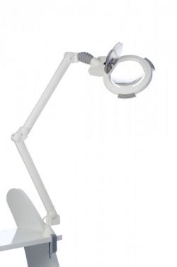

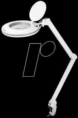

    When looking for this particular model, it probably is Circus magnifier lamp companies Glamox Luxo . The price deters the fact but it looks nice, except that there is no brightness adjustment, 22W must give a lot of light.
