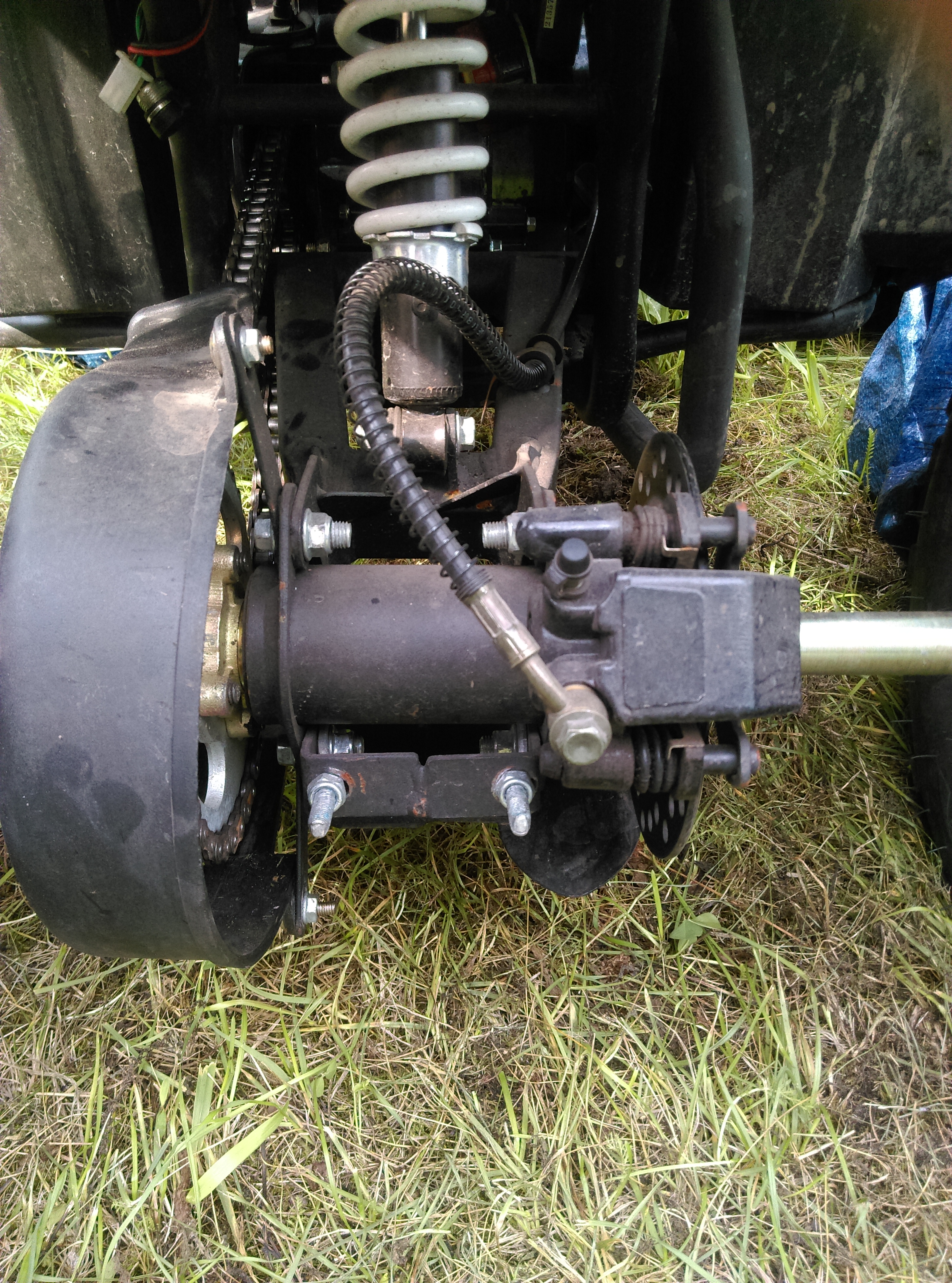

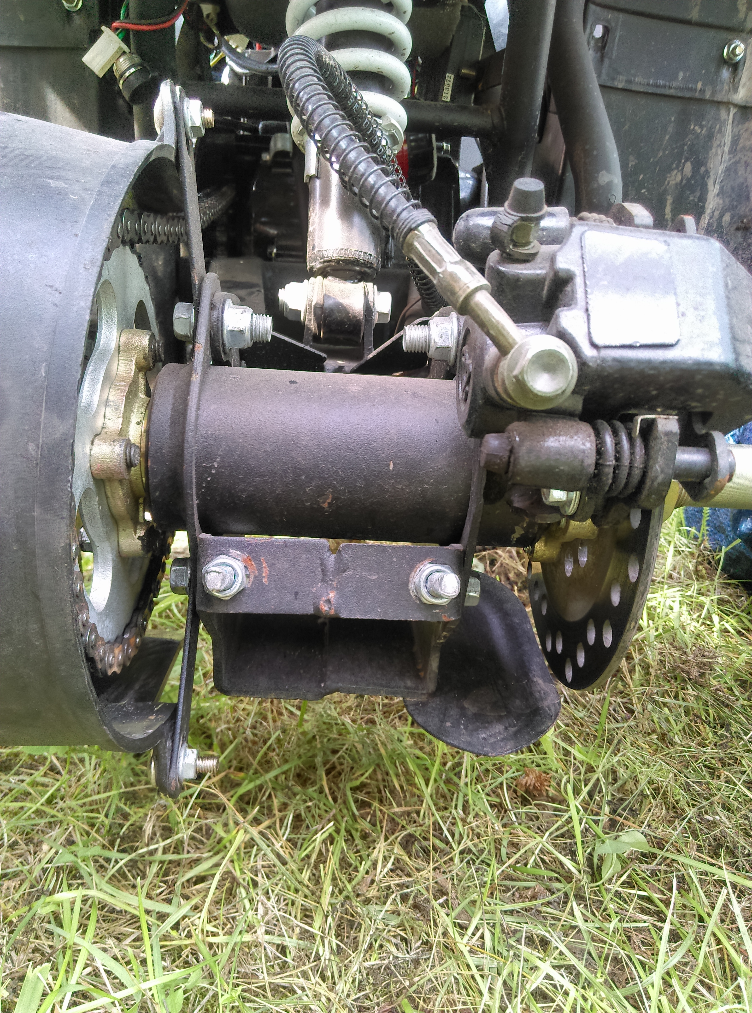

    Welcome. . I need help. Please write how I should stretch the chain in a quad. I've seen this thread here but it's closed in my case it looks a bit different. I put some pics. Quad KDX 125cc - How to Stretch/Adjust Chain: Step-by-Step Guide with Pictures Quad KDX 125cc - How to Stretch/Adjust Chain: Step-by-Step Guide with Pictures Quad KDX 125cc - How to Stretch/Adjust Chain: Step-by-Step Guide with Pictures

    You release these 4 screws on the sides and screw in those 2 which have a long thread and are pointing backwards. Only you need to screw them in the same amount of turns.

    #4 16637908

    I'm just pretty screw up, don't unscrew these on the side, just loosen them and pull the 2 on the back, turn it clockwise and count the number of turns so that it is the same on the left as on the right, because if you set it wrong, it will be a bone and the chain may fall stretched in moderation it can't be very stretched either.

    Except that these 2 long bastards are forever to the end.

    What does this word mean? They are screwed to the end because the chain is tensioned and either needs to be shortened or replaced with a new one.

    they were threaded to the end. Btw. Some Chinese chain because it has no cufflinks on it.

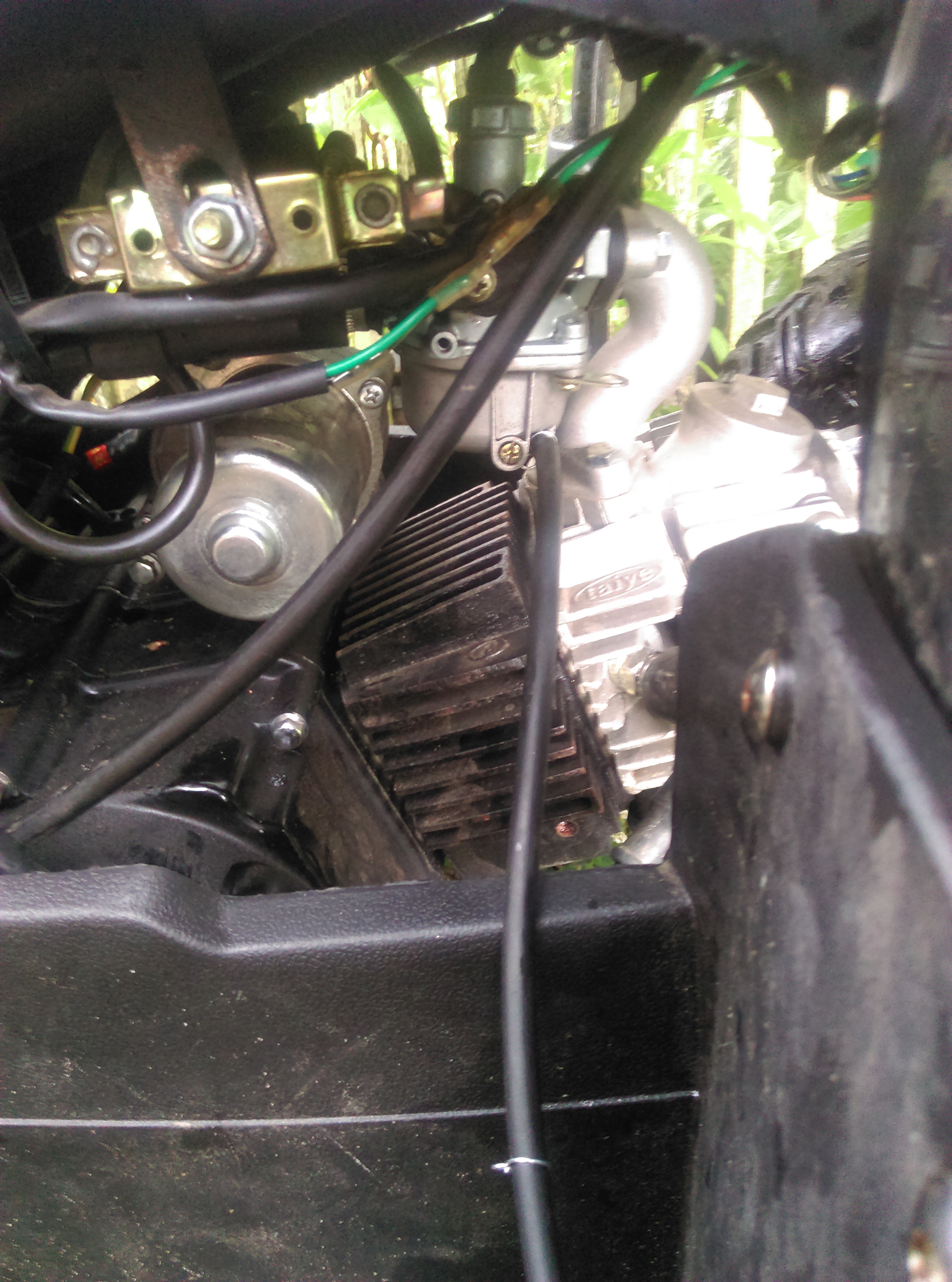

    One more question is where this cable should be connected. Fuel is coming out of it Quad KDX 125cc - How to Stretch/Adjust Chain: Step-by-Step Guide with Pictures

    Nowhere is the hose for draining the fuel from the carburetor chamber, when the fuel is going on, you probably have a float valve suspended or some kind of pollution causes the valve not to close. The hose hangs under the engine so that the fuel does not run over the engine

    Thanks for the quick reply. The reason for the leaking fuel was a muck in the gas tank. After cleaning the gaznik the problem disappeared.
