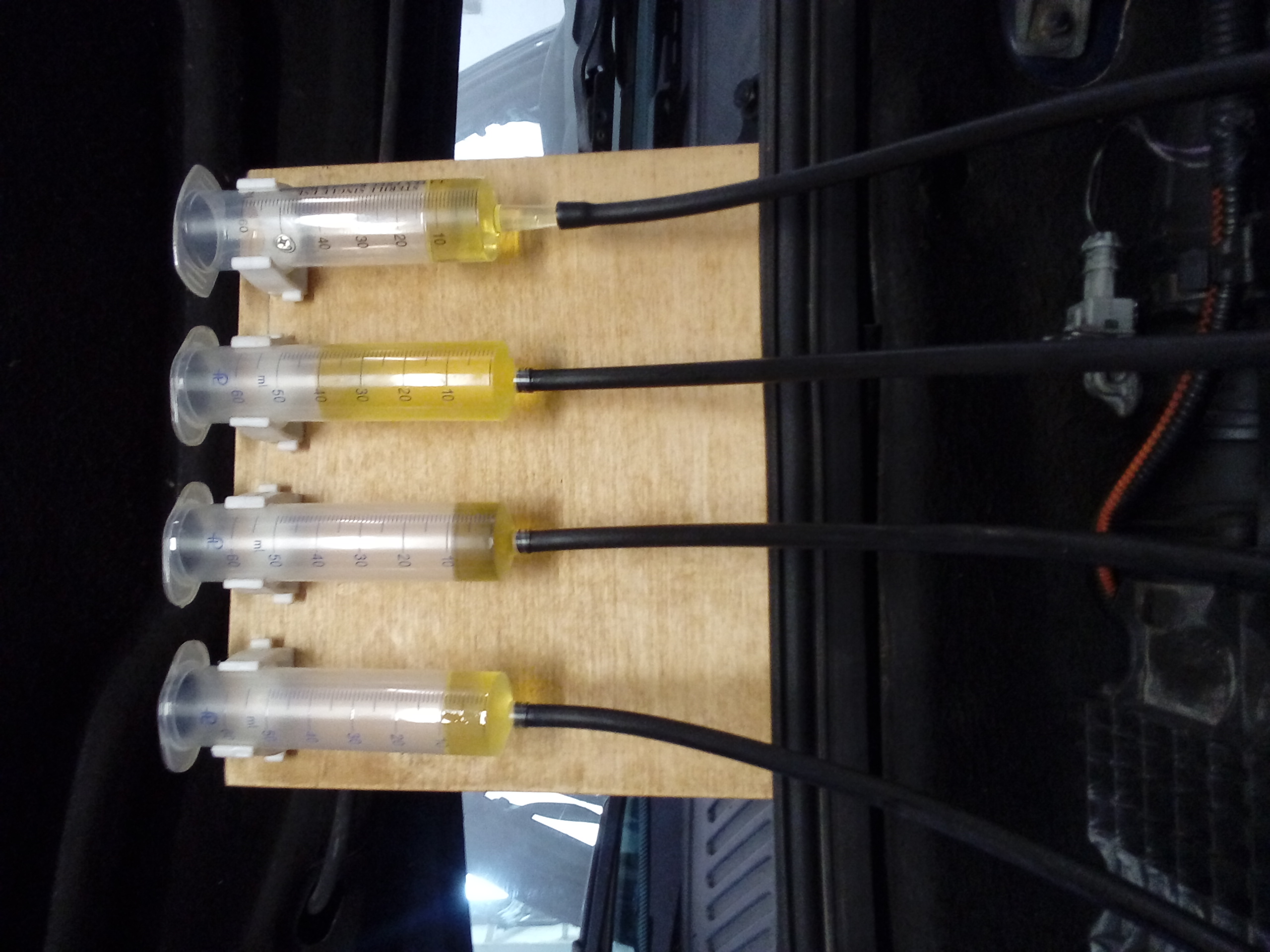

    I have to replace one injection, but I can't buy one that suits me because .....
    I have the number EJBR02101Z and I can have the number EJBR03101D. DELPHI.
    Will it work after coding?
    Or maybe there is a list that has equivalents, replacements.
    I am asking for help. Important thing.

    No, you don't need to replace the injector, take them all out and have them checked. Buying second hand is a lottery, they will be even worse than they are today.

    Typical thinking in Poland. In order for the car to be operational, it is worth dismantling the injectors and having them checked. For sure everyone will be regenerated, not just one piece. There is no point in buying used injectors, they have no value and need to be remanufactured anyway. As for profitability, no one told you to buy a diesel car, you had to buy gasoline. As if the turbo has fallen now, I understand that you will also give the car to scrap?

    I have already given one damaged one for checking and PLN 50 for checking and PLN 600 for regeneration. And the best thing is that the one I gave to check was the guy after checking that he was good, and he does not work at all and does not even speak on the diagnostic test. the rest yes. Yes, the guests check for PLN 50.

    It is the damaged one, it is so pouring. Test about 1.5 minutes, No. 2, and we count from the clutch.
