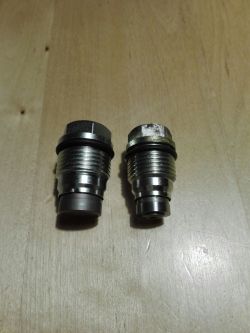

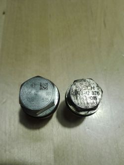

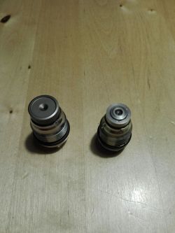

    #9 17068566
    Mietek.Maliniak
    Good morning,
    I have a problem with my Voyager 2.8 CRD from 2005 Classic symptoms for the fallen valve regulating the pressure in the rail - at low air temperature it stops starting. When it's warm (above +5) - there is no problem.
    I ordered a new valve based on VIN, moreover, the search for this model gives exactly the same catalog number 1110010015 or 1110010018, I started to exchange.
    And the problem - the valve unscrewed from the rail is smaller than ordered.
    Replacing CR Slat Pressure Valve in Chrysler Voyager 2.8 CRD: Procedure & Precautions Replacing CR Slat Pressure Valve in Chrysler Voyager 2.8 CRD: Procedure & Precautions Replacing CR Slat Pressure Valve in Chrysler Voyager 2.8 CRD: Procedure & Precautions
    On the left the valve ordered, on the right - unscrewed.
    Car serviced by the previous owner at an ASO. I have a printout of service activities - the rail has not been changed.
    Wanted on the network (maybe there were other versions of the rail mounted in these cars?) Give no results.
    Anyway, I have not encountered any Bosch valve that would resemble my twisted one (smaller thread, smaller diameter and other piston shape). The markings on the valve itself do not say much - there are no Google results.
    Do you have any idea how to identify the model (catalog number) of such a valve?
    You can approach the smallest resistance line and replace the whole rail, but for financial reasons such an idea falls away.

    I exchanged such a 2.8 crd 2005 eu valve and it was so bigger. As you can see there are various markings on them. But before I bought from Lithuania through Ebay I checked the mark on the old one. There are two different factory settings and you may be able to return or exchange for the smaller one
