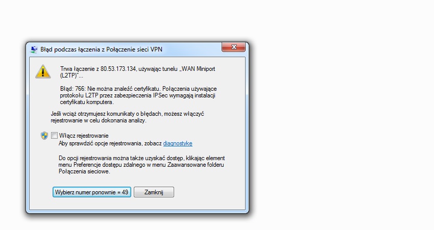

    Network and Sharing Center> Set up a new connection or network
    connect to work> Use my internet connection (VPN)
    Internet address (computer address at work) enters the IP address I received from the administrator, check "Don't connect now, just configure it so that I can connect later
    gives the username and password (I got it from the administrator)
    and click create
    In the properties, the security tab, I select the virtual network type: L2TP
    and later link and crashes error as pictured

    did you enter the PSK key?
    no ? type it, go to how to do it.

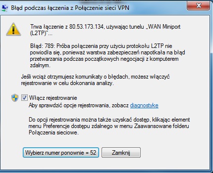

    it probably fits in the advanced settings and: use the pre-shared key for authentication, after typing there (although in the instructions I got from the administrator it would not be entered), an error 789 appears as in the photo.

    Briefly disable the system firewall.
    Maybe your home router is blocking something. Which model?

    In the manual it says just to choose l2tp, I chose others and it also doesn't connect and crashes errors.
    I turned off the firewall and the same thing.
    I have a huwawei b315s router with play
    Added after 7 [minutes]:
    I turned off the node, turned off the firewall on the router and in the firewall system and I have error 789.

    Sometimes the router is the cause. Generally, it should have the "VPN Passthrough" function, and with this hardware I don't know how it is. Some say it is, others say it is not. Sometimes it's not in the configuration, but it works. Here is an example. Different bug and different hardware, but who knows:
