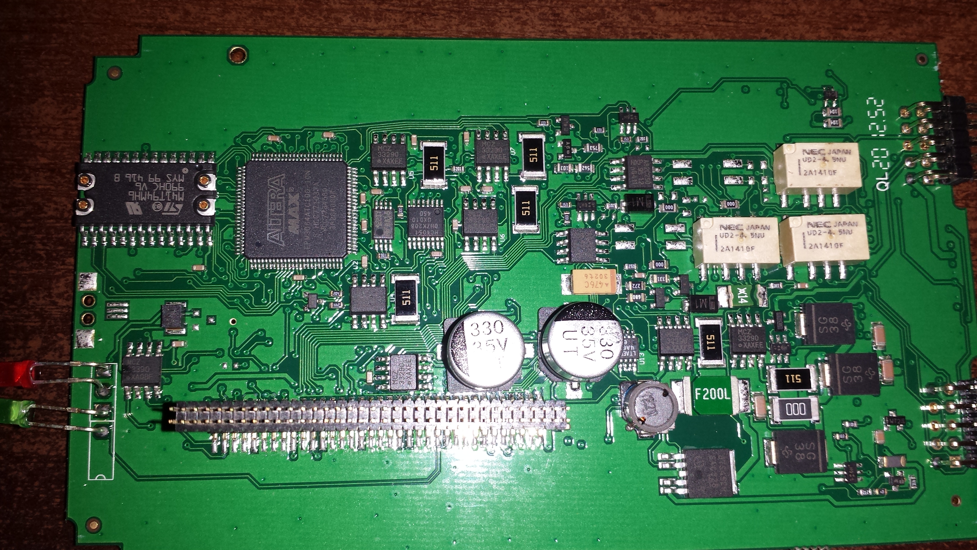

    I have the above probe problem. Everything works, the problem is with stability - it disconnects and reconnects. Of course it is a clone, I have had it for several years and there were no other problems. For my basic needs - I have enough for private purposes. The same as breaking the connection is clicking on the probe. I suspect it's one of the relays. Today I started the device and I am adding photos. Maybe someone has dealt with a similar problem and will suggest something? I am thinking of replacing 4.5V white signal relays but would rather consult ..
    Can Clip - "peripheral device has been disconnected"20170818_1..640.jpg (3.17 MB)You must be logged in to download this attachment.

    And my colleague, I advise you to replace the usb cable, Often it causes such things. Give a sign if it's okay.

    Apart from your suggestions regarding the cable, I also got information from VIBOR - a user of the RLKP forum. He wrote that he was helped by the exchange of "quartz". As I was able to buy the resonators immediately and had to order a good cable, I replaced the first ones first. I can tell the probe is not physically disconnecting. Previously, it "clicked" and two lamps went out, then they turned on again. Now nothing clicks and the lights are on all the time, but sometimes you can see from the software that the signal is lost. As soon as I pick up the cable, I will start testing and write if the problem has completely disappeared after replacing the USB.
    Thank you very much for your interest in the subject and any answers.

    You can buy the cable in any store - it is the same as for a printer. Cost about PLN 10.

    That's right, but I want to eliminate the possibility of a bad cable altogether, so I ordered a double shielded one with ferrite and a copper core. I will write if the cable completely solved the problem.

    The fact that the irony was unnecessary, but you're actually exaggerating. A simple printer cable would be enough because the Clip probes attached to the clones are lousy quality.

    I did not speak for a long time, because I wanted to test the probe on several cars and be sure of what I write. Well, after replacing the quartz and cable, the probe actually works longer without losing the connection, but unfortunately it breaks anyway. Recently, it has basically been completely gone - the CAN LEDs have gone out. After undressing and folding it came back to life. Here's a question for you, can this be a symptom of a damaged USB port?

    Can you write or show in the picture what quartz you exchanged? Some symbol? I have a similar problem.

    If you have the cheapest clip, it will be like that. Take a picture of the clip board. In order for there to be no problems, it must be the gold version.
