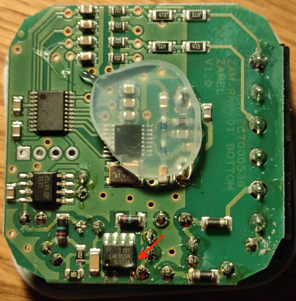

    Below is a picture of the board - everything looks ok, except for the LNK302DN chip (such a voltage converter), which seems slightly smeared at the DRAIN leg:
    Close-up of an electronic board with the marked LNK302DN component, which appears slightly scorched. Image of the electronic board of the ZAMEL RNP-01 transmitter with a scorched LNK302DN component.
    Subsequent questions - is it worth messing around with replacing the LNK302DN? Anyone encountered such problems with ZAMEL transmitters?
    I can order a new one, but I'm afraid a differential will pop up again at some point and I'll have to play with pulling it out of the box again :/

    Burnout at the input. The circuit works on a voltage contact. If nothing else has gone then replace. The advice with the power supply as correct as possible. And you may have a faulty RCD. It is dropping zero before phase.

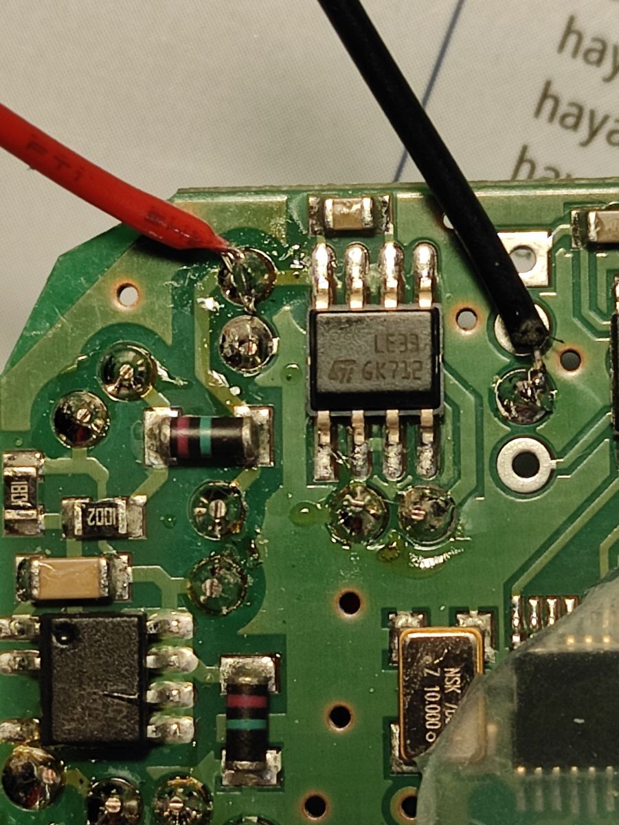

    I don't quite catch which is the main circuit - but I plugged in with about 8V under the LDO (LE33) for input, and then by shorting on the Opto contacts I was able to control the lamp (the status LED flashed and the receiver received the command). Pictures for posterity, maybe it will make it easier for someone:
    Close-up of a circuit board with electronic components, including an LDO LE33 regulator. Image of a PCB with markings and electronic components.
    So I conclude, that you could try to replace the LNK already a little less on the stick? The diodes on the input look ok (checked with a 30 zeta meter, one conducts the other not).

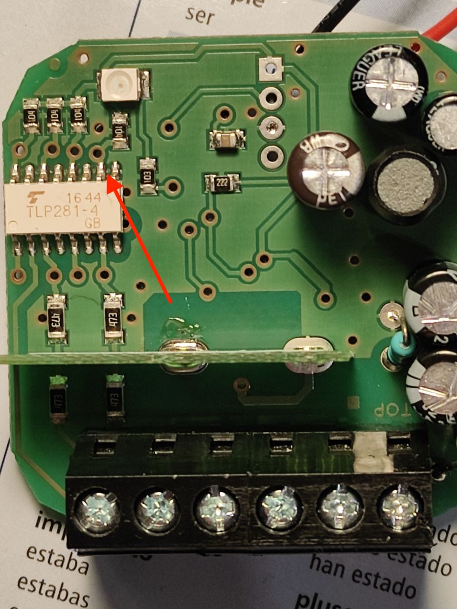

    If by "on contact" you mean that on the click of a switch then no - it is powered all the time, and passing a phase to these switch ones causes a signal to be transmitted (that's what this opto is for).

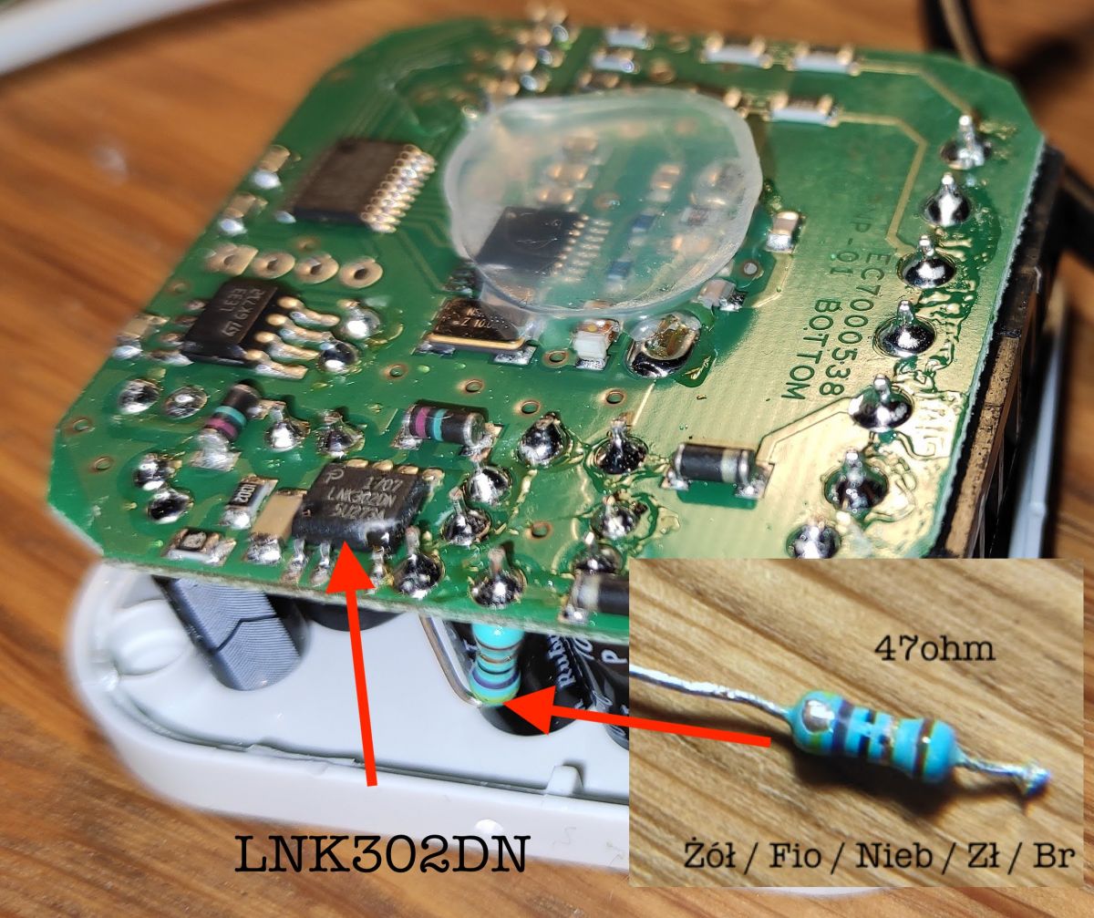

    To sum up, I fixed it and it works. I replaced the LNK302DN and the 47ohm resistor (it had no external signs of damage, but it was burned out - not conducting at all). The total cost of the repair was LNK for about 4PLN at a local shop + resistor + some fun soldering = worth it :)
    Electronic circuit board with LNK302DN chipset and 47 Ohm resistor. .
