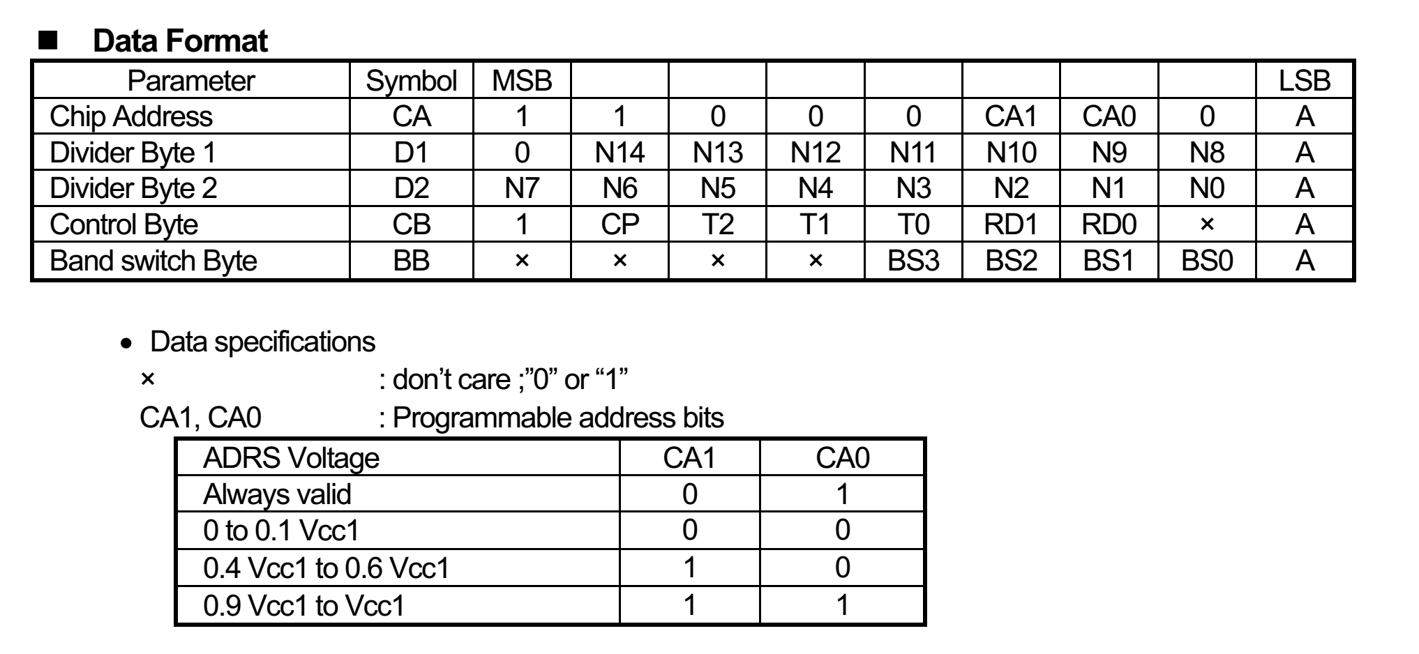

    Hello all.
    I need to run PLJ NJW1504 synthesizer. The problem is that to run it,
    it must be initiated via the i2c bus it has. Pdf has nine pages and I have studied it. I tried to run it in the bascomie sending a datasheet bits to the chip - I think so ... well, I can not do it here.
    Could someone help me start this synthesizer wiser than me?
    I would like to take a look at PDF.
    • NJW1504_E.pdf (111.25 KB) You must be logged in to download this attachment.

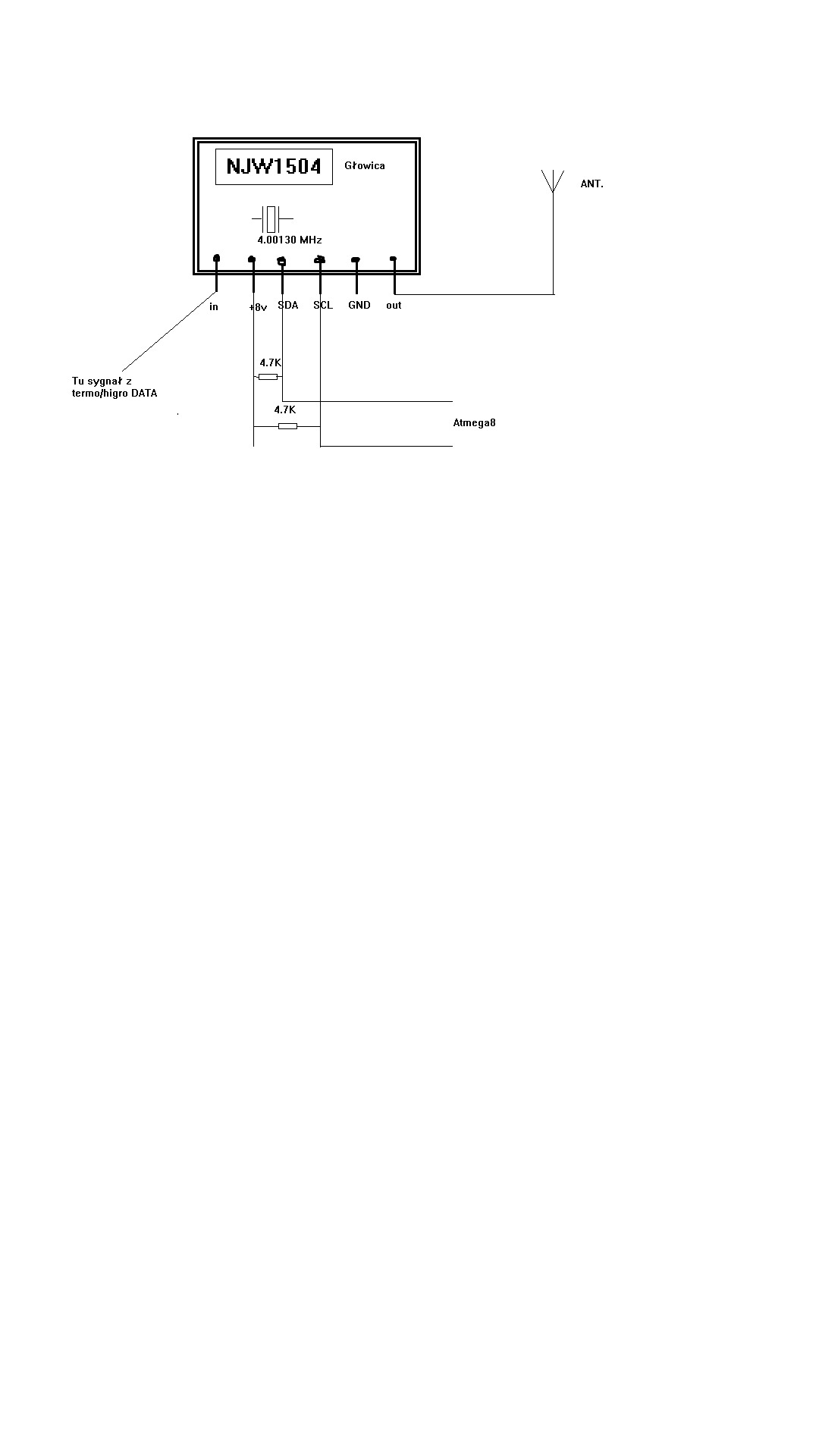

    The schematic is here I think I do not need. SCL and SDA lines are well connected as well as power supply. I would have to draw in ... paincie :oops:

    Well, crap. I set the range in the scanner from zero to 250 and showed me 192 and 194. I thought it works like PCF8583 or DS1307 watches. Now I'm completely stupid.
    There is only one layout, NJW1504.

    First of all, the address is:
    192 - Write and
    193 Read,
    or
    194 Write and
    195 Read. And not like you R-192 and W-194
    In addition, the frame should look something like this:
    Code: C / C++
    Of course, you have to convert it to BASCOM.

    BS - it depends on what you have attached to these outputs. If nothing, it does not matter what you send. As for the rest, it is also rather bad. You do not want to share the schema, so it's hard to determine. I will shoot:
    My assumptions:
    - 4MHz quartz
    - the signal without an additional divider enters the system
    - we want to get 868MHz on VCO
    it comes out:
    868000000 / 8/13888 = 7812.5 = 4000000/512
    div- 13888 or:
    div_h = 54
    div_l = 64
    ctrl = 198
    bs = 0

    Schemat w paincie.

    I was more concerned with the schematic of this head. As I understand it, you do not have one. However, it is necessary for the correct setting of parameters. Try with the values I gave you. Alternatively, change the value of the div a little by +/- a dozen or so points.

    R-MIK write which addresses exactly because the scanner does not detect anything else. Besides, even the datasheet shows that it is 192, 194.
  • #25 16652353
    excray
    Posts: 5502
    Help: 739
    Rate: 657
    Forgive me, fix. This system does not work in Read mode. Hence the situation. You can only send data to it.
