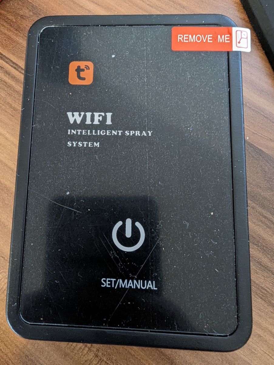

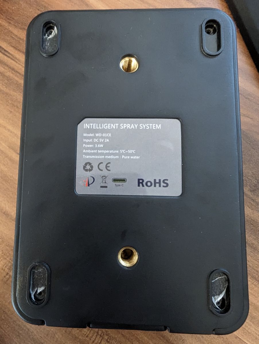

    I bought the Intelligent Spray System WD-01CE (which also goes by some different names).
    It's used to spray water, therefore contains a pump, a button with an LED, and a piezo module.
    [BK7231N/CBU] Intelligent Spray System WD-01CE Pump how to flash, getting bus failed
    It's pretty easy to unscrew after removing the 4 pads over the screws.

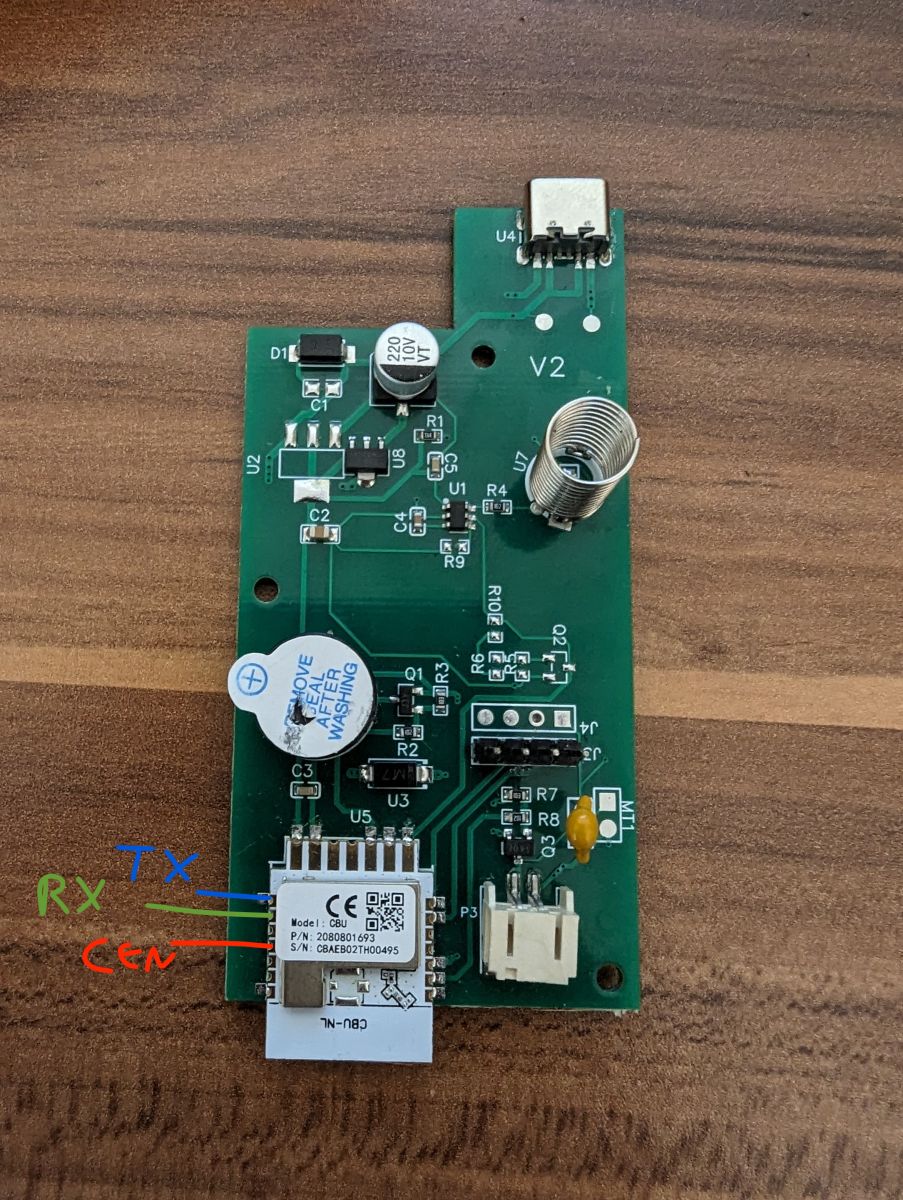

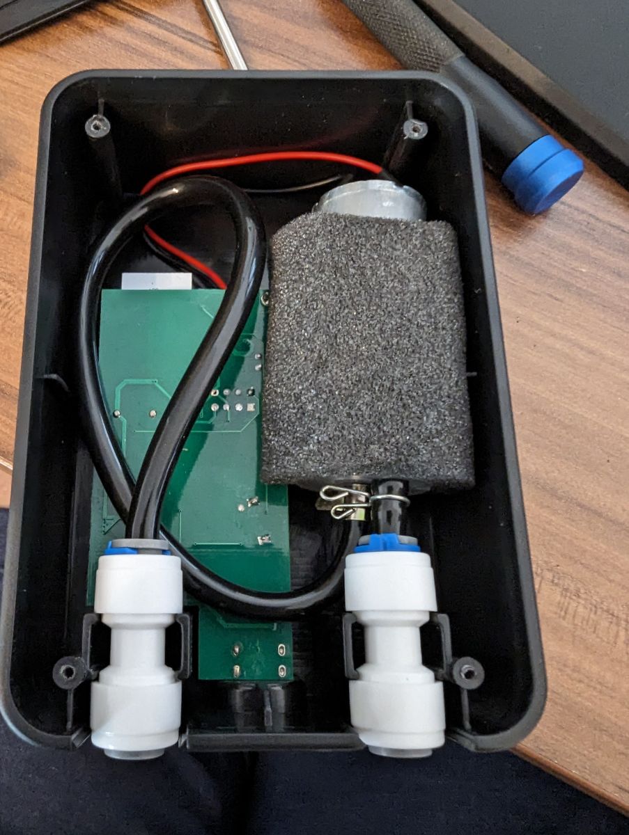

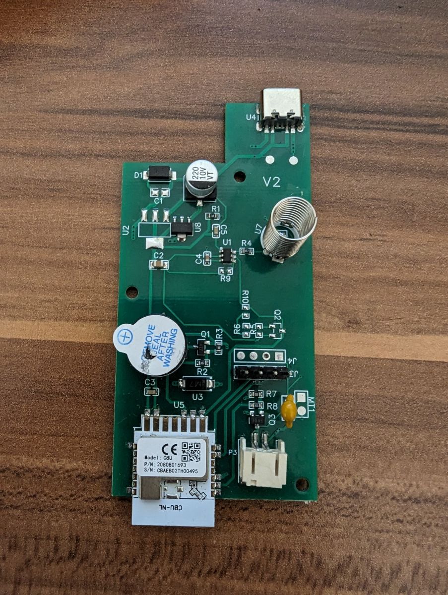

    After unscrewing, you can see the pump and the board.
    To remove the board, 3 screws need to be unscrewed.
    According to my research on https://developer.tuya.com/en/docs/iot/CBU-NL-module-datasheet?id=Kbaeq6j53y0yg, it uses the BK7231N chip the pins are the following:
    The pinout for setup is:
    P6 - Buzzer
    P8 (PWM2) - Btn
    P16 - REL
    P20 - LED_n

    First of all, please check if there is anything else connected on UART lines. Are they used for something else than flashing, maybe for a button, or for a relay, or something like this?
    Is this your first Beken chip you are flashing? Have you made sure to provide enough current for your device? Have you tried swapping RX and TX? Are you flashing it in BK7231N mode? BK7231T mode will not work for N.
  • Programming pins on the opposite side of the Tuya board
    #3 20624666
    kilianeller12
    Yeah, it's my first time flashing.
    I solved it. On the Tuya sheet, they showed it from the bottom, so I used RX01 and TX01, which are for logging. On the other side, there are the RX and TX pins for programming (hard to solder).
    The only thing I am now missing is, what would you set for P6 as it is a buzzer? In the dropdown menu, I didn't find something like it. Currently, I have set it as LED.

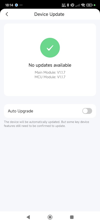

    Added after 4 [minutes]:

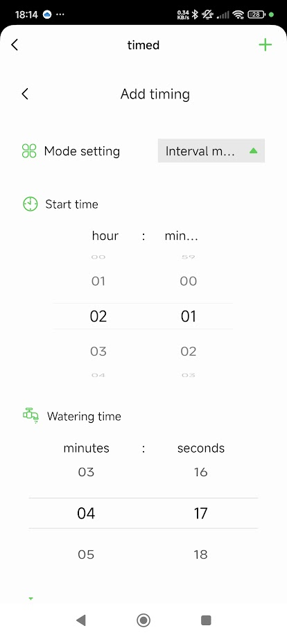

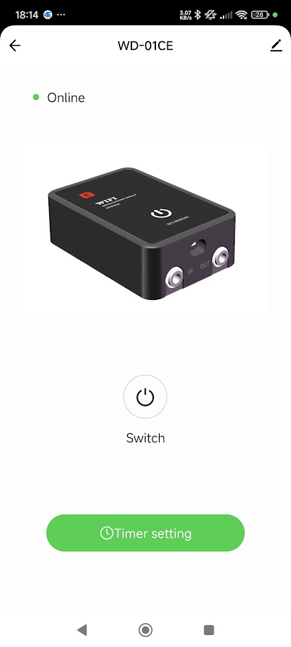

    how it presents in Tuya app
    View of the Tuya app with the WD-01CE device online Tuya app screen with time and watering settings. Device update screen showing no updates available.
    fw v1.1.7 is on the Cloudcutter known patched list
