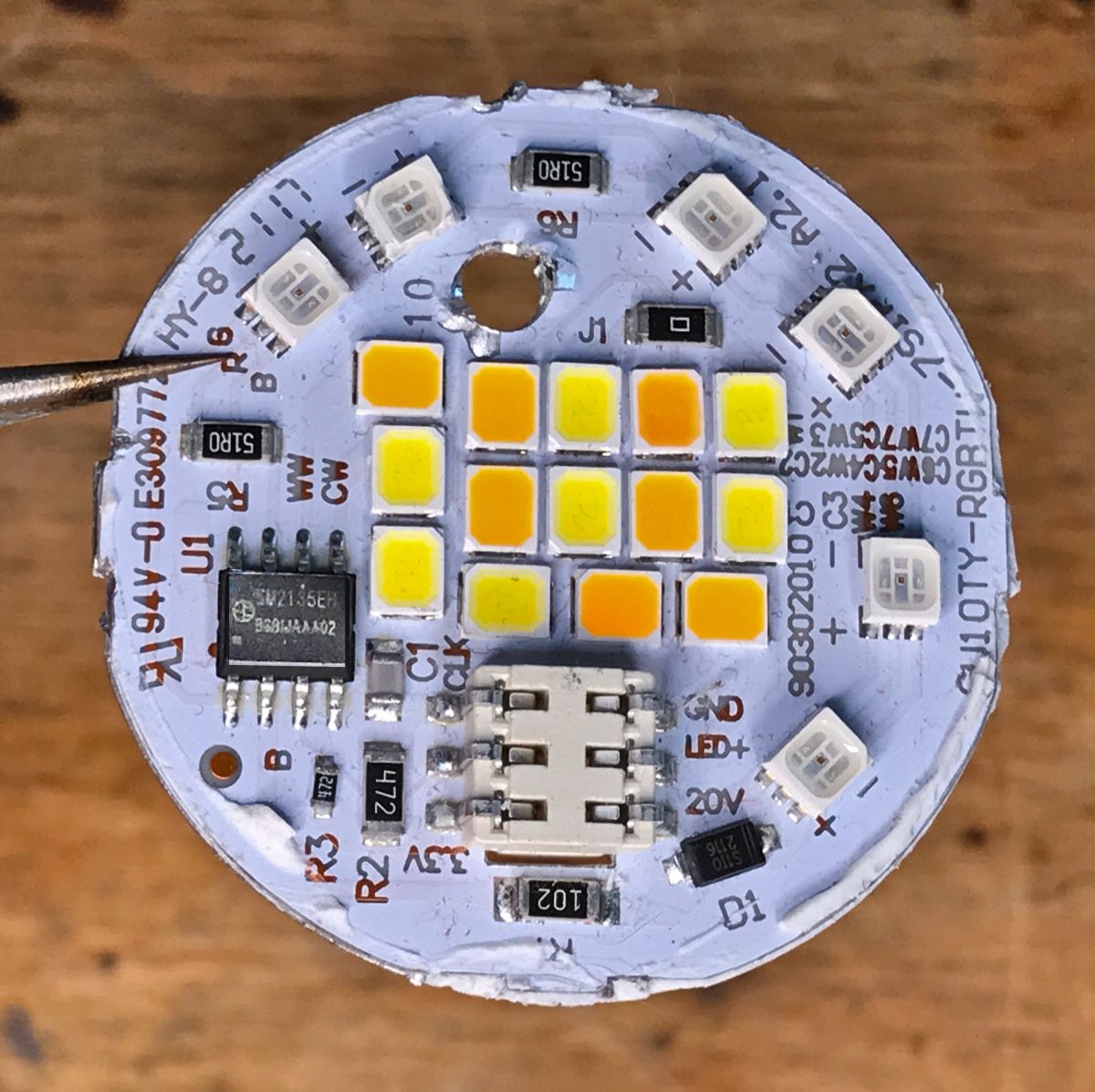

    I struggled a bit with the removal of the LED PCB. It was hard. Eventually I made a small hole on the other side and pushed it out.
    WiFi LED RGBCW WOJ14415 with SM2135 - I2C communication protocol, interior WiFi LED RGBCW WOJ14415 with SM2135 - I2C communication protocol, interior
    The board pins are marked. You can see here, among others, CLK, which is the clock from I2C. The unsigned pin next to it is probably DATA, I2C data line. In addition, among others it is 3.3V (LED controller power supply), 20V (LED power supply?), ground...
    The LEDs are separate warm, cold and colorful (RGB).

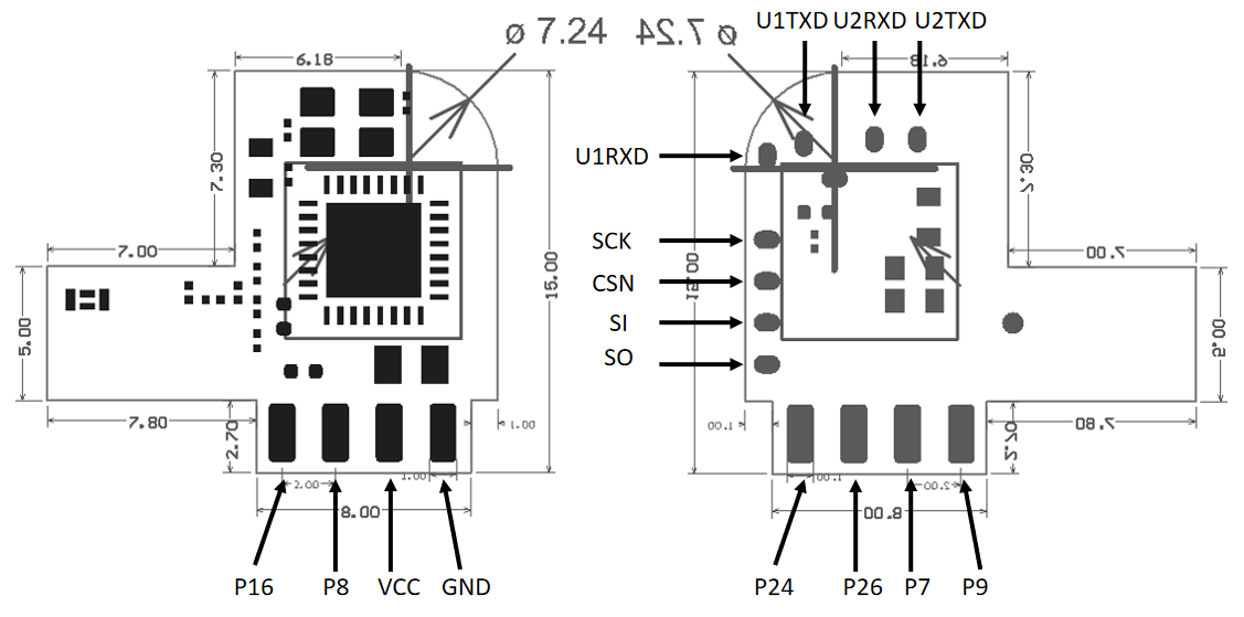

    What's under the sticker? Module with BK7231T:
    WBLC5. Dimensions:
    Base pinout:
    Unfortunately, the programming pins are not described. Fortunately, I have completed the graphics for you:
    You will need to solder wires to at least TX1 and RX1.

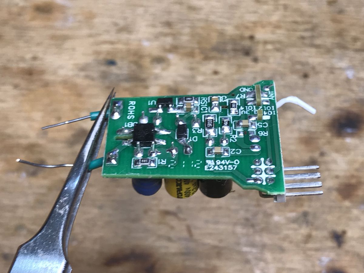

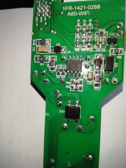

    Rest of the circuit is very usual. Fusible resistor, bridge rectifier, some other elements in SMD, most likely realized to step down power supply that converts mains to 5V or 3V or a similiar voltage (anyone can recognize the markings?):
    WiFi LED RGBCW WOJ14415 with SM2135 - I2C communication protocol, interior WiFi LED RGBCW WOJ14415 with SM2135 - I2C communication protocol, interior WiFi LED RGBCW WOJ14415 with SM2135 - I2C communication protocol, interior
    I have not analyzed the PCB with power supply more deeply, it's time to focus on the SM2135.
    Five-channel I2C LED SM2135 controller
    The SM2135 controller is used to operate RGBCW lamps, i.e. it supports 5 separate channels. It is controlled via the I2C lines, two signals: DAT and CLK, are sufficient to control 5 channels. In addition, it also requires power. 5 channels + 2 lines + power supply already gives us 8 pins, so the clever manufacturer gave the ground pad on the bottom of the chip:

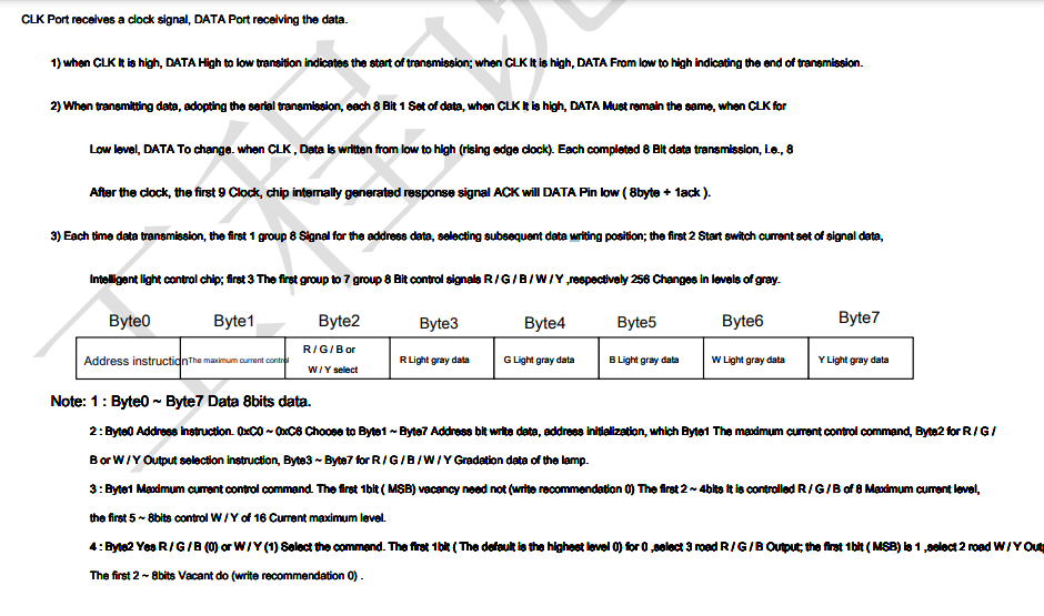

    I2C Communication Diagram:
    Here is its description from the datasheet, it should be mostly correct, except the "8byte + 1ack", it should be 8 bits and one ack. Ack signal is generated every 8 bits.
    The start of the transmission is indicated by the DATA transition from high to low when CLK is high.
    The end of the transmission is indicated by the DATA transition from low to high when CLK is high.
    When sending data, the DAT state should change when the clock is low.
    After 9 clock cycles, the system generates the ACK by itself, i.e. it sets the DATA pin to the low state.
    Data is sent by specifying a byte of the register address and subsequent bytes of the content (you can specify several of them).
    When it comes to registers, we have:
    - current limit (1 byte) - address 0xC0
    - RGB or CW mode (1 byte) - address 0xC1
    - color data (5 bytes, RGBCW) - address 0xC2 etc.

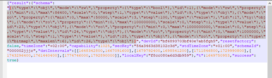

    Quick test with the Tuya application
    The Tuya application has been discussed many times, so I won't comment it here much.
    I entered the pairing mode by repowering the lamp five times. Bluetooth had to be enabled on the phone. Pairing required my WiFi data to connect the lamp to the internet. Pairing went smoothly.

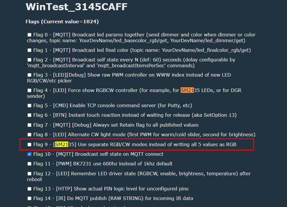

    In OpenBeken WWW panel, after doing the standard configuration, select the SM2135 I2C pins:
    That's basically it. From now on, you can control the lamp from Home Assistant:
    Code: YAML
    (the YAML configuration does not differ from the RGBCW lamp configuration based on five PWM channels on the BK7231T)
    You can also control it from the OpenBeken level, but it still requires selecting one flag in Options-> General, because without PWM pins, the system itself will not detect that it is RGBCW:

    [{"type": "obj", "mode": "rw", "property": {"type": "bool"}, "id": 1}, {"mode": "rw", "property ": {" min ": 0," max ": 86400," scale ": 0," step ": 1," type ":" value "}," id ": 9," type ":" obj "} , {"mode": "ro", "property": {"min": 0, "max": 50000, "scale": 3, "step": 100, "type": "value"}, "id ": 17," you: "obj"}, {"mode": "ro", "property": {"min": 0, "max": 100,000,000, "scale": 0, "step": 1, "type": "value"}, "id": 23, "type": "obj"}, {"mode": "ro", "property": {"min": 0, "max": 1,000,000,000, "scale": 0, "step": 1, "type": "value"}, "id": 24, "type": "obj"}, {"mode": "ro", "property": { "min": 0, "max": 1000000, "scale": 0, "step": 1, "type": "value"}, "id": 25, "type": "obj"}, {" mode ":" ro "," property ": {" type ":" bitmap "," maxlen ": 6}," id ": 26," type ":" obj "}]
    11. Generate profile, open payload_builder.py, add here:

    14. Result
    "chip": "BK7231T",
    "payload": "eyJhdXprZXkiOiJBVVRIS0VZQUFBQUFBQUFBIiwidXVpZCI6IlVVSURBQUFBQUFBQSIsInBza0tleSI6IiIsInByb2RfdGVzdCI6ZmFsc2UsImFwX3NzaWQiOiJBIiwic3NpZCI6IkEiLCJ0b2tlbiI6IkFBQUFBQUFBQUFBQUFBQUFBQUFBQUFBQUFBQUFBQUFBQUFBQUFBQUFBQUFBQUFBQUFBQUFBQUFBQUFBQUFBQUFBQUFBQUFBQUjqCSJ9",
    "authkey_template": "AUTHKEYAAAAAAAAA",
    "uuid_template": "UUIDAAAAAAAA",
    "datagram_padding": "QkJCQkEgCQBBIAkAQSAJAEEgCQBBIAkAQSAJAEEgCQBBIAkAQSAJAA =="

  • SM2123 driver outputs mains phase on ESP8266 pins
    #13 20109119
    chemik_16
    Posts: 1001
    Help: 75
    Rate: 128
    oo thanks for the topic, I was just wondering why the modules dismantled from DGM bulbs give me a phase at the outputs of the esp8266.
    The LED driver is based on the SM2123, and the phase actually goes to it.
    The power supply itself looks separated from the mains, the transformer has 2 pairs of taps.
    I have already burned one by connecting GPIO4 and 5 to the modbus input of the inverter. The differential went, esp8266, max485 and the? L700?
    I have a phase on each of the esp8266 and VCC outputs, the neon lamp lights up.
    WiFi LED RGBCW WOJ14415 with SM2135 - I2C communication protocol, interior WiFi LED RGBCW WOJ14415 with SM2135 - I2C communication protocol, interior WiFi LED RGBCW WOJ14415 with SM2135 - I2C communication protocol, interior WiFi LED RGBCW WOJ14415 with SM2135 - I2C communication protocol, interior WiFi LED RGBCW WOJ14415 with SM2135 - I2C communication protocol, interior

  • New SM2135_Current command for RGB/CW current settings
    #20 20246171
    Posts: 14781
    Rate: 12920
    Hello @skrc1 , the current version is using the default SM2135_20MA, but I understand that you might want to change it.
    I have added a new command for you - SM2135_Current RGBcurrent CWcurrent. For use as a 'short startup command', you can put there multiple commands with backlog, eg. backlog SM2135_Current 0x02 0x02; SM2135_Map 1 2 3 4 0,
    Also enable flag - [SM2135] Use separate RGB/CW modes instead of writing all 5 values as RGB
    I didn't test it myself - please update to 1.14.37 and test and tell me if it works for you.
    https://github.com/openshwprojects/OpenBK7231T_App/releases/tag/1.14.37
    Take care, I haven't been able to test it myself yet.
    Here are current values:
    Please check and tell me if you need anything else. I provide daily support for my firmware and can implement the features you need.

    #29 20315739
    Posts: 14781
    Rate: 12920
    @s1dave don't worry about temporary posts, they get approved soon. I haven't seen the thread yet, but I will say this: some of the devices are using different pins for communication with SM2135 so you might need to make sure you have chosen correct ones. In case of WBLC9, you have available following signals:
    Pin No.SymbolI/O typeFunction
    1P9I/OHardware PWM pin, which is connected to the P9
    2P16I/OCommon I/O pin, which is connected to the P16
    3P7I/OHardware PWM pin, which is connected to the P7
    4P8I/OHardware PWM pin, which is connected to the P8
    5P26I/OHardware PWM pin, which is connected to the P26
    6VCCPPower supply pin (3.3 V)
    7P24I/OHardware PWM pin, which is connected to the P24
    8GNDPGround pin
    Are you sure that exactly P24 and P26 are used, and not some other pins?
