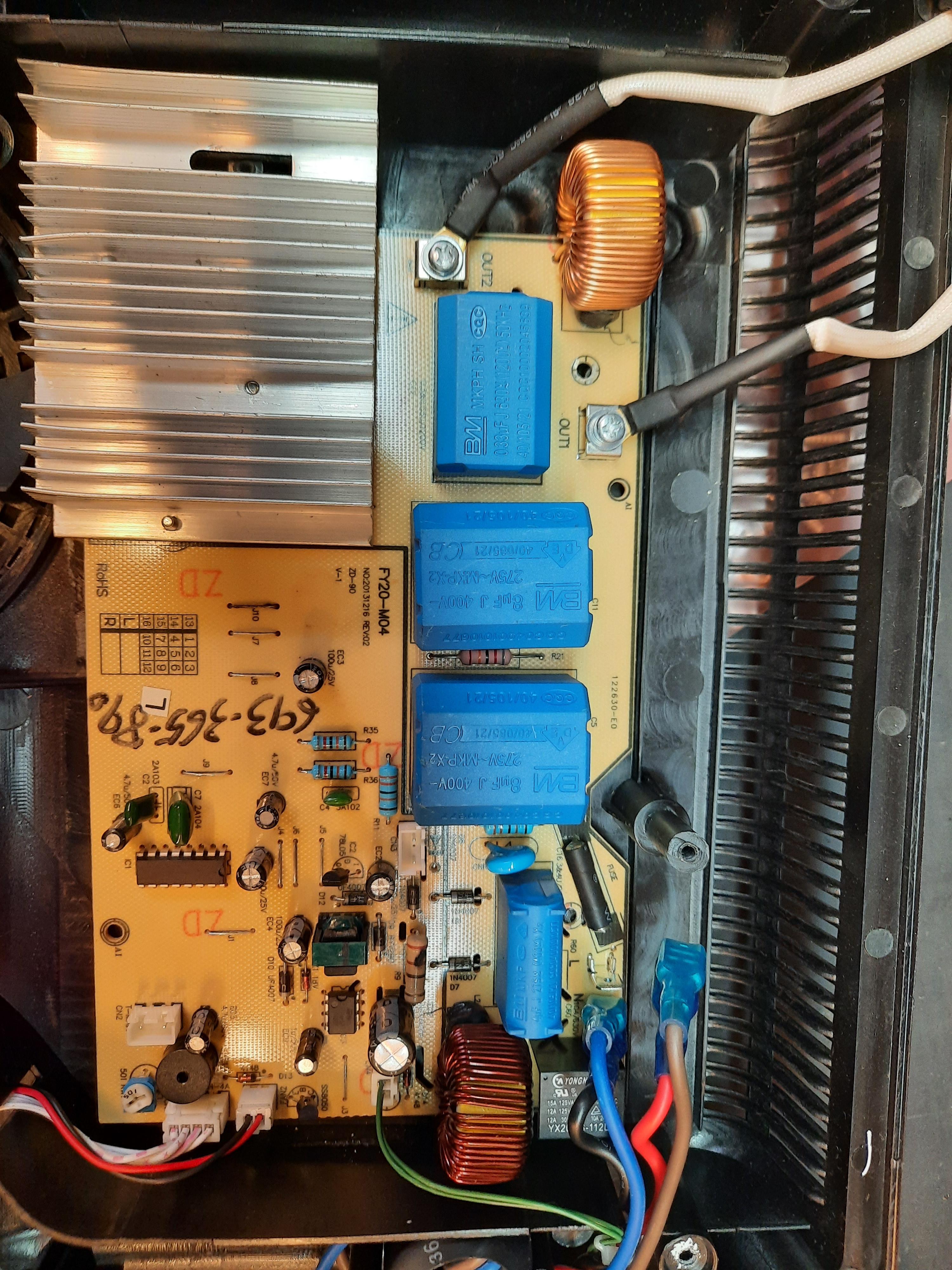

    Hello, I received the Quigg IK 4000.13 induction hob
    The symptom was that after connecting to the network it did not start, after reviewing the board, I came to a damaged 22? resistor. After replacing the resistor, the board started, but when I turn on the heating, the display shows the temperature and the error E0.
    I am asking for help, where to look for the reason.
    greetings

  • #6 19894824
    kciuq
    Posts: 278
    Help: 10
    Rate: 8
    I have a similar situation, error after a while E0, good thermistor, but the second element is like a Zener diode has no value at all.
    Does anyone know what this element is, possibly what to replace ?. Thanks.

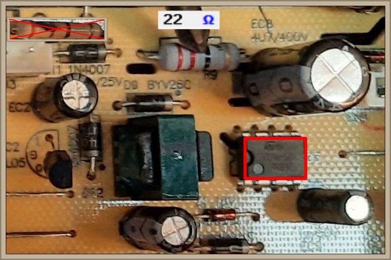

    I also had a 22 R / 1W resistor burned after the replacement, the stove started but only for a moment and the resistor burned again, maybe someone knows what are the typical burning faults of this resistor, the diode bridge is functional, and the power stage transistor as well.
  • #9 19990065
    TONI_2003
    Moderator
    Posts: 15334
    Help: 2195
    Rate: 3826
    Adam Pluta wrote:
    maybe someone knows what are the typical faults of this resistor burning
    It is probably a resistor in the converter. Give a photo, I will write or show what to check :idea:

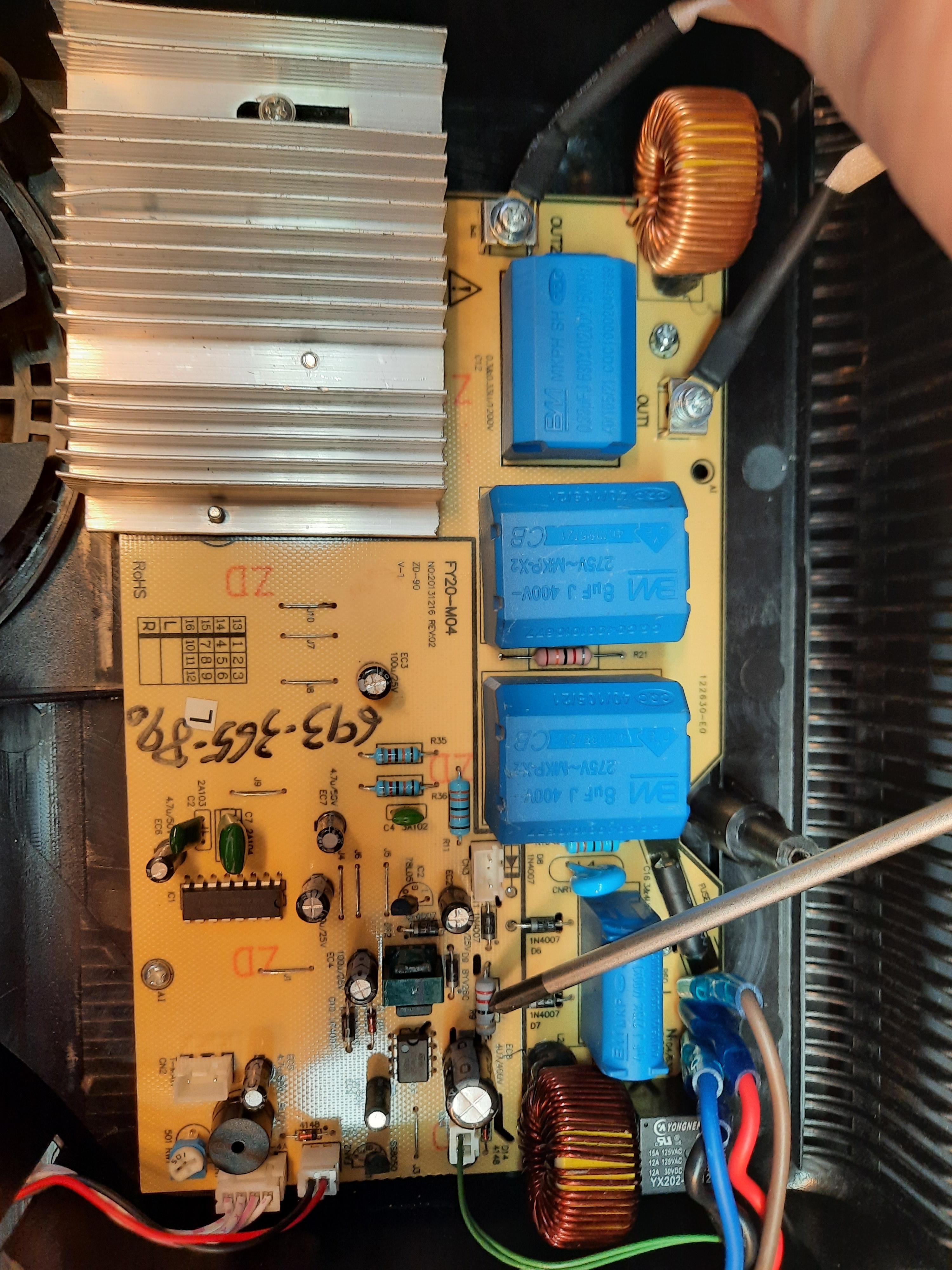

  • #10 19993034
    Adam Pluta
    Posts: 86
    Rate: 7
    I give a photo, show the resistor with a screwdriver, after replacing the resistor, it worked for 2-3 minutes and the resistor burned down again.

    #11 19993686
    TONI_2003
    Moderator
    Posts: 15334
    Help: 2195
    Rate: 3826
    Adam Pluta wrote:
    after replacing the resistor, it worked for 2-3 minutes and the resistor burned again.
    Since you gave the wrong type of resistor not as it was originally (i.e. 22?, but wired ), and besides that, there is a probability that the integrated circuit VIPer xx the inverter is faulty and replace this resistor for nothing. Without checking all the elements of this converter (there is only a question), can you do it?

    Adam Pluta
    Posts: 86
    Rate: 7
    The resistor was installed, it is a two-burner stove and on the right side it is also like I assumed on the left.
    Nevertheless, thank you for the hint and I will replace the layout you suggest.
  • #13 20010149
    Adam Pluta
    Posts: 86
    Rate: 7
    I replaced it as you advised and it has been running for a few days.
