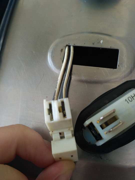

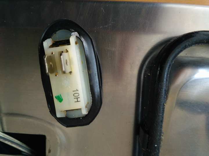

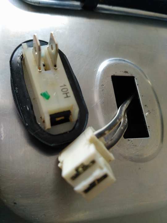

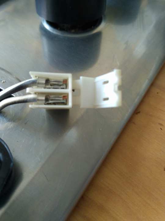

    I tried to unclip the wires, but I can not get them out? I've done it, I've dried it. The switch looks like this:
    Gas Burner 4 - Spark Magnet Firing Continuously: Possible Fixes? Gas Burner 4 - Spark Magnet Firing Continuously: Possible Fixes? Gas Burner 4 - Spark Magnet Firing Continuously: Possible Fixes? Gas Burner 4 - Spark Magnet Firing Continuously: Possible Fixes? Gas Burner 4 - Spark Magnet Firing Continuously: Possible Fixes?
    Was it something else?
  • #4 16666116
    kajron
    Posts: 1006
    Help: 109
    Rate: 159
    If the plug has been removed from the switch, the magnet should stop working if it can not be shorted in this plug or these wires are shorted to the magnet.
