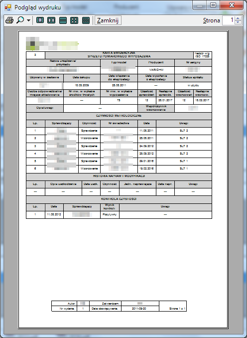

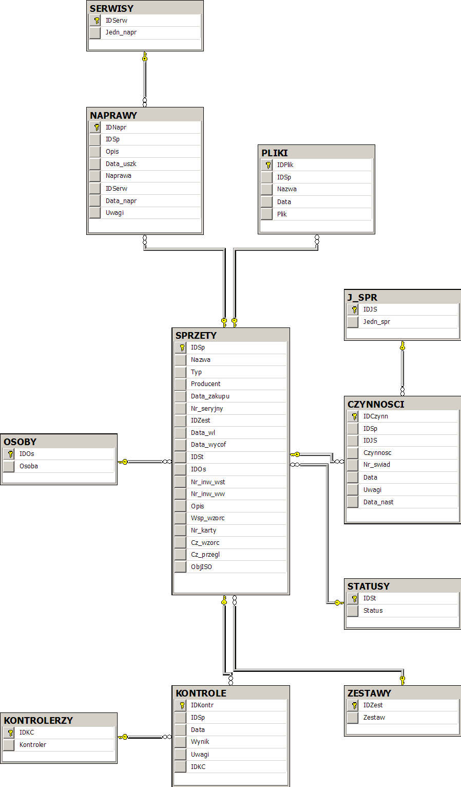

    I used to make such a database - Microsoft SQL engine + C # application:
    Simple Database Program: Create App with Search, Color-Coded Data, Update & Delete Features Simple Database Program: Create App with Search, Color-Coded Data, Update & Delete Features Simple Database Program: Create App with Search, Color-Coded Data, Update & Delete Features Simple Database Program: Create App with Search, Color-Coded Data, Update & Delete Features

    Unfortunately, the program was made to order and I can't support you with a code, because this one was also the subject of the contract. However, screenshots can give you some ideas / functionalities. For example, the ability to attach equipment calibration certificates in PDF or correction tables from calibration in XLS. Binary files were stored in the database as BLOB (generally it would be better to keep them on a server, e.g. FTP, but this would complicate the program). The program requires no installation and works over the network. The base is a solid relational base, probably in the 2nd normal form, and not a simple table. In previews, the upcoming end of reviews / calibrations are highlighted in yellow, and red are highlighted. Editing fields support automatic completion based on existing entries.
    Initially, I was going to do it in Accesa - there you can design the GUI for the application.

    Chanterelle, something beautiful. Exactly what I need. You guided me a lot with this program. Thanks a lot !!!
