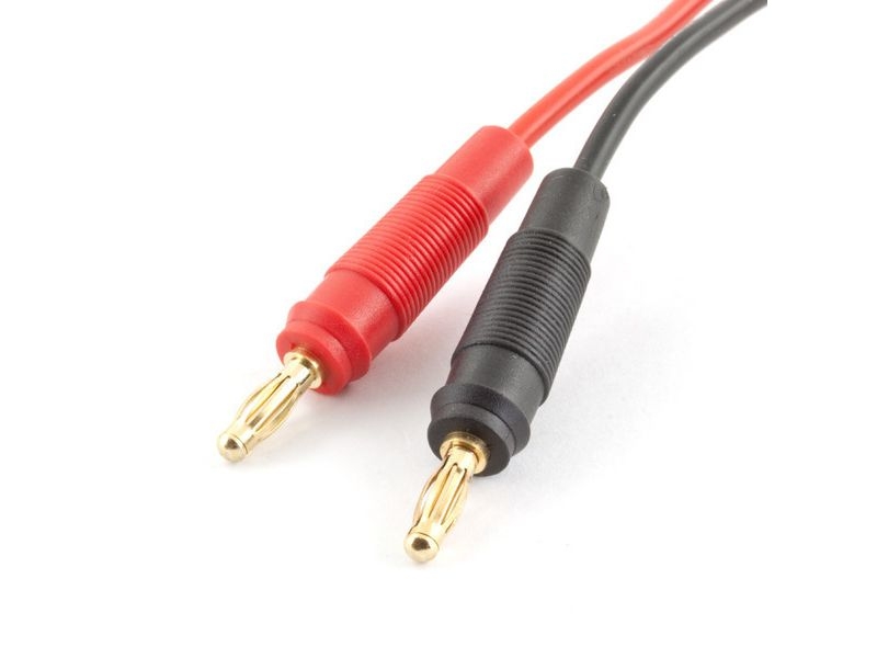

    1 PAWEL
    Level 42  
    Posts: 7210
    Help: 674
    Rate: 1364
    I had them in the set - Redox Alpha V2 charger
    12V DC power cord (Jack - Crocodile clips)
    1 x Gold 4 mm adapter - DEAN plug
    Additional extension adapters for the Gold 4 mm adapter - DEAN plug:
    1 x DEAN Socket Adapter - Crocodile Clips
    1 x Adapter DEAN Socket - Servo Socket (futaba)
    1 x Adapter DEAN socket - Dummy candle (for charging 1.5V clips)
    1 x Adapter DEAN Socket - Tamiya Plug (large)
    Redox Alpha V2: Charging AA Batteries & SYMA Drone Battery Pack with 4AA Holder (Eneloop)
    You can buy any other connectors you need by yourself and adapt it to your needs.
