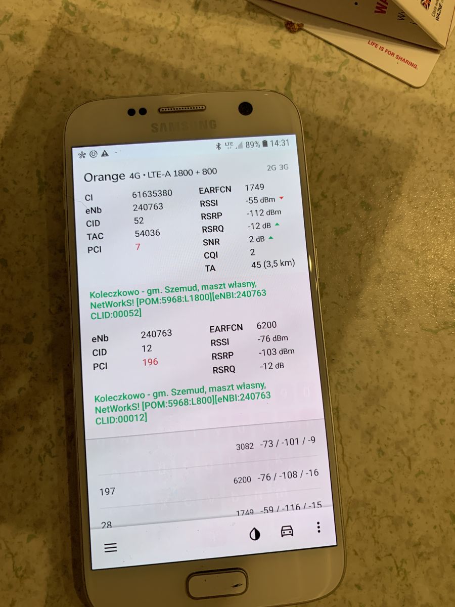

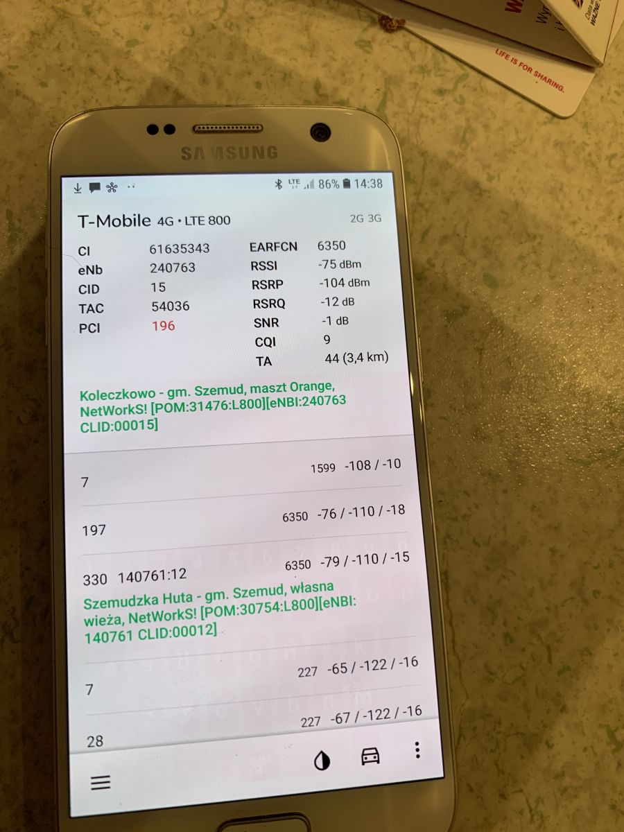

    Good morning, I do not know which router and external LTE antenna to choose.
    From what I've learned, "the basis is always the location, the operator and his test"
    The location is Kieleńska Huta, Wrzosowa (Pomeranian Voivodeship), Orange, I did not test.
    From what I've seen, Orange is the only relatively close antenna (5-6 km).
    Budget within reason, let's assume up to PLN 1 - 2 thousand.

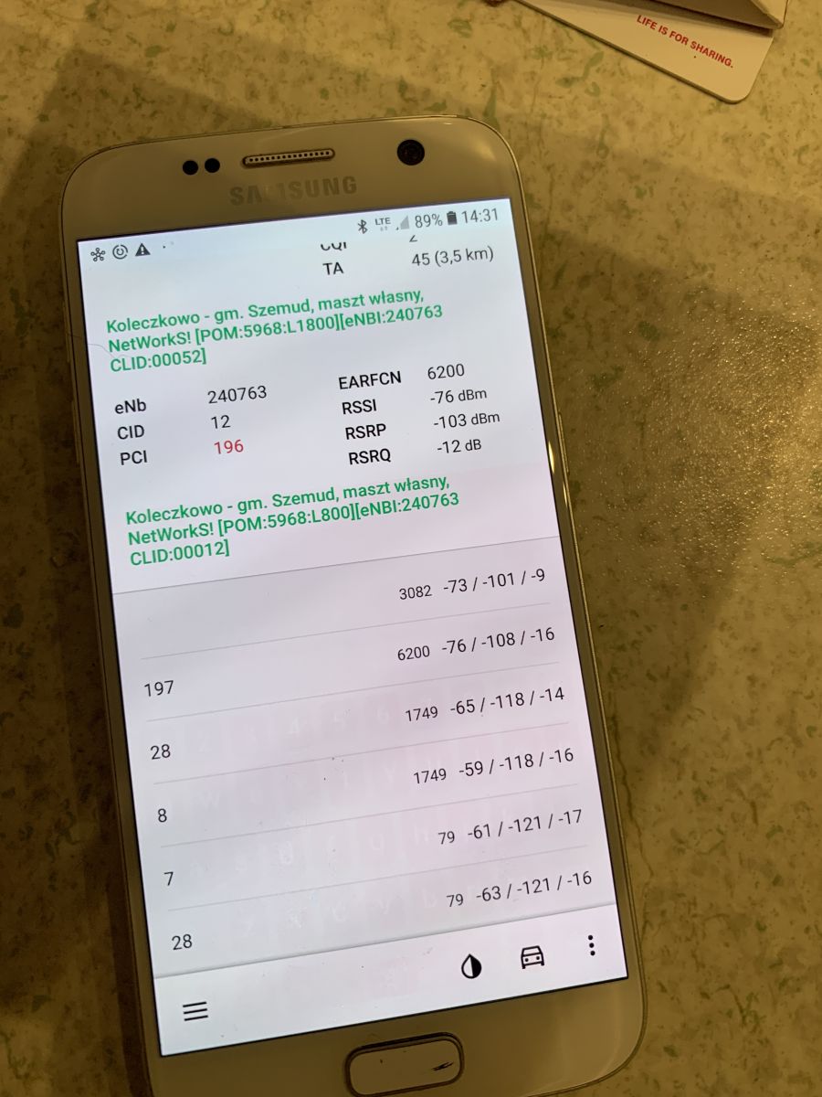

    Test Orange, Play, and T-Mobile with NetMonster or Field Test

    Of course, not only Orange, the more without tests, the NetWorks Leśno station on the Play mast is a misery with naked LTE800 for Orange and T-mobile, the only sensible one is Szemudzka Huta with LTE2600+2100+1800+800 aggregation for these operators, the sector from it is directed in Debnik. In addition, the NW station with LTE2100+1800+800 in Koleczkowo. Play has the mentioned mast in Leśno and LTE2600+2100+1800+800 on it, one of the sectors is aiming at your direction, and the same station in Koleczkowo. Perform tests on the cards of these 3 operators outside on the phone with the application https://play.google.com/store/apps/details?id=cz.mroczis.netmonster&hl=pl and show screenshots from the Live tab and speedtests.
    You have iOS so the application will not work, use the Field Test service code *3001#12345#* https://www.pokoleniesmart.pl/field-test-w-ios-14-doczekal-sie-zmian-jest-lepiej/ or as you write borrow something from android.

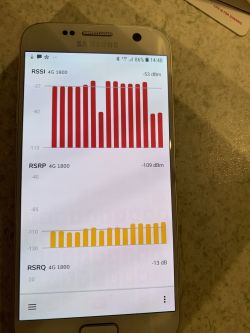

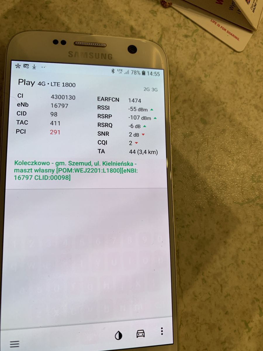

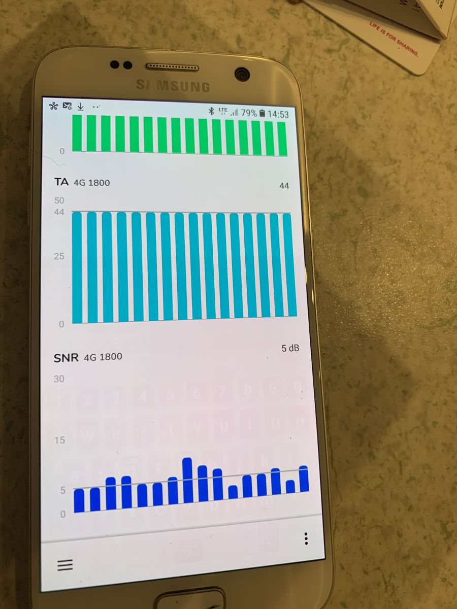

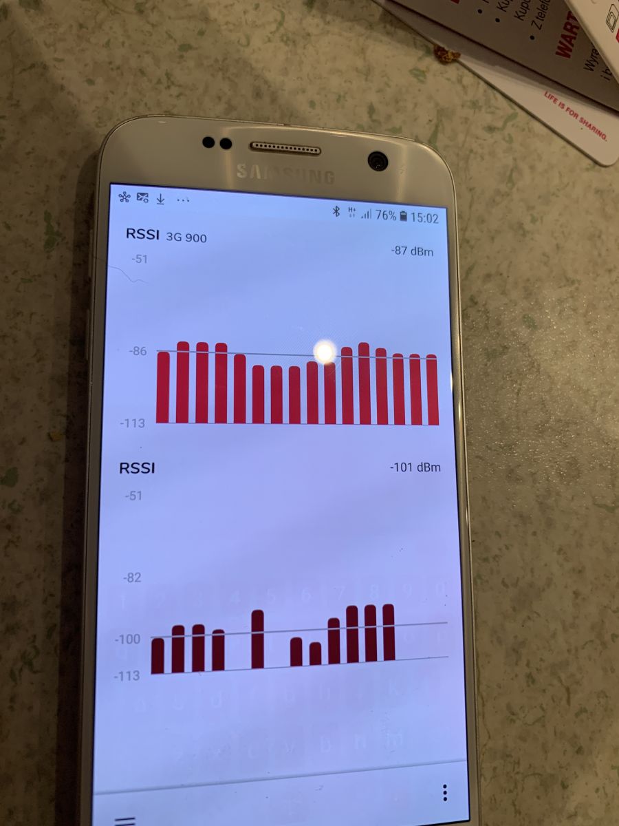

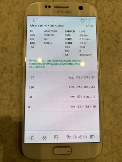

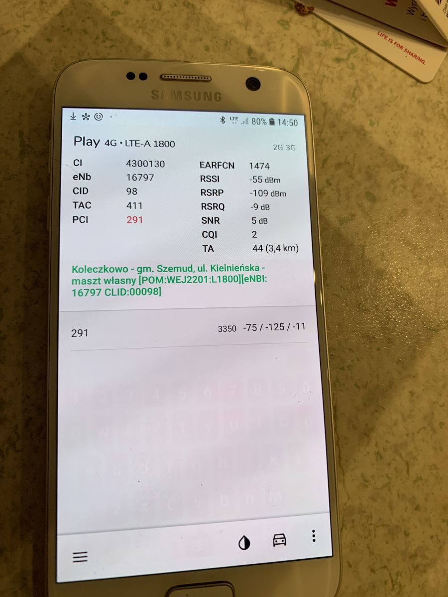

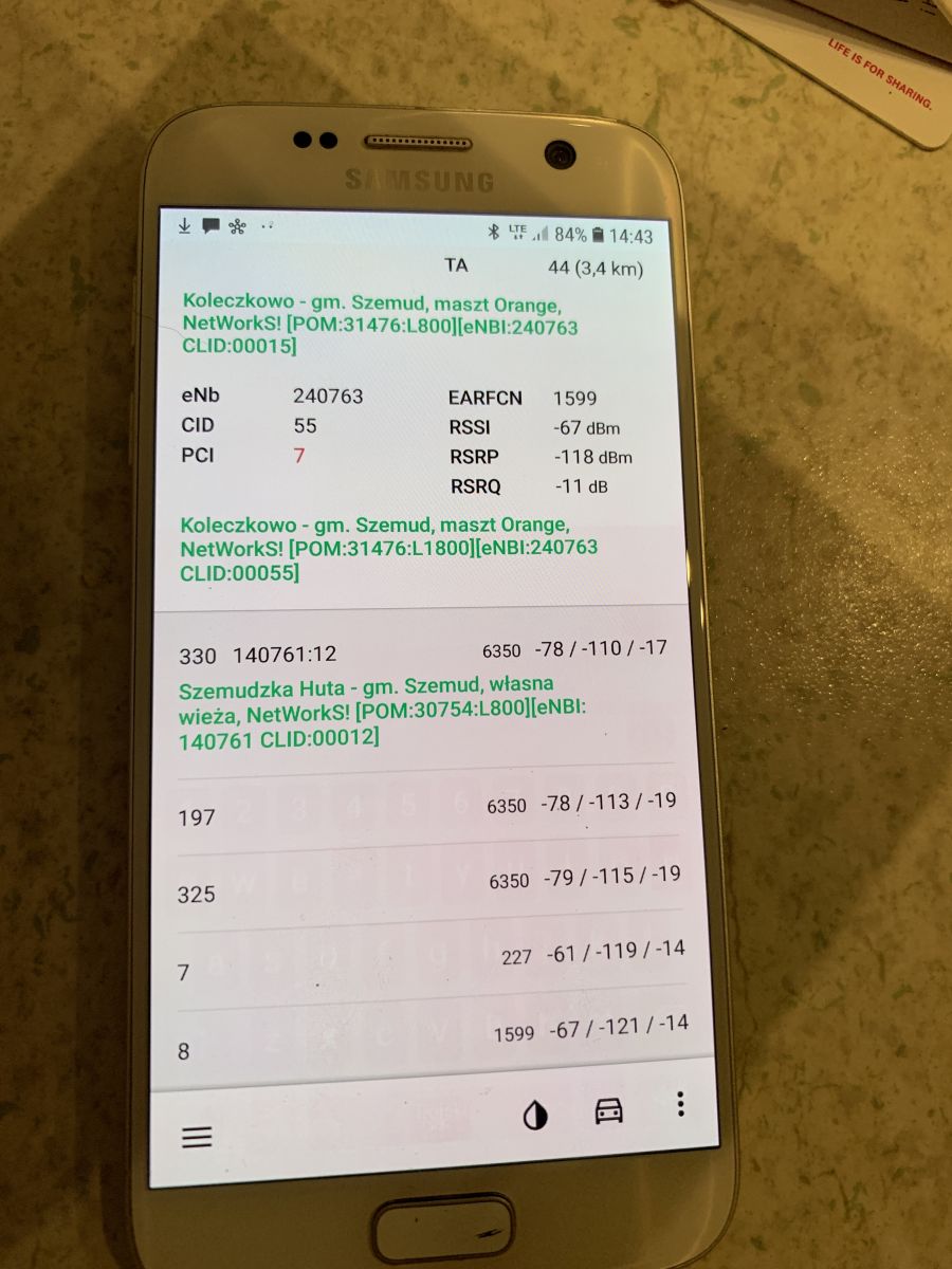

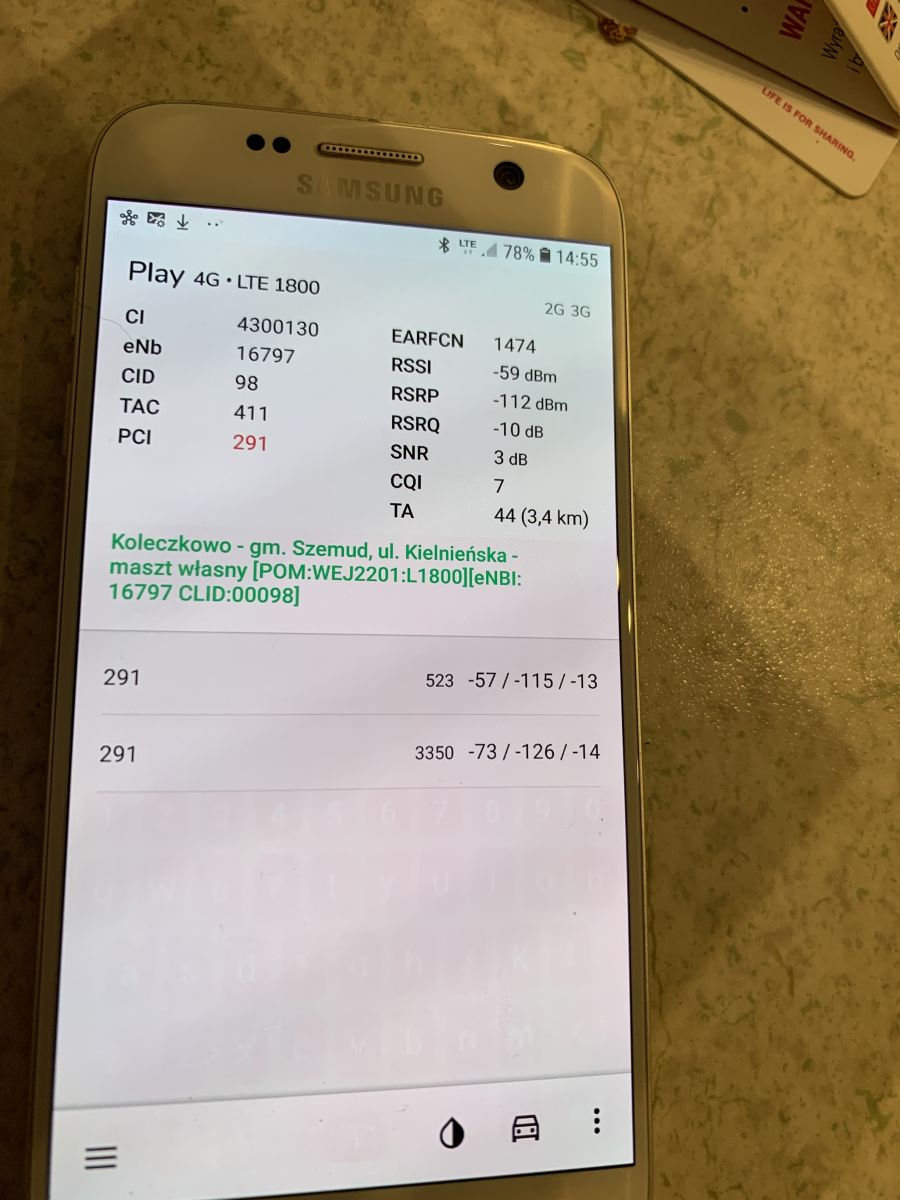

    Added after 3 [hours] 53 [minutes]:

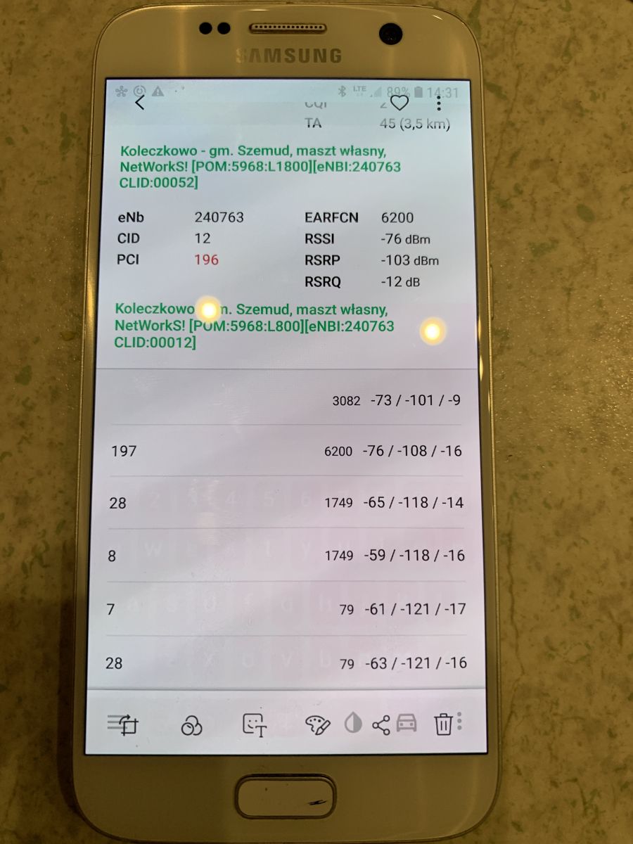

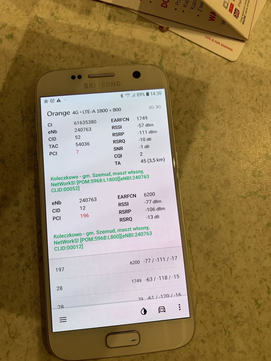

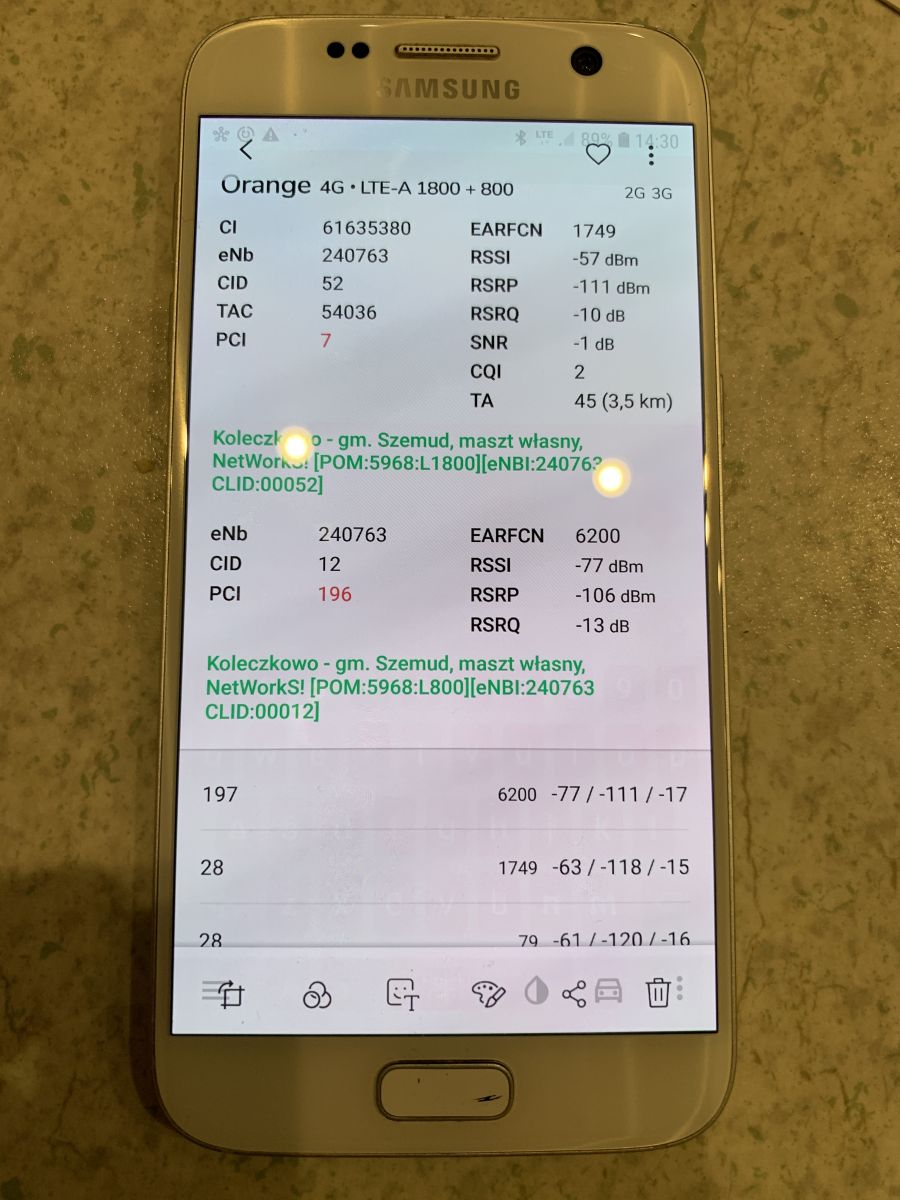

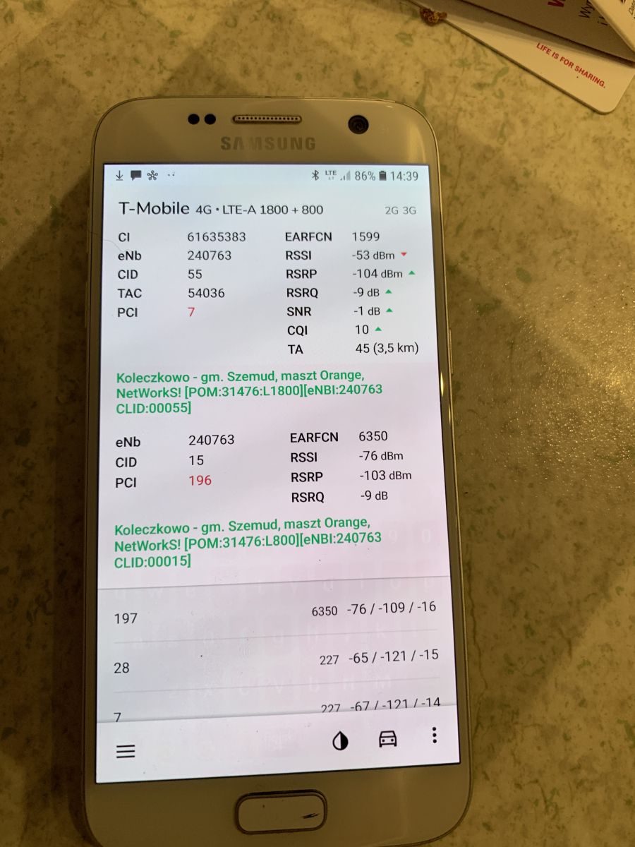

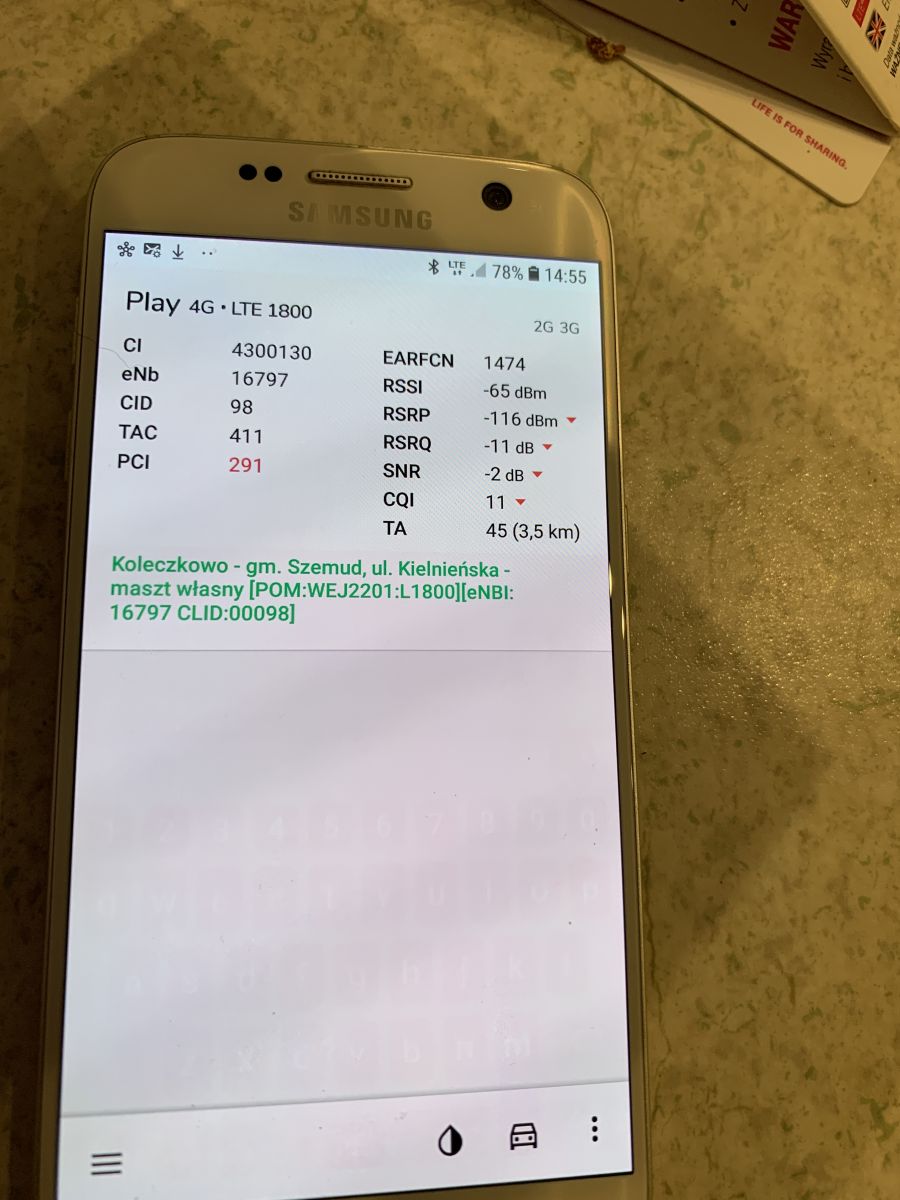

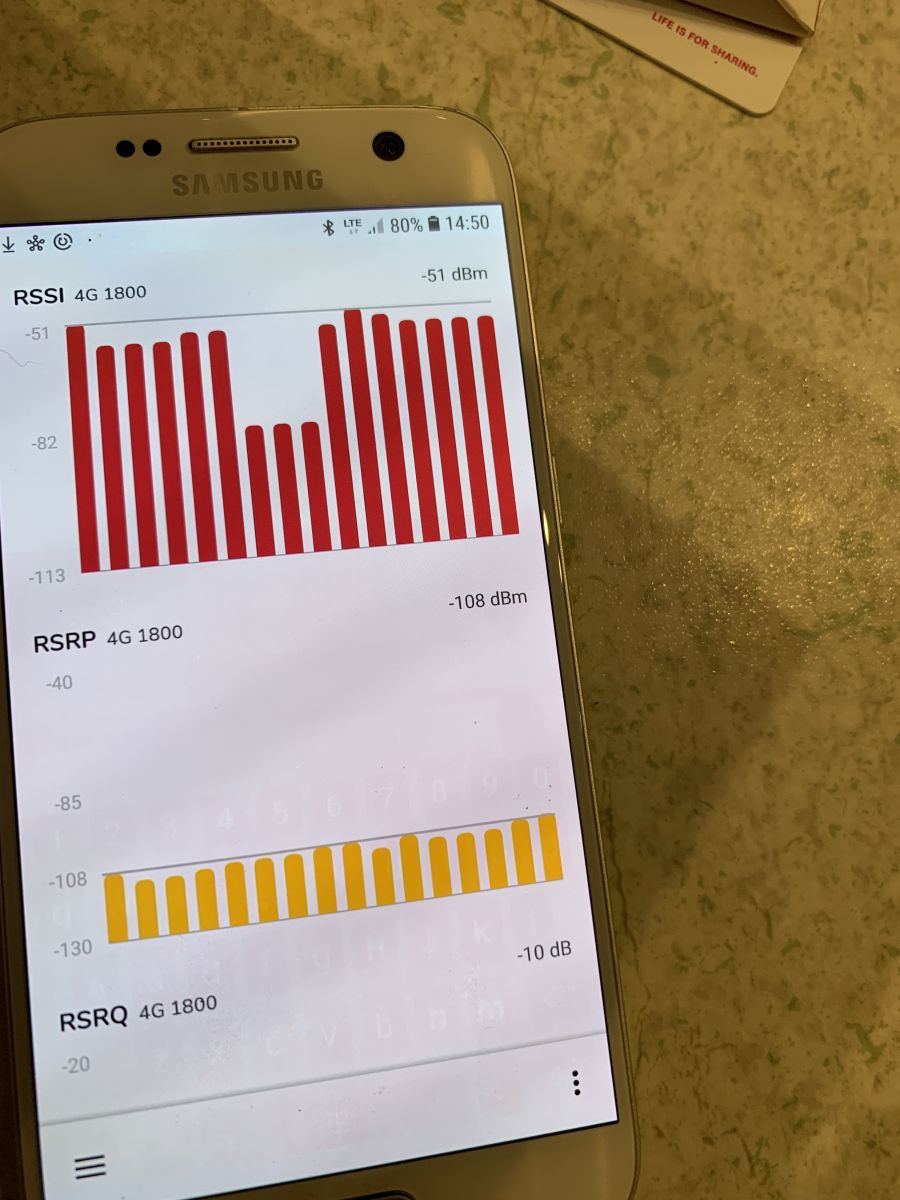

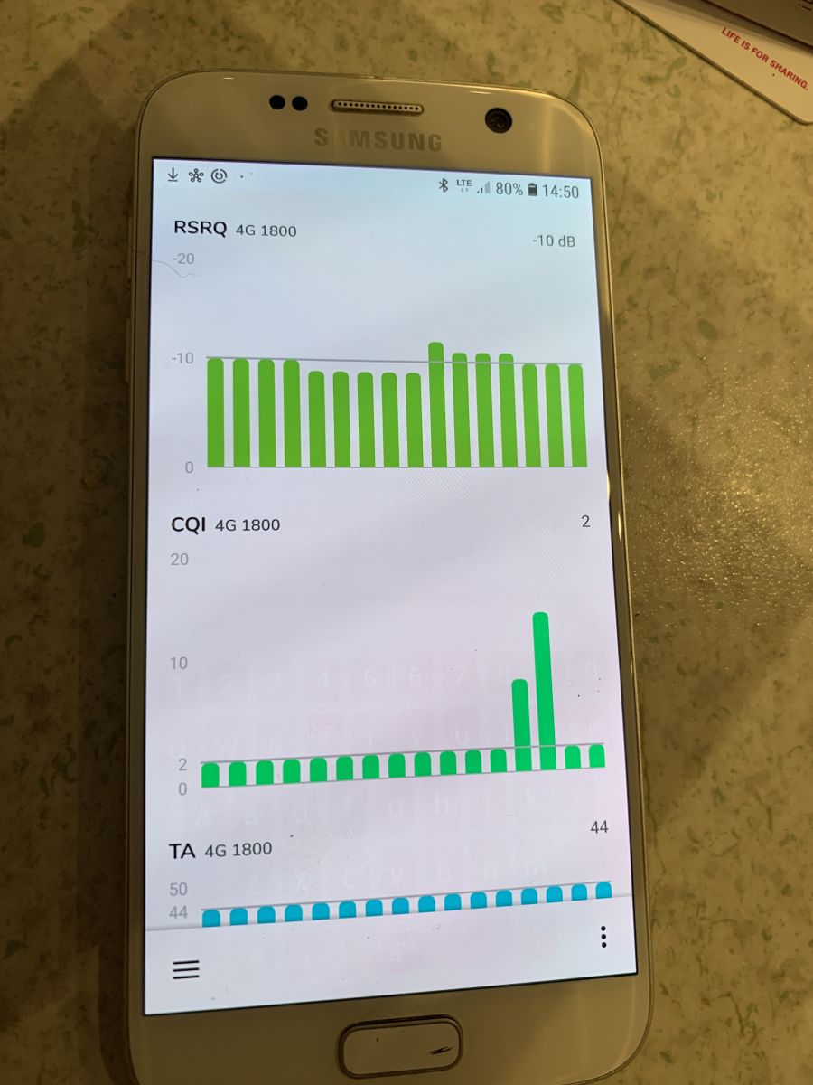

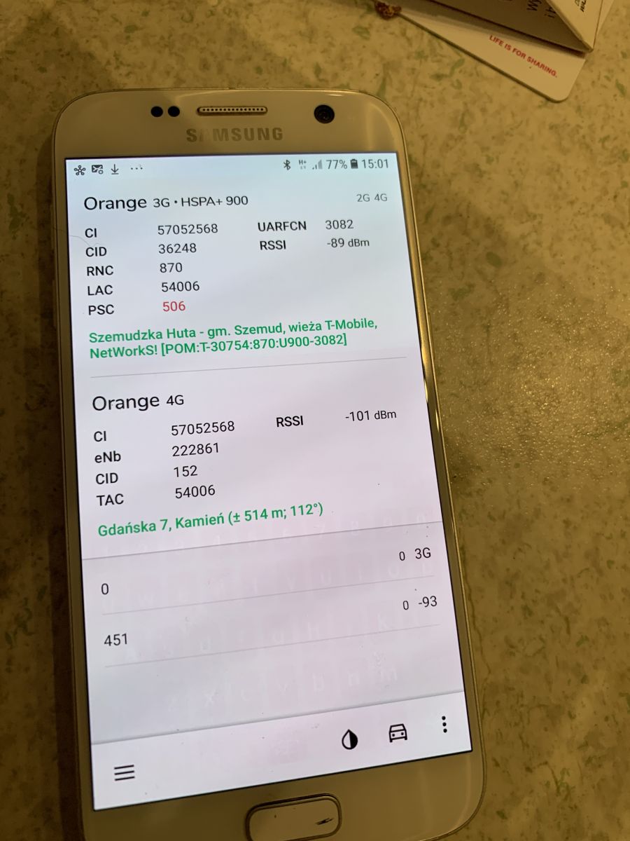

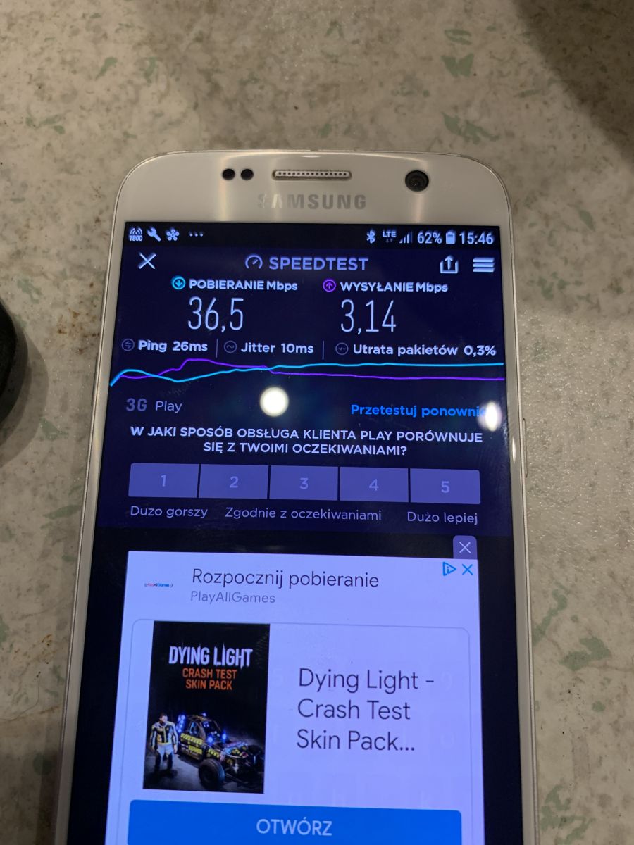

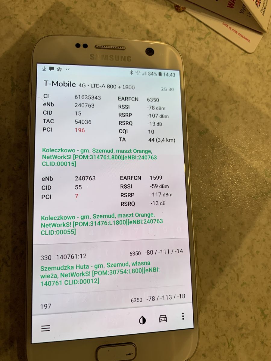

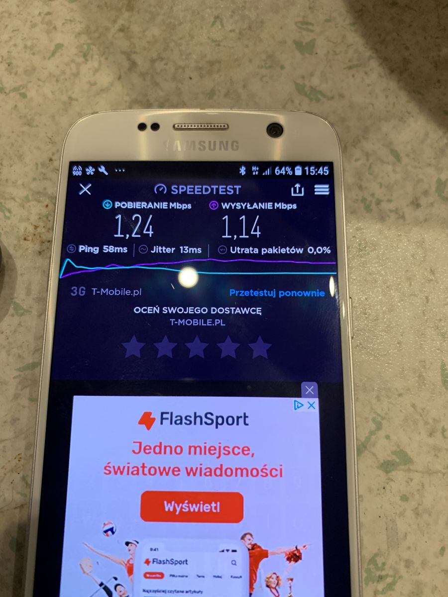

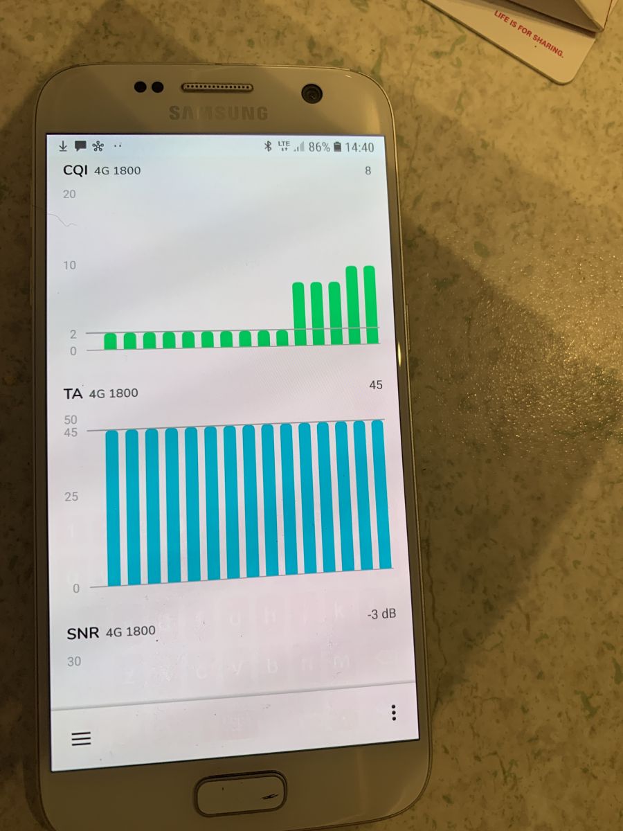

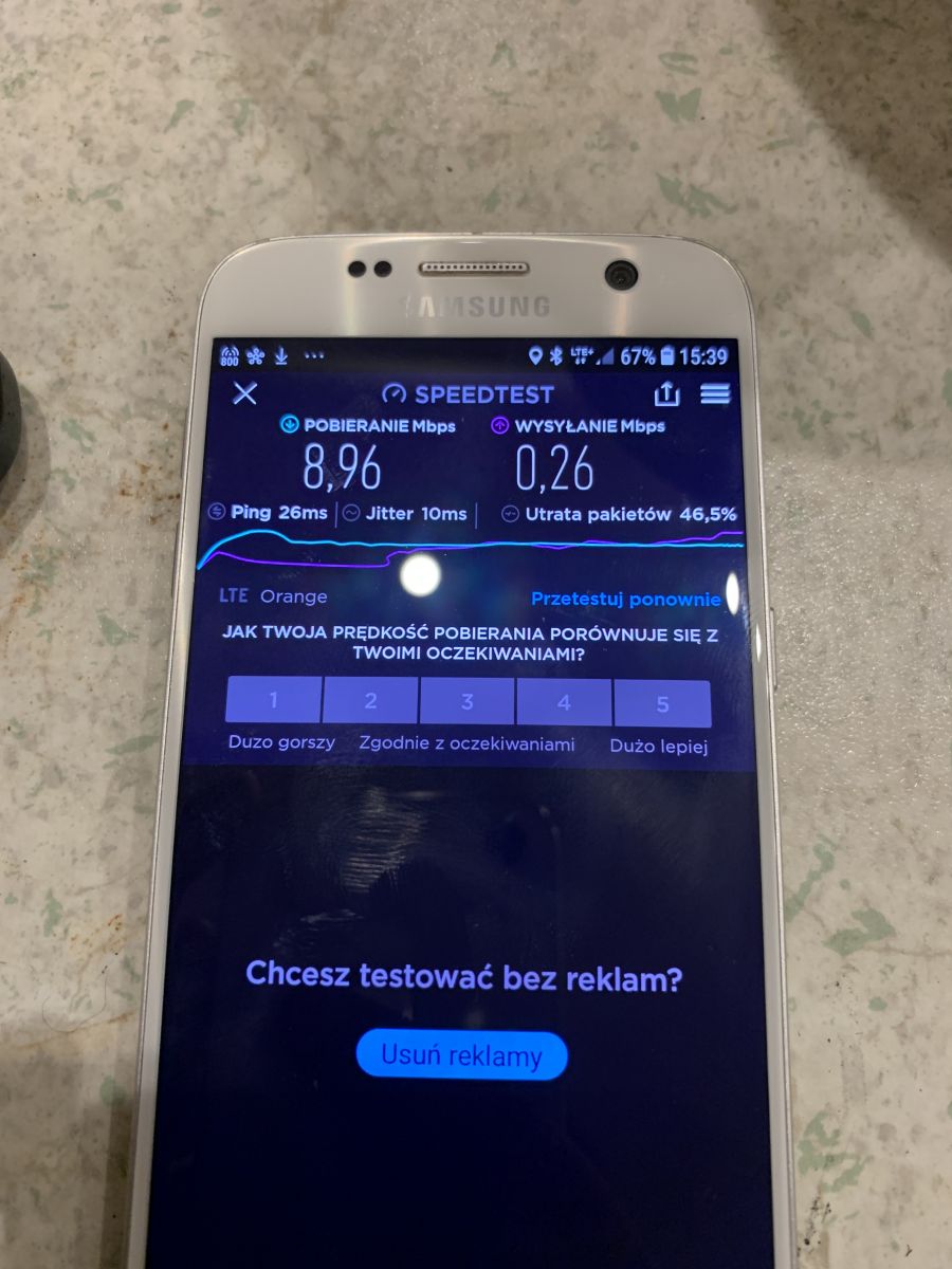

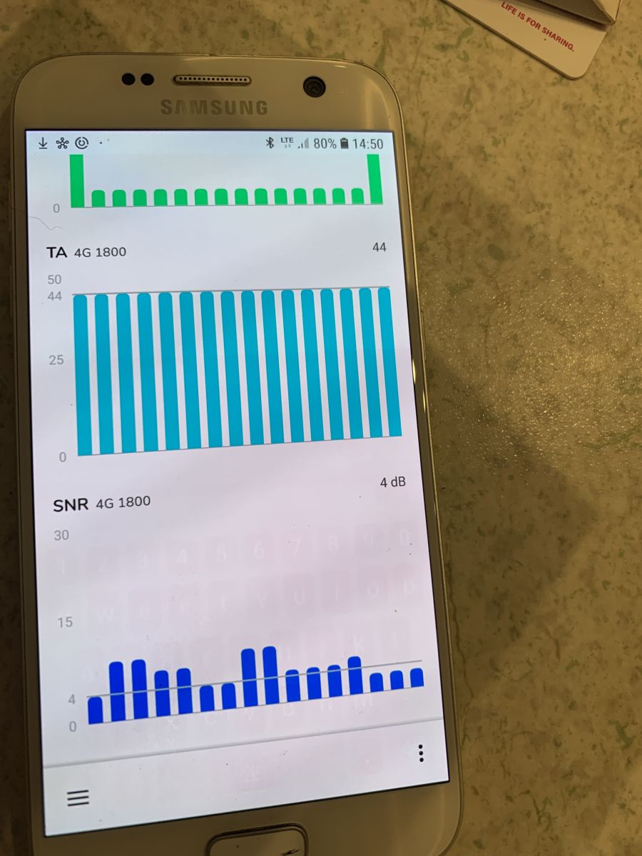

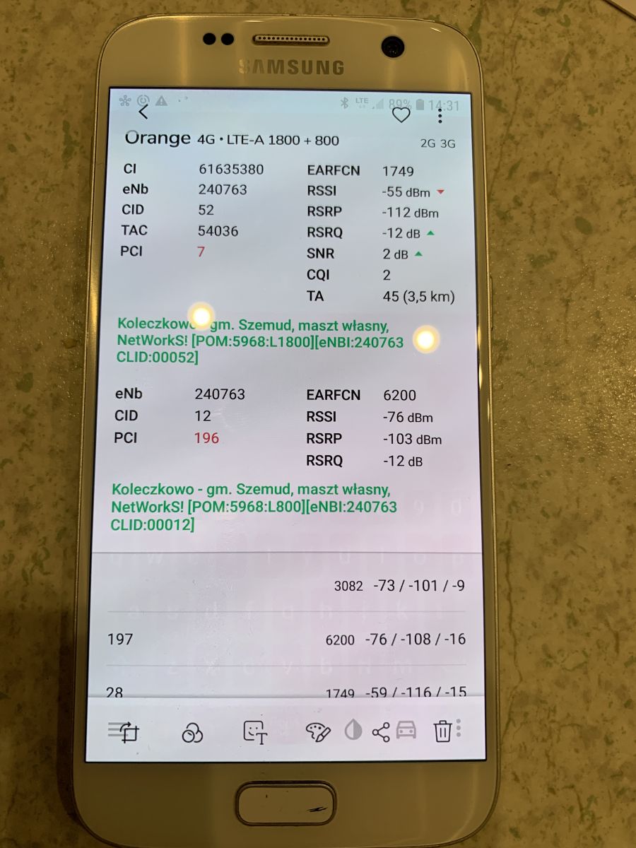

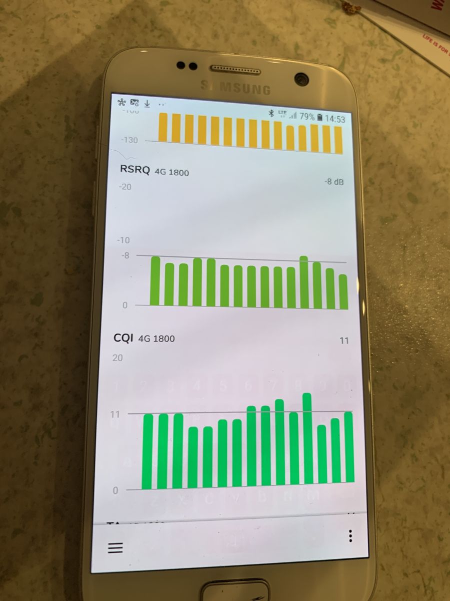

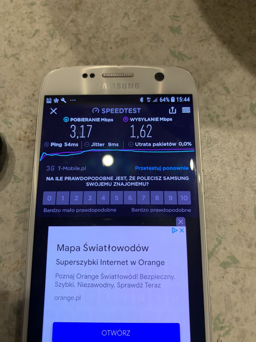

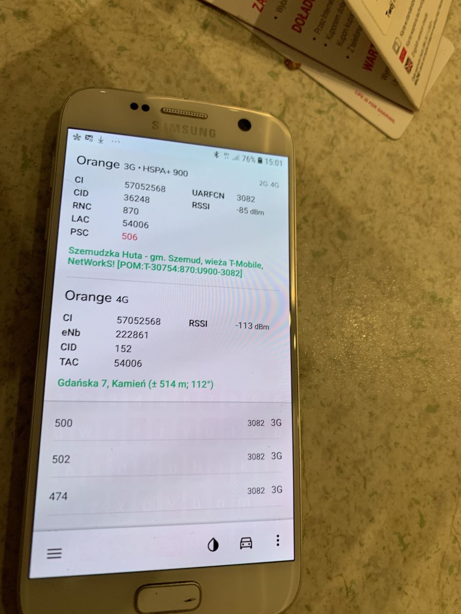

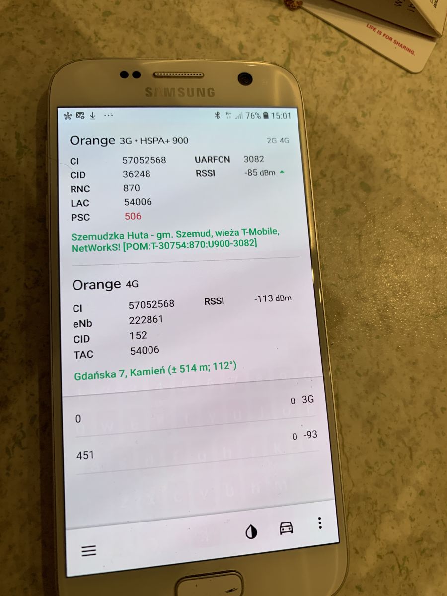

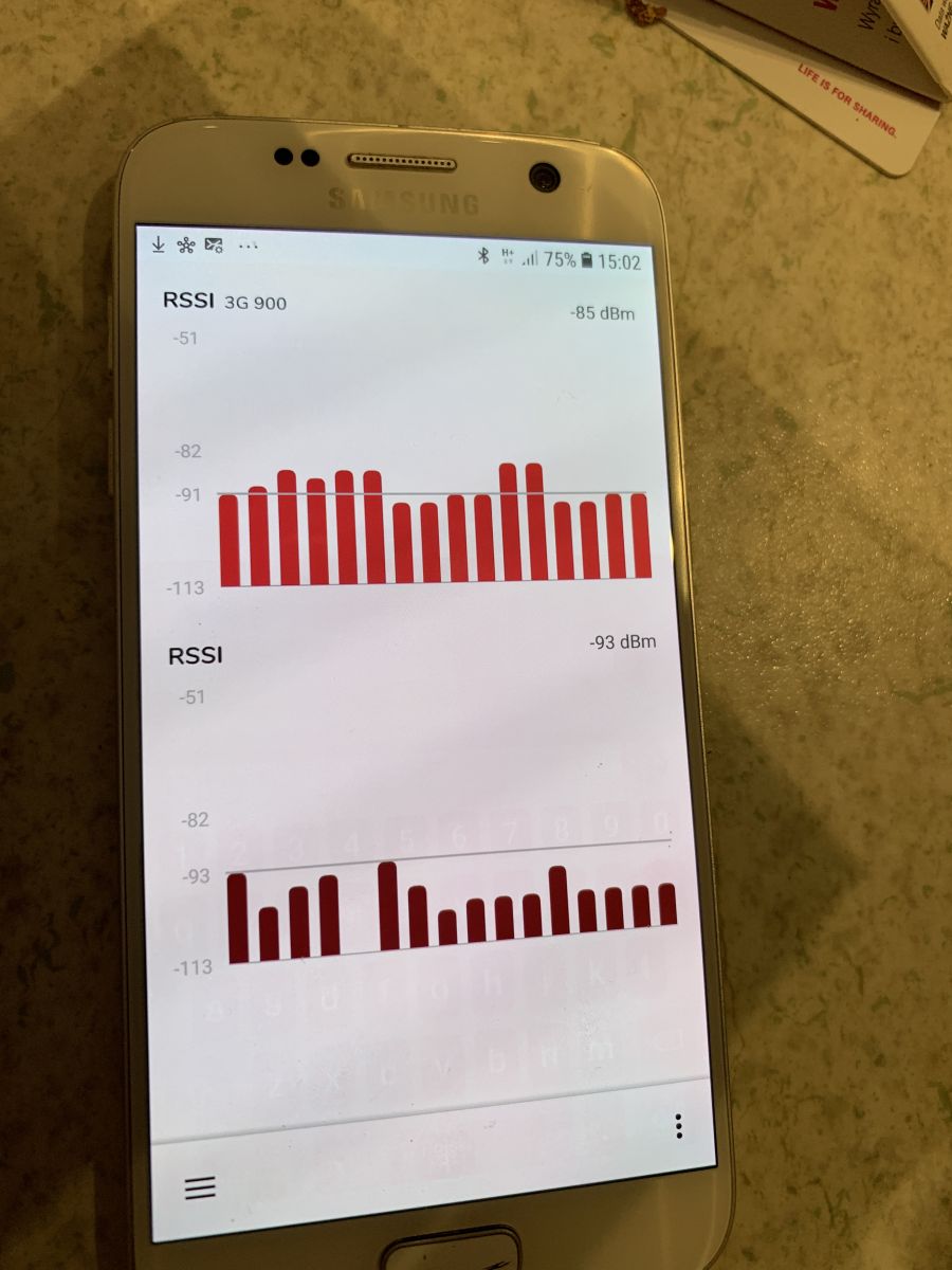

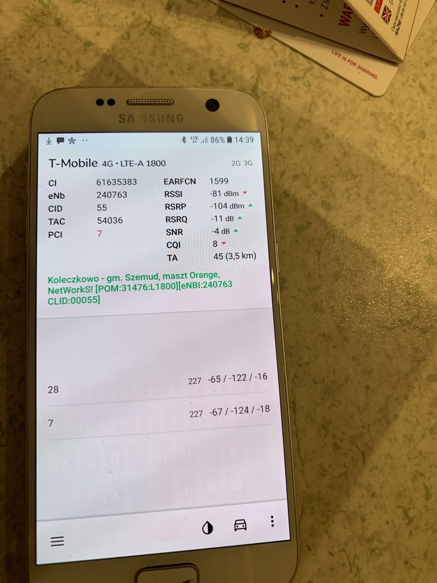

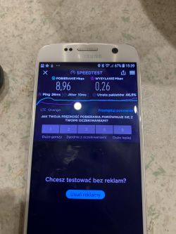

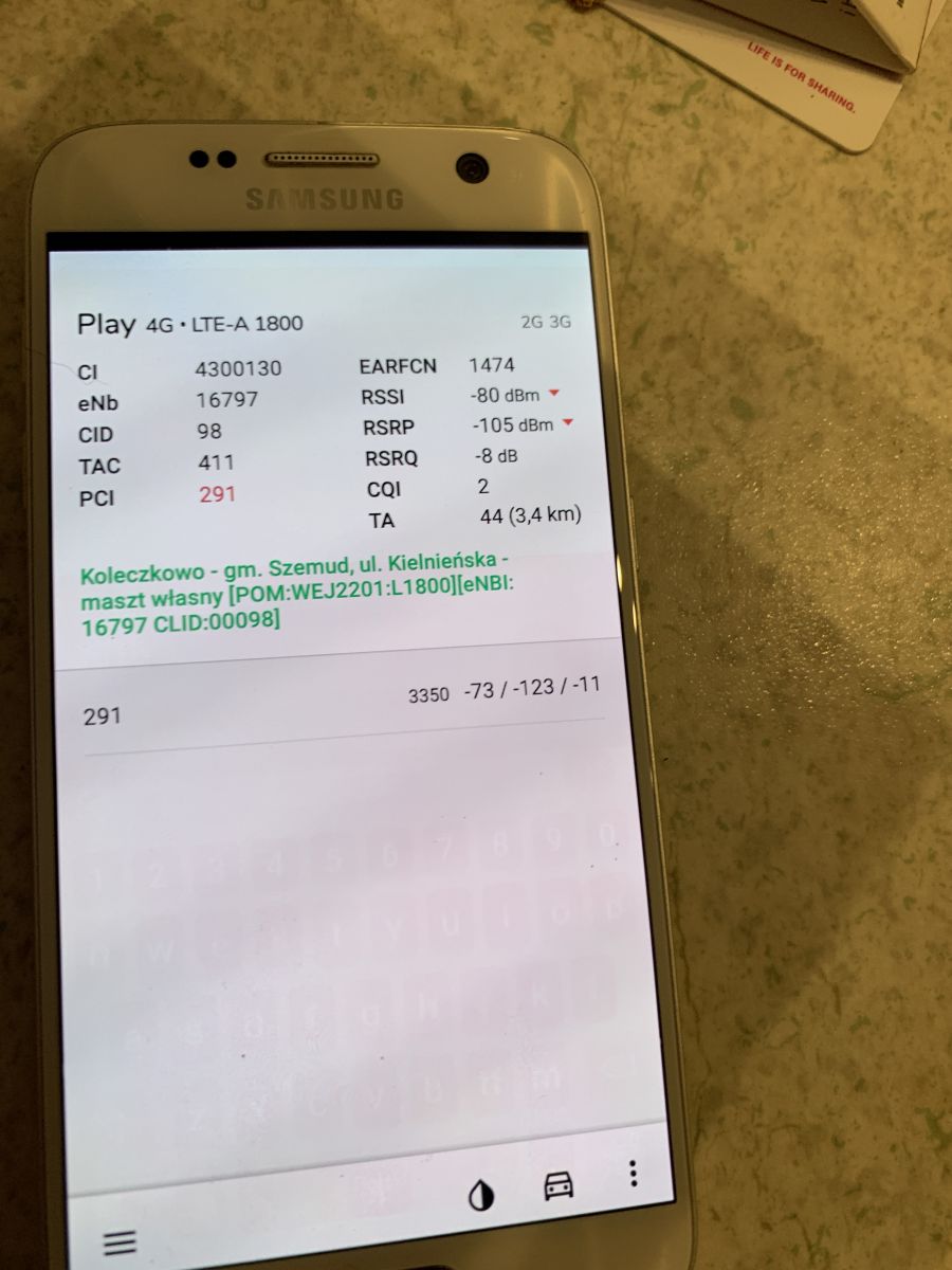

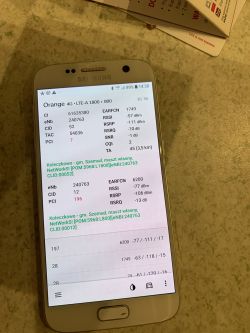

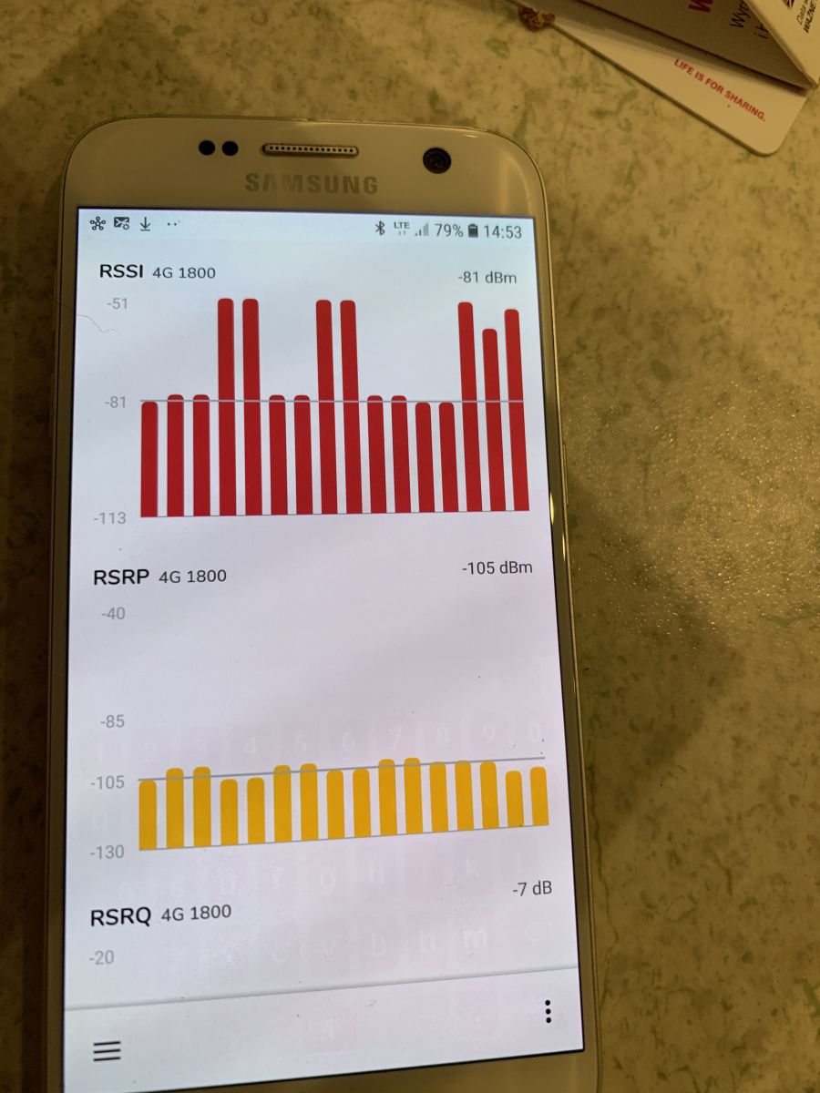

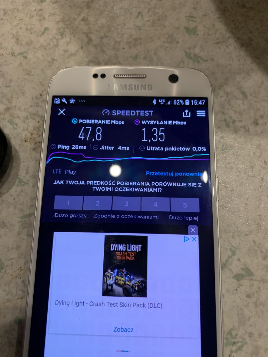

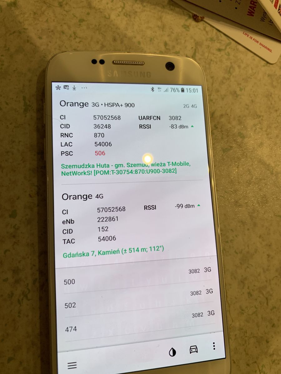

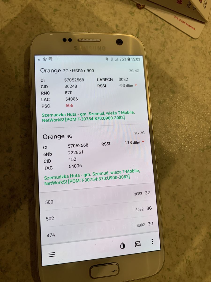

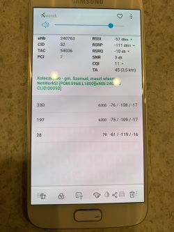

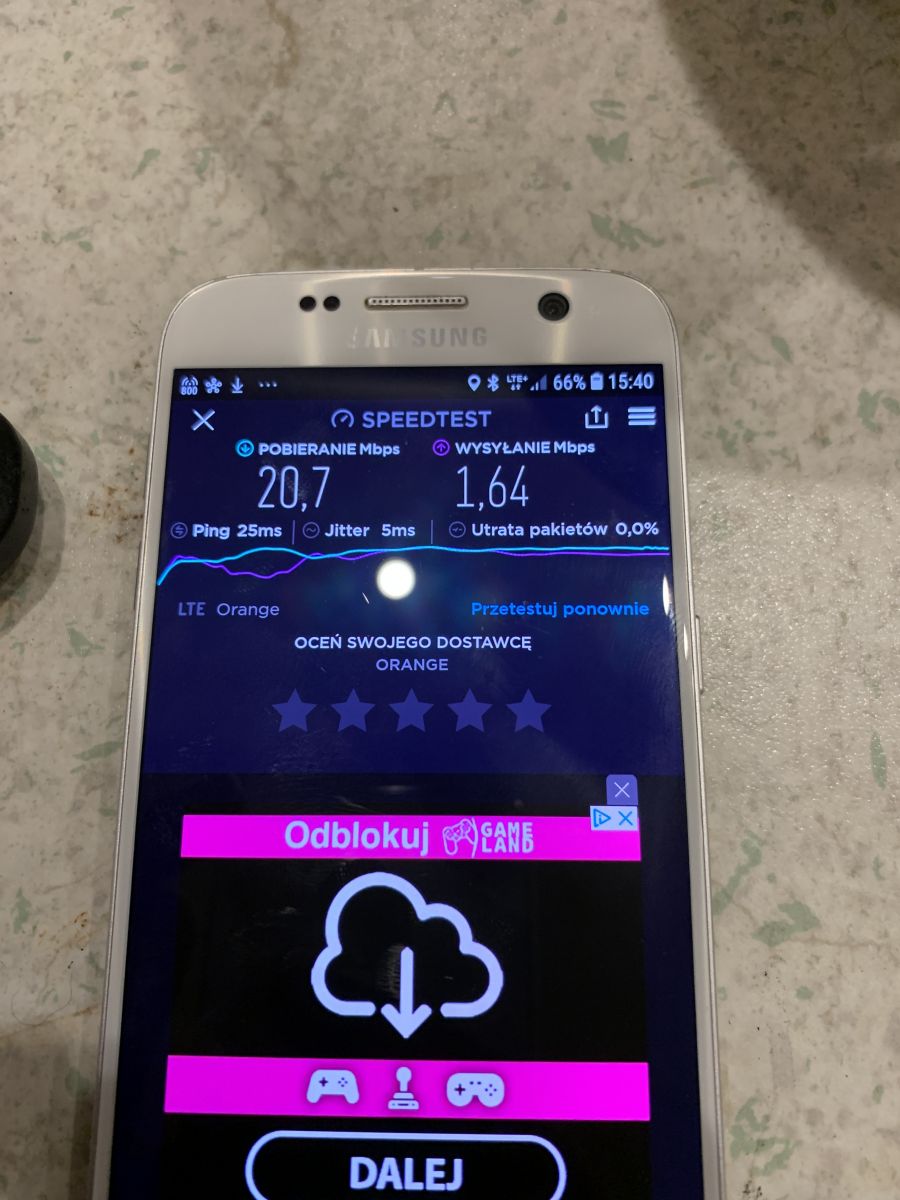

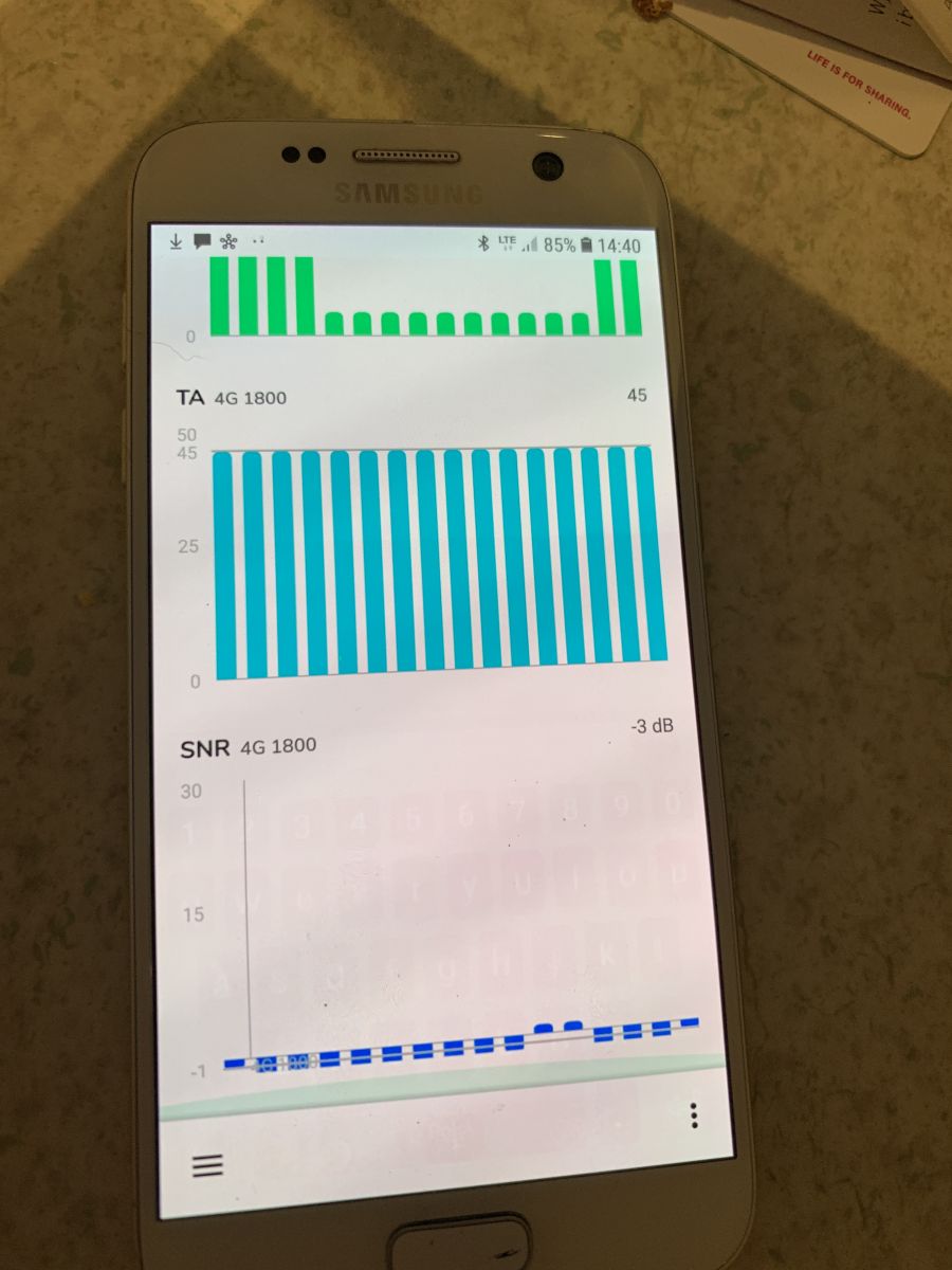

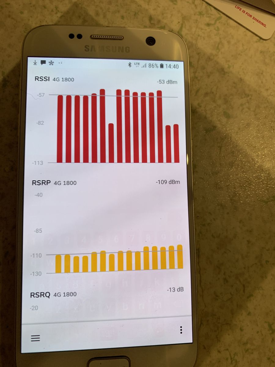

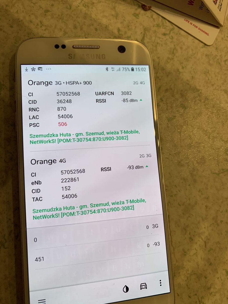

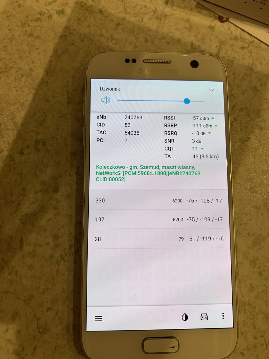

    I did a test of 3 operators.
    I repeated some tests to make sure it worked out well
    url=https://obrazki.elektroda.pl/4407331700_1637769180.jpg] Selection of LTE Router and External Antenna for Orange Network in Kieleńska Huta, Wrzosowa [/url] Selection of LTE Router and External Antenna for Orange Network in Kieleńska Huta, Wrzosowa Selection of LTE Router and External Antenna for Orange Network in Kieleńska Huta, Wrzosowa Selection of LTE Router and External Antenna for Orange Network in Kieleńska Huta, Wrzosowa Selection of LTE Router and External Antenna for Orange Network in Kieleńska Huta, Wrzosowa Selection of LTE Router and External Antenna for Orange Network in Kieleńska Huta, Wrzosowa Selection of LTE Router and External Antenna for Orange Network in Kieleńska Huta, Wrzosowa Selection of LTE Router and External Antenna for Orange Network in Kieleńska Huta, Wrzosowa Selection of LTE Router and External Antenna for Orange Network in Kieleńska Huta, Wrzosowa Selection of LTE Router and External Antenna for Orange Network in Kieleńska Huta, Wrzosowa Selection of LTE Router and External Antenna for Orange Network in Kieleńska Huta, Wrzosowa Selection of LTE Router and External Antenna for Orange Network in Kieleńska Huta, Wrzosowa Selection of LTE Router and External Antenna for Orange Network in Kieleńska Huta, Wrzosowa Selection of LTE Router and External Antenna for Orange Network in Kieleńska Huta, Wrzosowa Selection of LTE Router and External Antenna for Orange Network in Kieleńska Huta, Wrzosowa Selection of LTE Router and External Antenna for Orange Network in Kieleńska Huta, Wrzosowa Selection of LTE Router and External Antenna for Orange Network in Kieleńska Huta, Wrzosowa Selection of LTE Router and External Antenna for Orange Network in Kieleńska Huta, Wrzosowa Selection of LTE Router and External Antenna for Orange Network in Kieleńska Huta, Wrzosowa Selection of LTE Router and External Antenna for Orange Network in Kieleńska Huta, Wrzosowa Selection of LTE Router and External Antenna for Orange Network in Kieleńska Huta, Wrzosowa Selection of LTE Router and External Antenna for Orange Network in Kieleńska Huta, Wrzosowa Selection of LTE Router and External Antenna for Orange Network in Kieleńska Huta, Wrzosowa Selection of LTE Router and External Antenna for Orange Network in Kieleńska Huta, Wrzosowa Selection of LTE Router and External Antenna for Orange Network in Kieleńska Huta, Wrzosowa Selection of LTE Router and External Antenna for Orange Network in Kieleńska Huta, Wrzosowa Selection of LTE Router and External Antenna for Orange Network in Kieleńska Huta, Wrzosowa Selection of LTE Router and External Antenna for Orange Network in Kieleńska Huta, Wrzosowa [img-28] Selection of LTE Router and External Antenna for Orange Network in Kieleńska Huta, Wrzosowa Selection of LTE Router and External Antenna for Orange Network in Kieleńska Huta, Wrzosowa Selection of LTE Router and External Antenna for Orange Network in Kieleńska Huta, Wrzosowa Selection of LTE Router and External Antenna for Orange Network in Kieleńska Huta, Wrzosowa Selection of LTE Router and External Antenna for Orange Network in Kieleńska Huta, Wrzosowa Selection of LTE Router and External Antenna for Orange Network in Kieleńska Huta, Wrzosowa Selection of LTE Router and External Antenna for Orange Network in Kieleńska Huta, Wrzosowa Selection of LTE Router and External Antenna for Orange Network in Kieleńska Huta, Wrzosowa Selection of LTE Router and External Antenna for Orange Network in Kieleńska Huta, Wrzosowa Selection of LTE Router and External Antenna for Orange Network in Kieleńska Huta, Wrzosowa Selection of LTE Router and External Antenna for Orange Network in Kieleńska Huta, Wrzosowa Selection of LTE Router and External Antenna for Orange Network in Kieleńska Huta, Wrzosowa Selection of LTE Router and External Antenna for Orange Network in Kieleńska Huta, Wrzosowa
    Play has strongest LTE coverage and capacity there

    The tests showed what I expected, 3 Play base stations with aggregation of 4 LTE bands do their job, tests as I see at home and in Play from Koleczkowo, coverage on LTE1800/2100/2600 capacitive bands, weak signal and still super speed, although the phone with modem only 6 kat, the station has a lot of potential, it has a 1107 Mb/s radio link to the Wilczlińska 64 fiber node, Orange / T-mobile have poor coverage in the LTE1800+800 aggregation with BTS Koleczkowo or Szemudzka Huta, speeds adequate to the conditions, i.e. they are not overwhelming, but the stations still have LTE2100 residual signal on them and no coverage on LTE2600 from Huta. Do tests, but outside, show screenshots for 3 operators and speedtests, but you can already see that Play has an advantage there.
  • #5 19727779
    malottke
    Level 4  
    Posts: 13
    The tests were done outside.
    These are screenshots, already taken at home so as not to freeze. :)

    Well, the more you need to focus on Play because the tests have shown that it is the optimal operator there.

    Try with BTS Koleczkowo because it was used by the phone, show screenshots from the band management application for single LTE bands and speedtests on them. Then the same with Forest.
