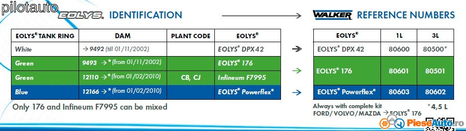

    Hello, Mazda 3 BL 1.6 80kW 2010. What should I add liquid to the dpf? in Mazda ASO they gave the number Y61L13S0.

    Have you checked here?

    Will the dpf fluid be green or blue according to Walker data?
    Walker
    I checked, but there is no clear answer there, in Peugeot you could come by the color of the filler cap and my Mazda is from the beginning of 2010 and then there was a transition from green to blue ...

    They write to identify by the DAM number on the sticker on the door.

    But that is for PSA, not for Mazda.
