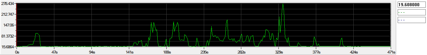

    The fact that I have been driving rather short routes recently and sometimes the regeneration had to be interrupted. In addition, I come across traffic jams almost every day. There is no way to speed up. When regeneration starts while driving home, I can afford an extra round, but in the morning it is not possible. I will track the parameters for a few days (the current ones are not bad), but it looks like I will either have to wash it or replace it.
    Several charts:
    Air flow volme:
    [1.6 HDI 187kkm FAP 109KM] - Risk of particle filter clogging: see handbook
    Exhaust differential pressure:
    Engine speed:
    Vehicle speed:

    But for me the pressure difference is 0mbar. In post # 3, there are graphs from a city ride. Barely 40 shoots at over 3200rpm under load as such (compare with airflow)
    For now, I will watch for some time, and if it will be ok, I will convince him that the filter has been replaced and you will plan cleaning for some warmer days ;) (or at least how I can use the garage with the sewer).

    One more visualization of the logo from post # 3
    Are you suggesting these readings are unreliable?
    Coincide with meter readings and others. They also overlap with the values reported by other users in various other places for similar engines.
    So why would they be bad?

    Pressure range, 0- 100 mbar -> which gives an analog signal of 500 - 4500mV. Pressure range half of what you say.
    Graph I shows that the quantization levels are a multiple of 4. Therefore, at idle speed, the reading is 0 (and this reading probably covers a large range of pressures).
    The data provided by the manufacturer of the sensor replacement (FAE) also shows that the pressure value at the max flow in the above graphs from # 3 is in the upper ranges of the values for this flow. (request filter blocked)
    Data found in various parts of the internet also suggest both low and high pressures for this engine are within expected limits, and a 0 reading at idle is not unusual.
    If the value 0 was a sign of the lack of a filter for the controller, it would have signaled it a long time ago with a critical error and switching to the emergency mode.
    The last premise is the information that this controller does not use the readings of this sensor to assess the filling of the filter, but only estimates it based on the driving style. The sensor is an additional protection (probably in the event of a complete blockage of the filter or its removal, it could also explain poor sampling of the pressure sensor indications). Unfortunately, I can't remember where I read about it.
    Last thing, a lower (as you suggest) reading should not generate a warning about possible filter odors, but rather an error (not a warning) related to a leak / missing fap / sensor or an error with unrealistic readings.
