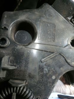

    Added after 12 [hours] 3 [minutes]:
    Either I'm blind or you won't see such a tank. I removed the cover and there is no bag or tank between the wheel and the tank. And what now?
    Added after 1 [hours] 28 [minutes]:
    Citroen C4 Grand Picasso II - FAP Filter Eloys Fluid Refill & Diagbox Info (Bluehdi 150, 2015) Citroen C4 Grand Picasso II - FAP Filter Eloys Fluid Refill & Diagbox Info (Bluehdi 150, 2015) Citroen C4 Grand Picasso II - FAP Filter Eloys Fluid Refill & Diagbox Info (Bluehdi 150, 2015) Citroen C4 Grand Picasso II - FAP Filter Eloys Fluid Refill & Diagbox Info (Bluehdi 150, 2015)
    I only found something like that, but under the cover and the left wheel.

    I'm digging up the topic. I found the tank on the left side by the rear wheel. How is this fluid replenished and how do you select fluid? The plug is white on the clamping elements, the remains of the liquid are dark brown, cherry.

    You buy a set with a bag and refill it like a drip
