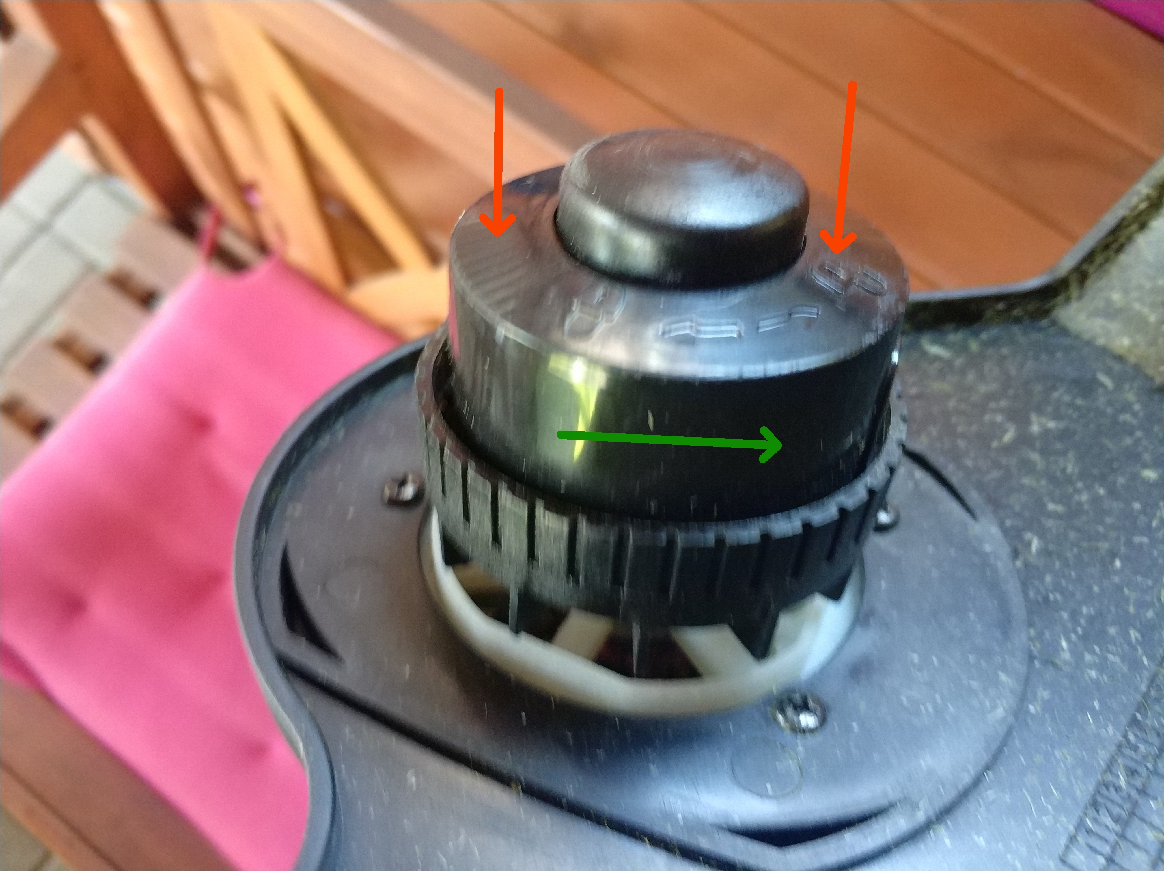

  • #8 17178399
    mar_myr
    NAC TE25-J Electric Trimmer: Guidance on Opening the Head and Line Retrieval

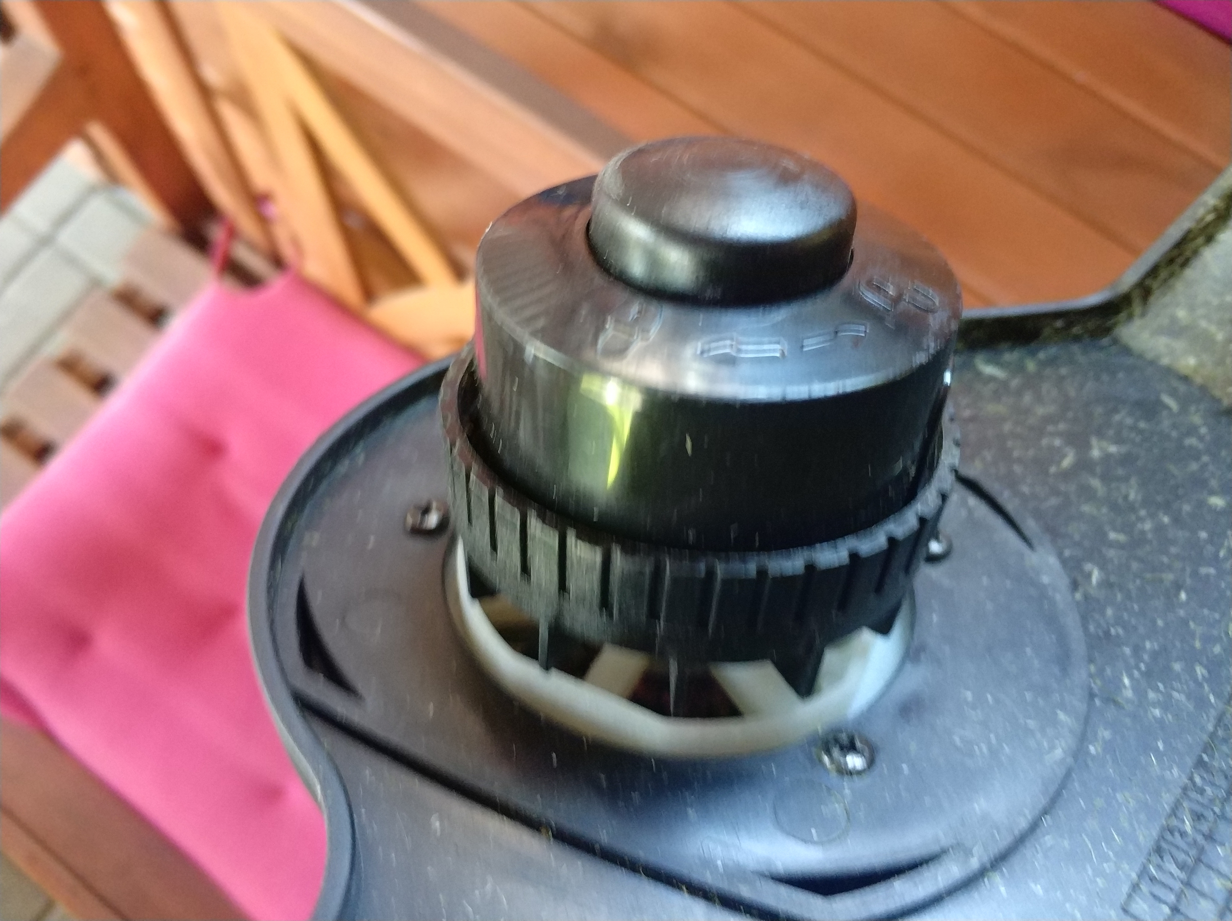

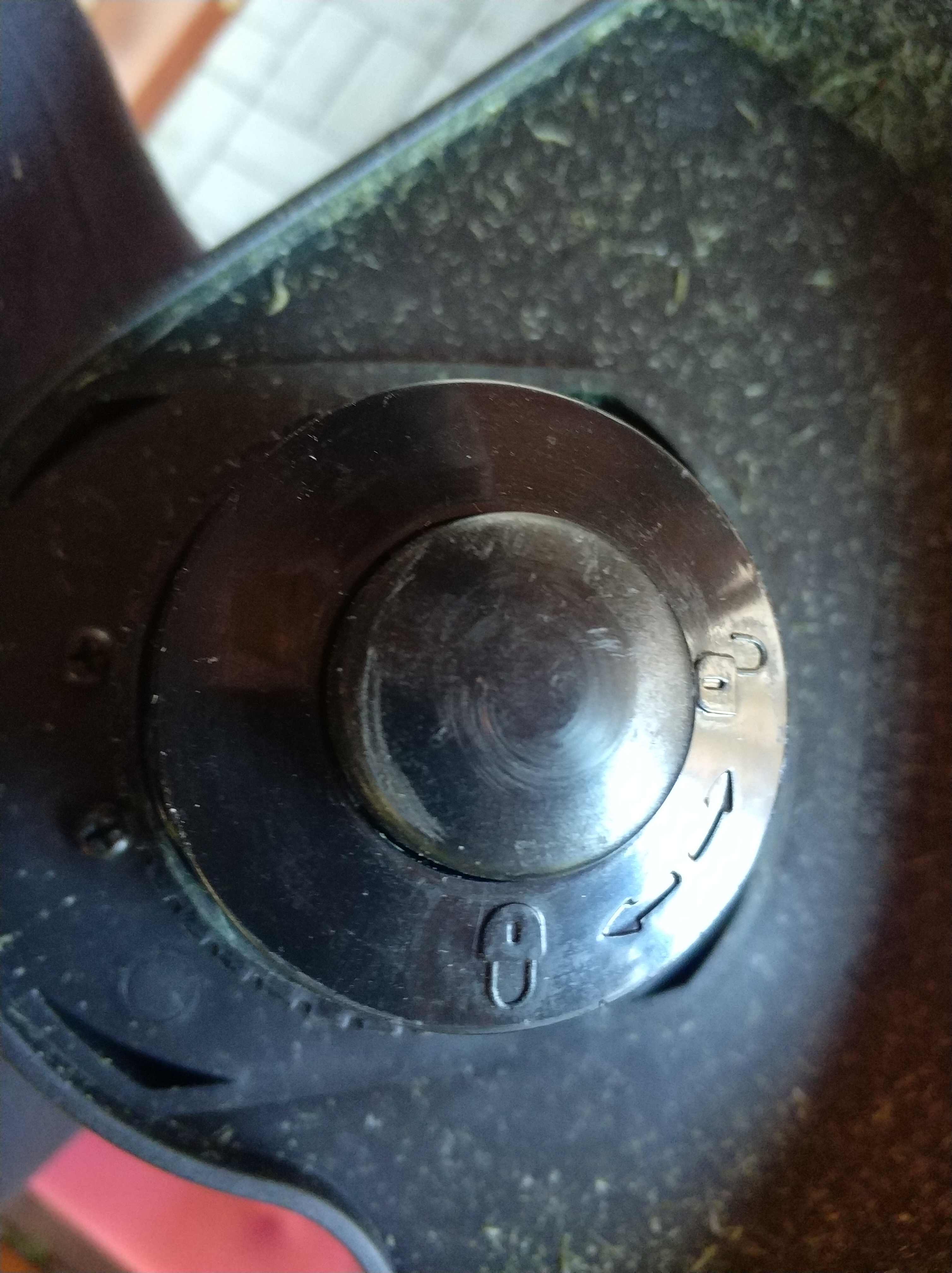

    I have the same problem with the same trimmer model. I'm adding photos because the situation is ... frustrating. I have read the manual, I tried to put it into practice - unfortunately on the head (see the photo) no buttons are visible - I tried to push it in random places, but it was also useless. The direction of the head opening / closing is clearly visible (again photo) - but in practice ... nothing happens when you try to rotate the head.
    Dear forum members - any other practical advice?
    These are just speculations, but perhaps you should first press the large head dome (red arrows) and only then rotate in the direction of opening (green arrow). It's just a guess, but it's always worth a try, maybe something will help.

    I have a similar trimmer and in my opinion the answer has already fallen on this topic. With one hand you have to hold the larger part of the corrugated part, then turn the head according to the arrow. There are quite small snaps there. If the trimmer is new or you get some sand there, it's a bit hard to go. There is no other option.
