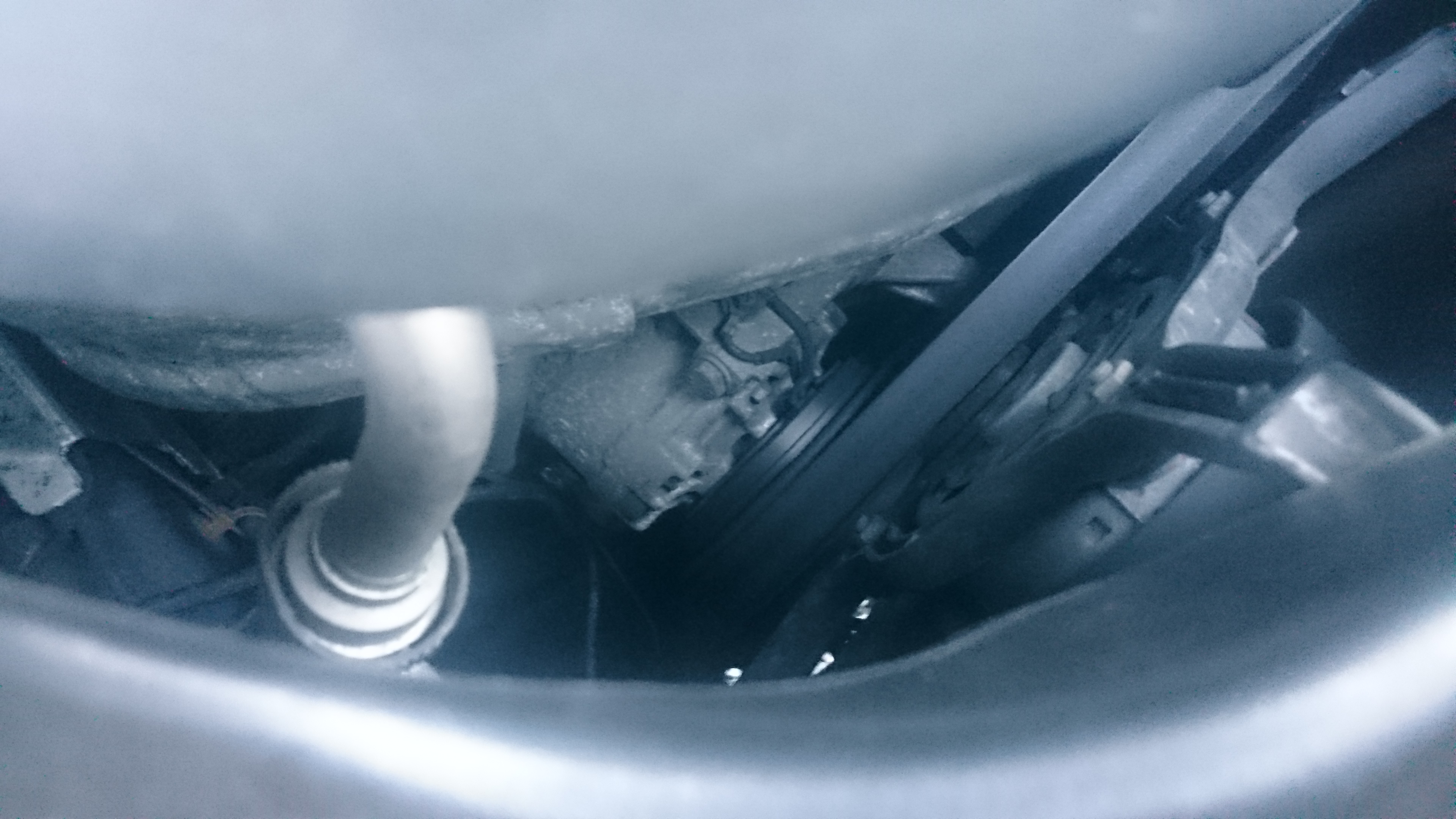

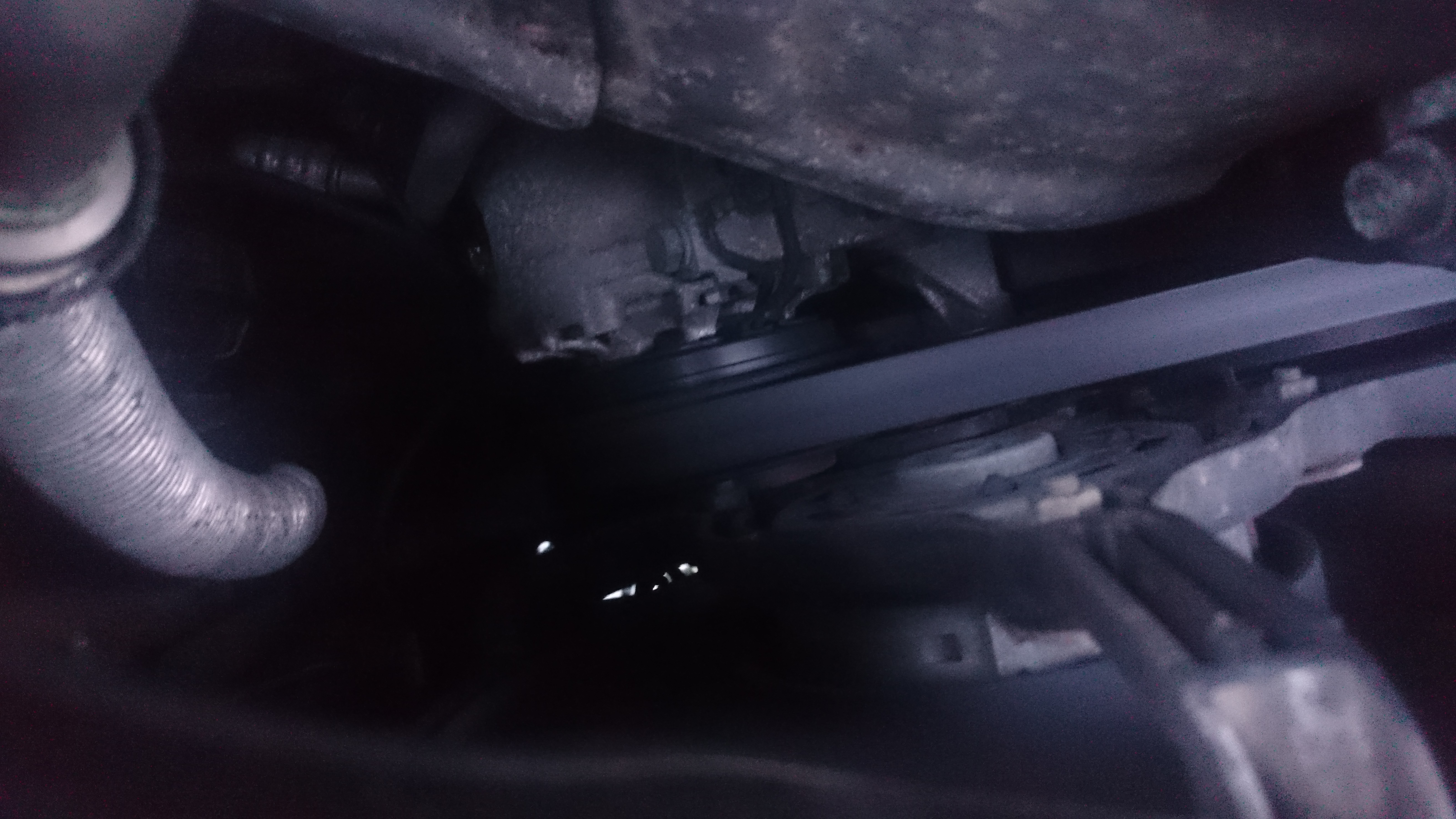

    Hello, I send photos of the place where it squeals when the car lights up, when the car warms up after traveling several dozen kilometers, it squeaks less as if it stopped. Please reply.
    • VW Passat B5: Squeaking Pipes near Belt - Causes & Solutions for Cold & Warm Engine DSC_0427.JPG (5.16 MB) You must be logged in to download this attachment.
    • VW Passat B5: Squeaking Pipes near Belt - Causes & Solutions for Cold & Warm Engine DSC_0429.JPG (2.16 MB) You must be logged in to download this attachment.

    Tighten the belt.

    You probably have a belt to replace. Take a small test. Squeeze a little WD directly onto the strap, as the squeaking silences this exchange.

    I would bet the belt tensioner.

    VW Passat B5: Squeaking Pipes near Belt - Causes & Solutions for Cold & Warm Engine DiZMar no offense, but you wrote "stretch the belt." There is no adjustment, the belt will not stretch because the tensioner is spring loaded.
    I mean the "bearing" tensioner itself may be squealing.

    I had the same thing at home. Replacing the tensioner with a new one solved the problem.

    Not the "bearing" squeals "but the poorly tightened belt slips and squeaks. There were tensioners with manual adjustment of belt tension and it was enough to change the position of the tensioner wheel. The reason for belt squeaking is because it is too tight. This automatic so replacing the tensioner with a new one. In both cases, greater belt tension in the way that is available on your car model will help. I wrote well.
