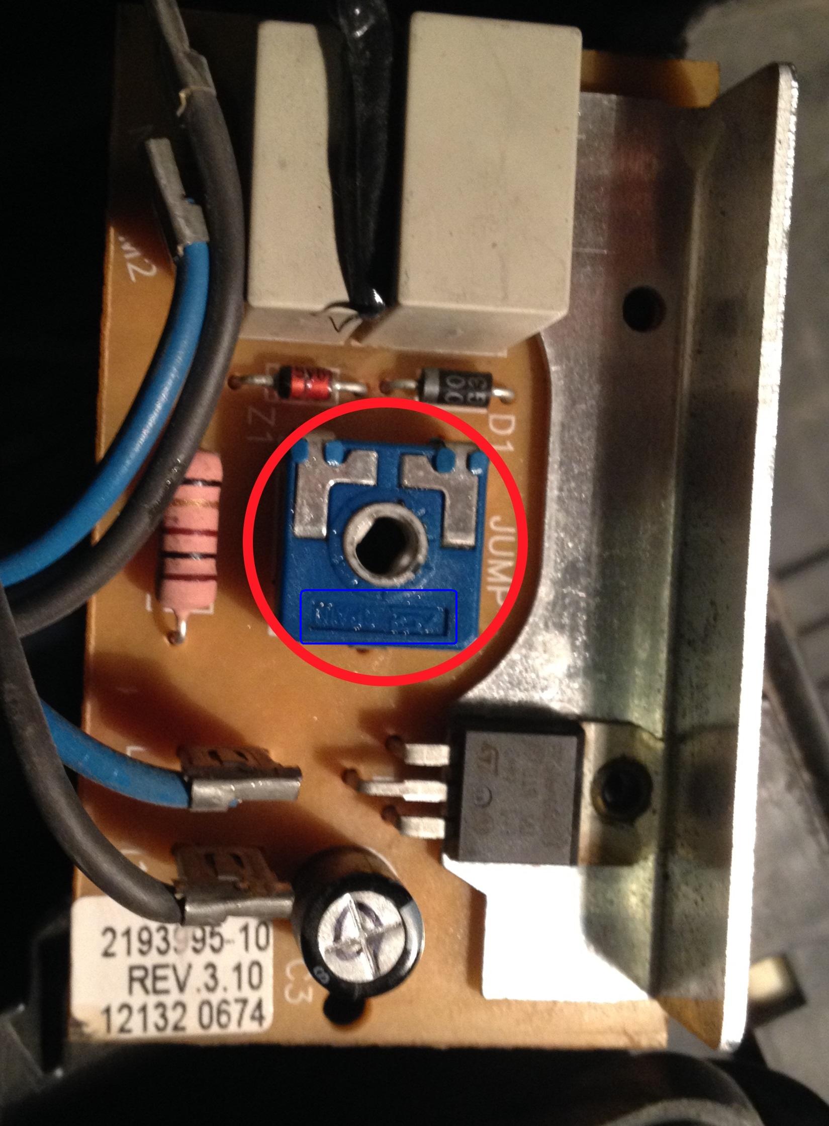

    I need to replace the potentiometer in the speed controller 2193995-10 (marked in the photo) in an Electrolux ZSC69FD2 hoover.
    I have not found its designation anywhere so I am looking for information on what kind of potentiometer it is and whether I can get one somewhere.

    No markings underneath?

    Desolder and measure with an ohmmeter the resistance value between the two upper legs.
    Perhaps there would be more information, something like this: why do you claim that this potentiometer is damaged and needs to be replaced? (description of the fault).
    szycha82 wrote:
    I didn't find his mark anywhere
    The picture is not very clear, maybe this one blue the frame is what you are looking for.
    When adjusting the speed, the engine did not even start - after treating the potentiometer, spray contact catches and gives different engine speeds - that's why it seems to me that the potentiometer is on the side.
    Best regards.
    In the frame you write about is only a tiny logo and the inscription SPAIN.

    No markings underneath.
    I measured the upper 2 legs after desoldering and it is 21.52k?.
    Any ideas where such a potentiometer will get or if it is impossible then maybe some alternative?

    Buy a 22k? potentiometer.

    The question is where to get one - I searched and I can't find one.
    I measured it with a caliper and it's 14mmx14mm so it's ACP series CA14 and I can't find one.
    Then set the "slider" (3) of the potentiometer to the middle position and measure its resistance: 1 (upper left) - 3 (lower), 3 (lower) - 2 (upper right). To initially determine the efficiency of the potentiometer, connect the meter on this principle [(3 - 1), (3 - 2)] by turning the knob we observe the ohmmeter indications.

    3-2 goes from 0.6k to 22.5k (but along the way has from time to time strange jumps to 30k 40k or OL)
    3-1 goes from 21.59k to 0.7k (similarly as above there are breaks ")
    I treated it with contact spray several times because before it was much worse.
    Added after 17 [hours] 58 [minutes]:
    I got this sprayed potentiometer on my contact and sprayed it for a long time - there is a big improvement.
    The only thing is that now the adjustment knob from the vacuum cleaner works from the maximum down but the vacuum cleaner does not turn off - it's difficult, it works.
    Thank you all for your help.

    I had a similar problem and generally repair without initialising this controller may not be successful for the reason that the controller is unprogrammed. .
    So perform the following operations (from the post https://www.elektroda.pl/rtvforum/topic3376681.html#18463298):
    First, with the hoover housing removed, set the minimum potentiometer value, i.e. short circuit to ground, plug the hoover into the socket - it will turn on at full power, turn the potentiometer to maximum and turn the hoover off - the whole action takes 3-5 seconds.
    In this way the board is reset.
    Once reset, set it on the hoover off, immediately after the reset.
    Now put the housing in the knob position at max, the potentiometer is at max (the maximum deviation of the potentiometer is also the maximum power of the hoover),
    insert the knob and pull it to the minimum corresponding to the hoover scale (neither more nor less - just the minimum).
    And now we start the hoover.
    Once the hoover is running and the electronics (softstart etc.) are initialised, everything works as it should.
    If not, the electronics have to be reset again or there is still a fault.
