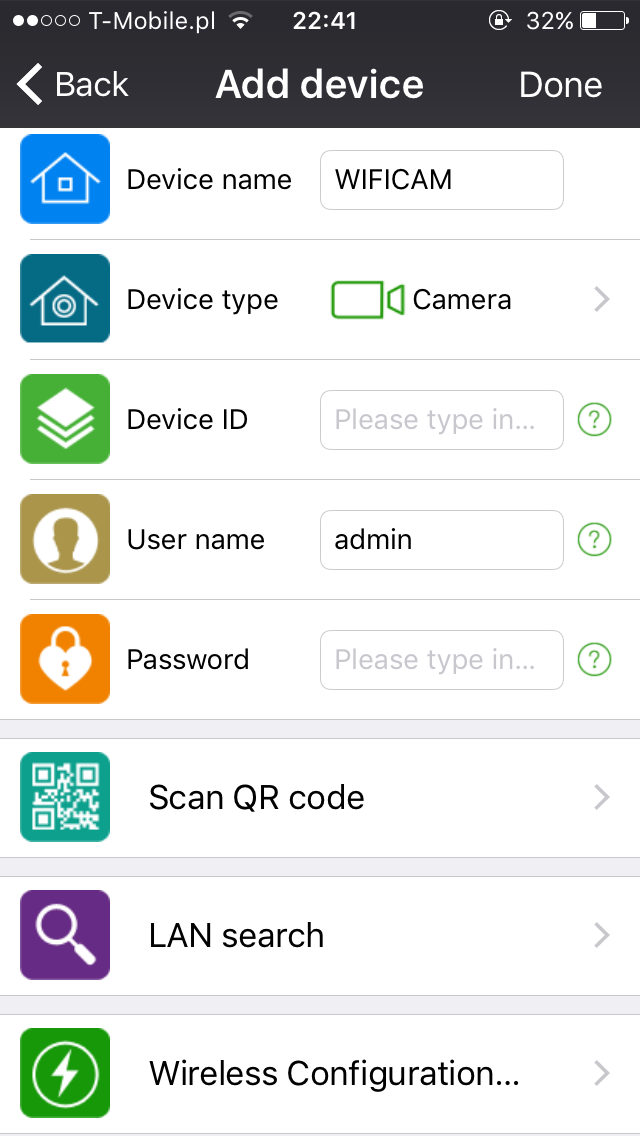

    Today I bought an IP camera, Chinese: "SANNCE" generally everyone praises and I decided to see if it would be useful to me :)
    The problem is the following, I'd like to connect it, but I don't have a permanent connection yet. Is there any possibility to connect it to the internet provided by the phone? I will have a permanent connection in a month and I would like to see if the webcam works at all.
    If you can do it how? I thought it could do somehow connect it to the computer, but it doesn't have any other output for charging.
    Thank you in advance for your answer.

    Unfortunately, the application does not find anything on Android or iPhone; /
    So there is probably no other option than a permanent connection?

    I just don't have. If I need internet for a laptop, I share from the phone. The idea was whether if I would share the internet from Samsung, I would connect to this internet with a second phone on which I have a webcam application, or would I connect to the webcam somehow? Unfortunately, despite the large number of attempts, I can't find the webcam in the application on my phone. I thought maybe there was a way :)

  • #9 16696247
    kolas45
    Posts: 24
    Eh, I have no idea how I can configure it.
    When I run applications I have options as seen there. It scans the QR code from the webcam and its data fill in.
    I can choose either LAN or connection configurations. After clicking on LAN, it does not search for anything for me (phone with the application connected to the internet generated by the second one and connected to the camera), when setting the network, I enter the login and password for the internet to which I have connected the phone and for a minute looks for a connection and finds nothing ... .
    I have no more ideas what I could do there

  • #10 16696501
    sosarek
    Posts: 83875
    Help: 9320
    Rate: 15532
    Enter the login information for the camera in the User name and Password fields ...

  • #11 16696651
    kolas45
    Posts: 24
    Of course I did :) he is still not looking for her
    I contacted the store who wrote back to me: "Sorry, it can not.
    camera must connect to 2.4Ghz wifi to work. "
    So I understand that there is no way around it :(
    I hope it will be useful to someone :)
