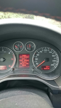

    for some time, every time I start the car, a message pops up:
    Turning Off Start-up Message in A3 8P Manual using VCDS Software and 6-speed Transmission
    How can I turn it off? I have an interface with VCDS software. The car has a normal transmission, a 6-speed transmission.

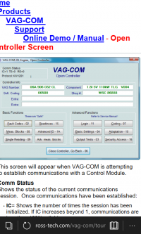

  • #4 16697258
    grala1
    VAG group specialist
    Posts: 9824
    Help: 1496
    Rate: 5053
    You connect to the meter, i.e. choose the address meter 17.
    Later, when it connects, it will show you the meter number 8P0920xxx, VIN number of the car and below on the right you can choose something like coding (address 07). You choose coding and change what I wrote earlier there, before changing what you write there.
    Below is an example, but in English, the addresses are identical, Coding [07] and the current coding can be seen on the top left, Soft Coding, VAG Number is the driver number with which you connected and there you should see No. 8P0 920 XXX and in these empty windows below you will see VIN of the car.

  • #7 16697956
    leonbak
    Posts: 190
    Rate: 27
    I mean, I just want to delete this message which is in the picture in the first post
