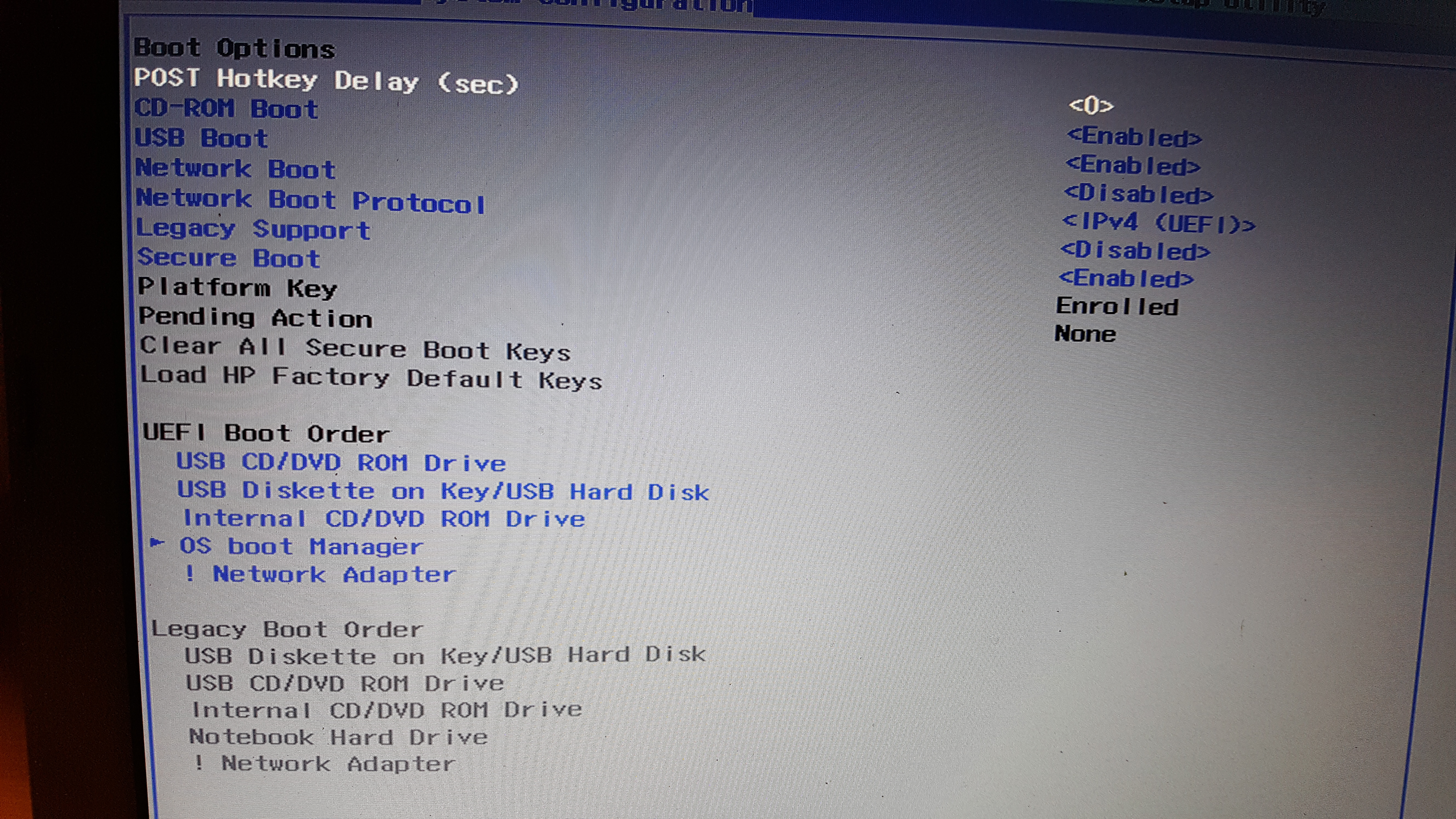

    Hello. I can not cope with changing the system and that's why I am asking for help. I have bought an HP 250G5 Laptop with a wine system installed 10 years ago. I do not like this system very much and I wanted to change it to win 7. As I have never had a problem with it, now I can not move. He does not see the pendrive or the disc in the drive. Probably the problem lies in the bios settings, I am so aware of this on average, the more so because I do not know English. Please help as much as possible. Thank you in advance.

  • #2 16763467
    dt1
    Admin of Computers group
    Posts: 48244
    Help: 7315
    Rate: 8291
    Welcome. When installing Windows 7, it's worth trying:
    Secure Boot: Disabled
    Legacy Support: Enabled
    USB Boot: Enabled
    When booting, select the boot menu (most of the HP is the F9 key) and select the media with the system installer. If there are two items describing the same carrier, it is worth trying to select the item without the UEFI addition.

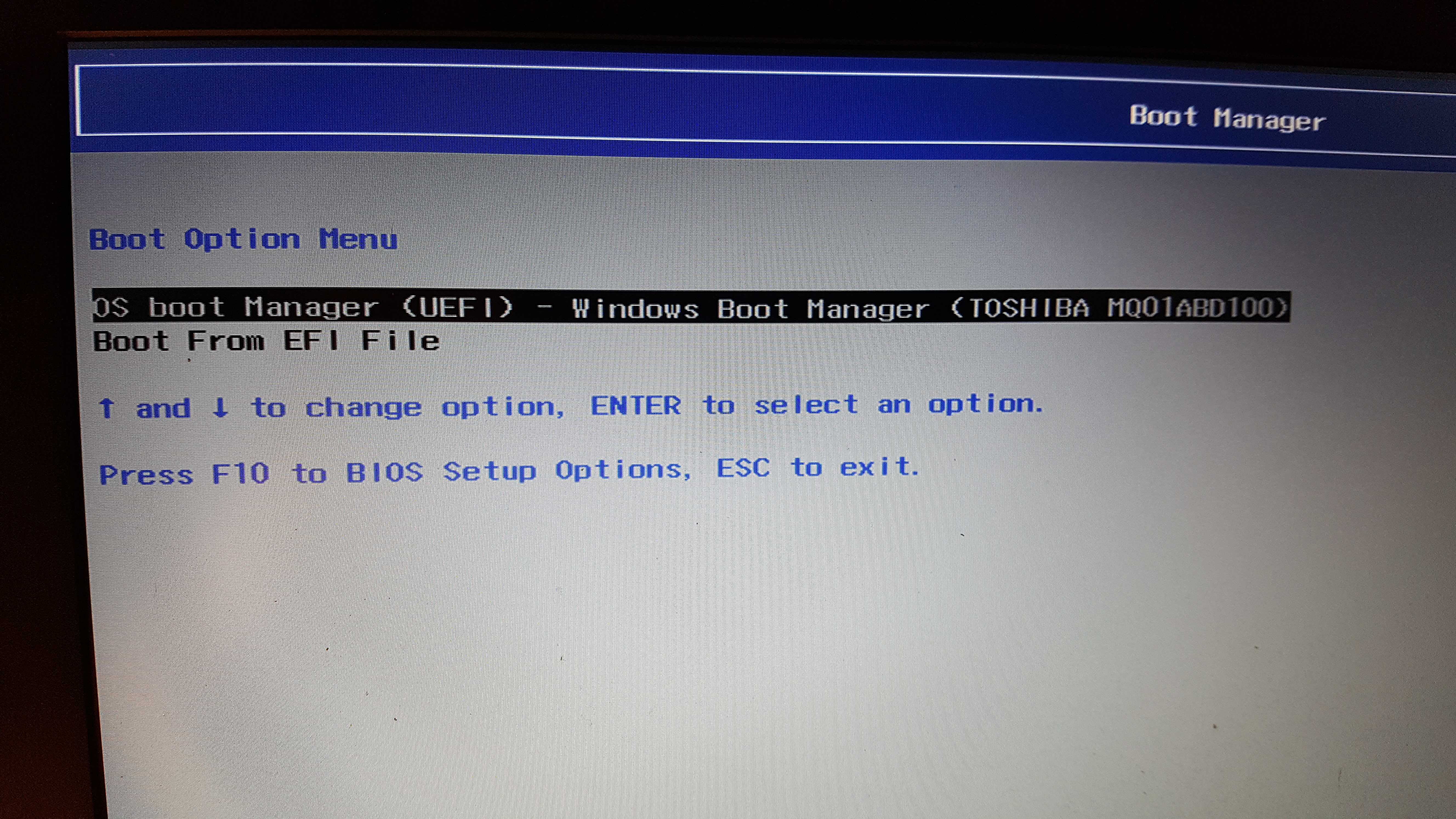

    Well, there is no medium in the menu
    • Transitioning from Windows 10 to Windows 7 on HP 250G5 Laptop: BIOS and Drive Issues 20171017_230457.jpg (3.6 MB) You must be logged in to download this attachment.

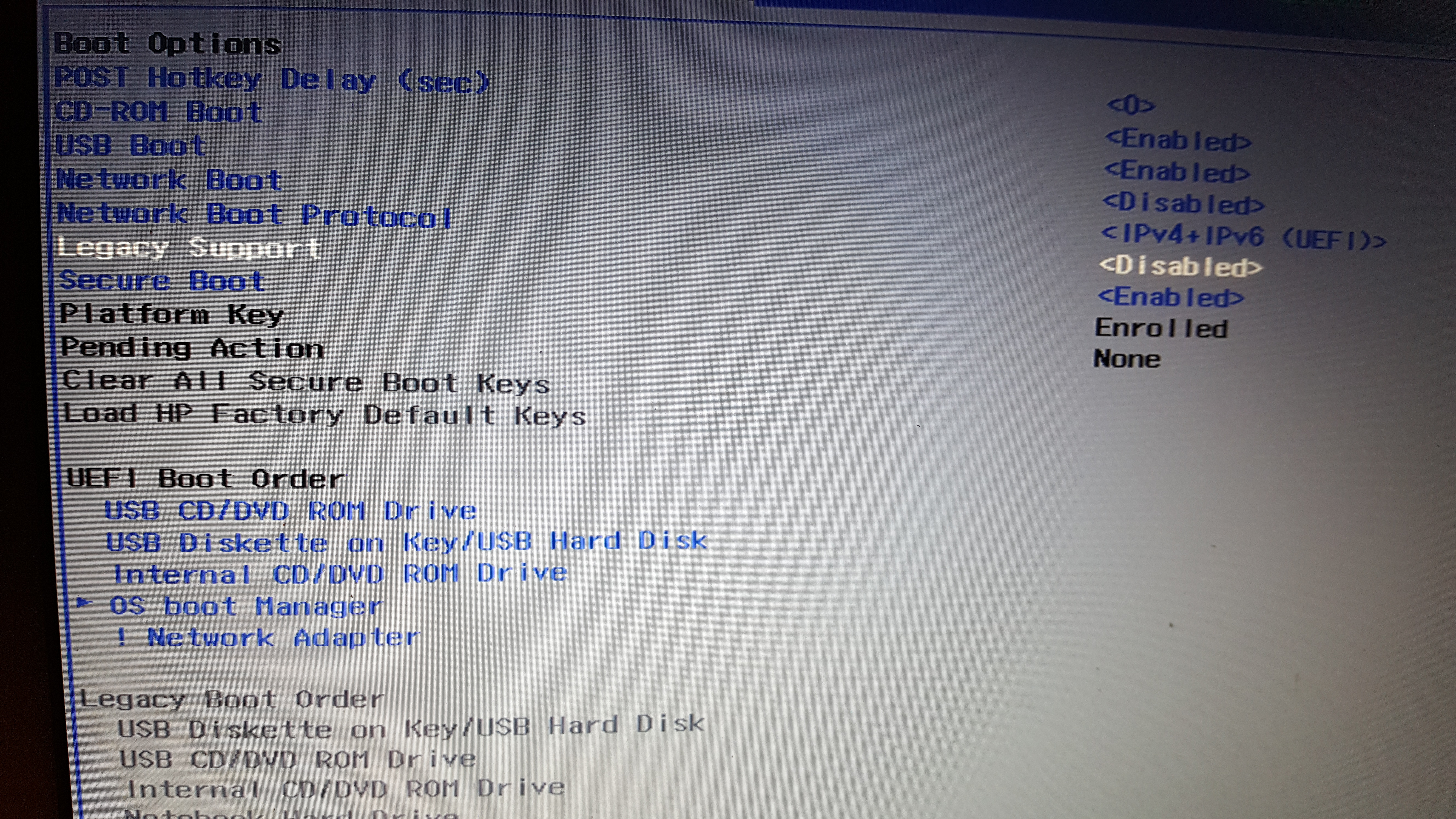

    F9.
    I'm sorry I have to finish today. Tomorrow, early to work. I will come back tomorrow with the theme. greetings
    • Transitioning from Windows 10 to Windows 7 on HP 250G5 Laptop: BIOS and Drive Issues 20171017_231402.jpg (7.54 MB) You must be logged in to download this attachment.
  • #6 16763592
    dt1
    Posts: 48244
    Help: 7315
    Rate: 8291
    If this pendrive is connected (and functional), it looks like the option Legacy Support was turned off. I hope you saved your changes after they were introduced?

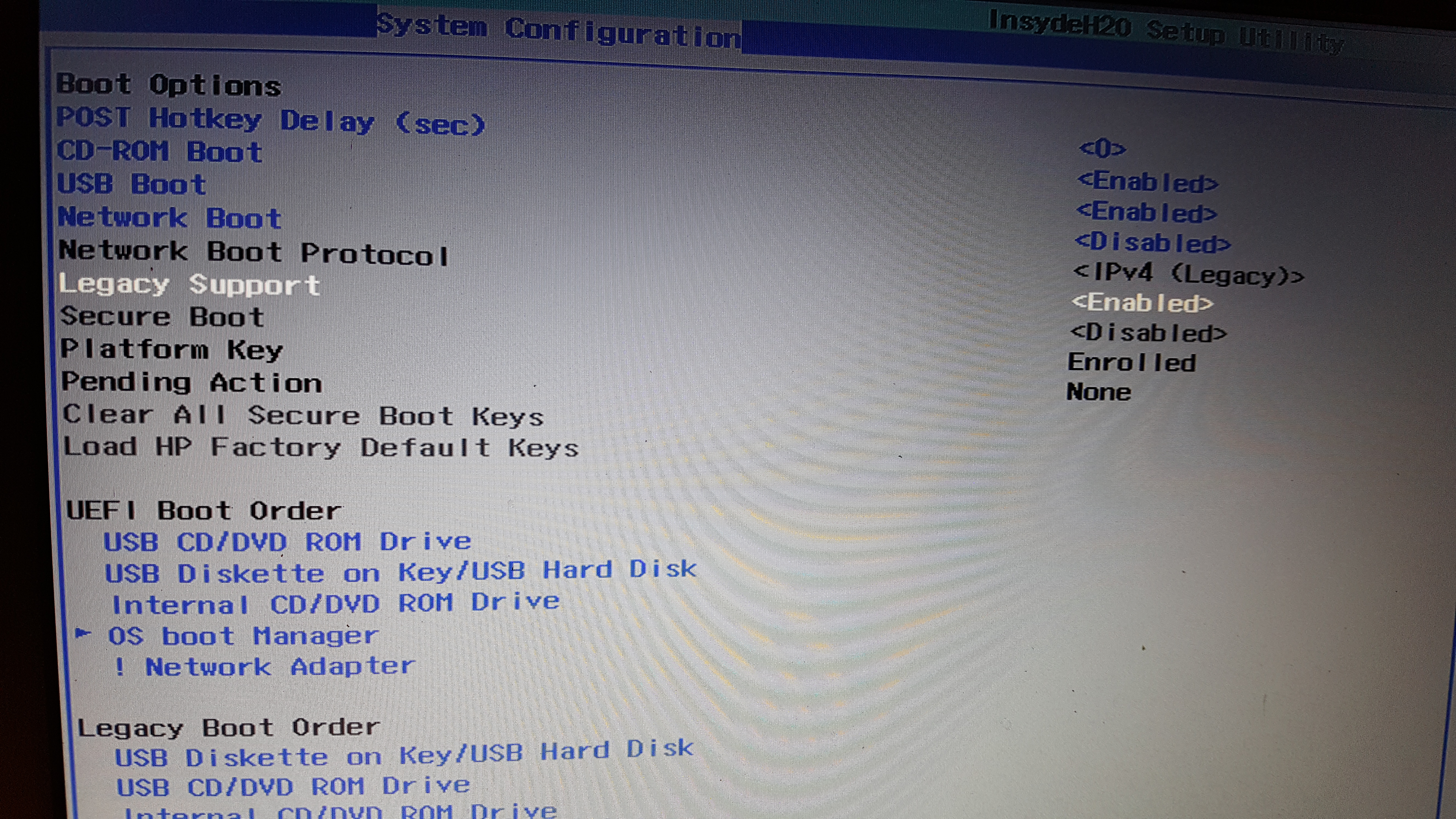

  • #7 16764751
    zbyh 62
    Posts: 314
    Rate: 57
    After confirming the changes, he was constantly returning to disabled, I had to enter the code 0123 and enter, only the drives showed up.
    a change to the operating system. secure bot mode is pending.
    please enter the pass code displayed below to complete the change
    if you did not initiate this request, press the key to continue without accepting the pending change
    When installing the system I had to change the disk from GPT to MBR and for now everything is going well,
