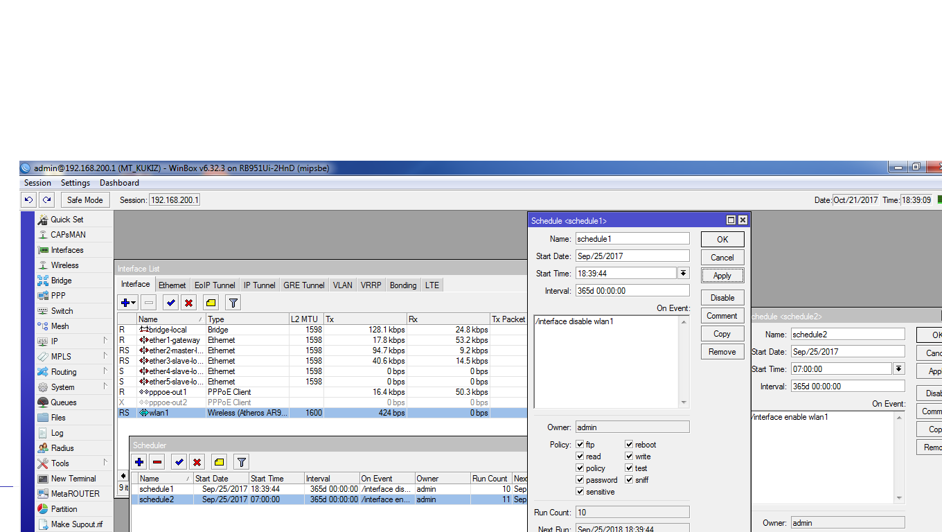

    I think something is wrong. It only works for me once. One day after adding. Nothing turns off for the next one.

    Interval is set to 0 so it will only run once.

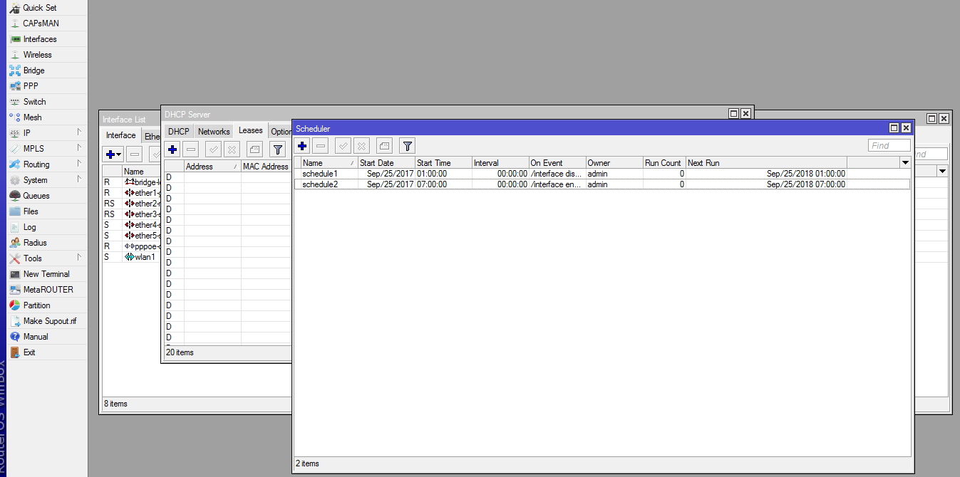

    It still doesn't work for me. I do not know what's going on. Can someone take a look at the settings?

    There he writes that intervał is 365 days, it should turn off once a year?

    when I was at 0, I was told it would only be done once. It added more. WHAT should I set? "1"?
    how is it supposed to fuck every 1 day it
    1d 0: 0: 0
    And you were told well, but this forum is not just a roller coaster, _Y_ you must think too.
    Try to test yourself, on / off where interval = 0d 0: 10: 0

    Okay, I put it on 1 and it works :) In general, I know Mikrotik a bit, but this was my first time with the scheduler. Thank you for your help.
