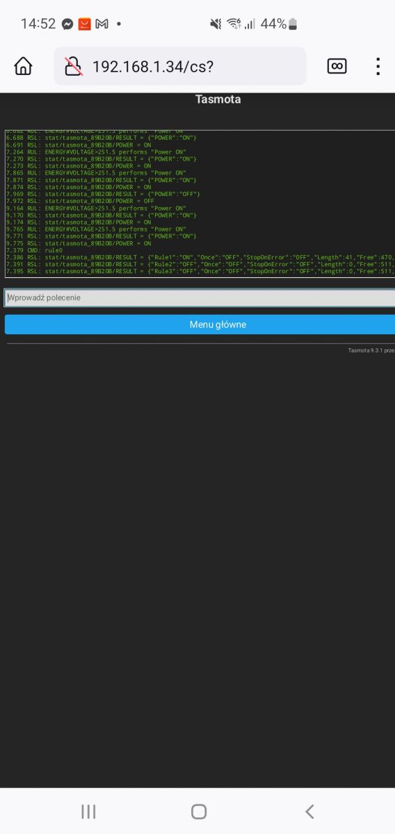

    Hello, does anyone of you have a Tasmota socket for voltage reduction and can help me with the scheduling? I have set up a dependence that at a given voltage the device switches on, (to reduce voltage for photovoltaics) I would like to set up a schedule so that on one particular day the socket does not switch on at all, regardless of whether it exceeds a given voltage threshold, I have set up everything as in the video, I have chosen a particular day of the week and hours at which it should switch off, but it still works normally. Does anyone know if it is possible to set a shutdown schedule here if there is an over-voltage switch on? Thanks for your answers ;)

    xury wrote:
    I recommend studying https://tasmota.github.io/docs/Commands/
    Using rules you can do a lot of things:
    https://tasmota.github.io/docs/Commands/#rules
    If you want to disable the timer then read https://tasmota.github.io/docs/Commands/#timers
    I can't quite understand what it is about which command I have to enter to achieve what I want, could you help me how to do it with my example ?

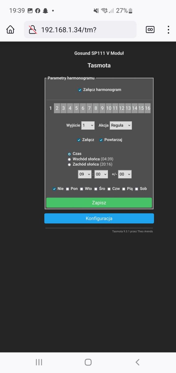

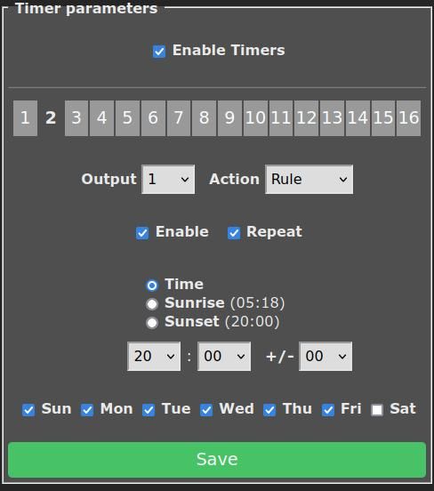

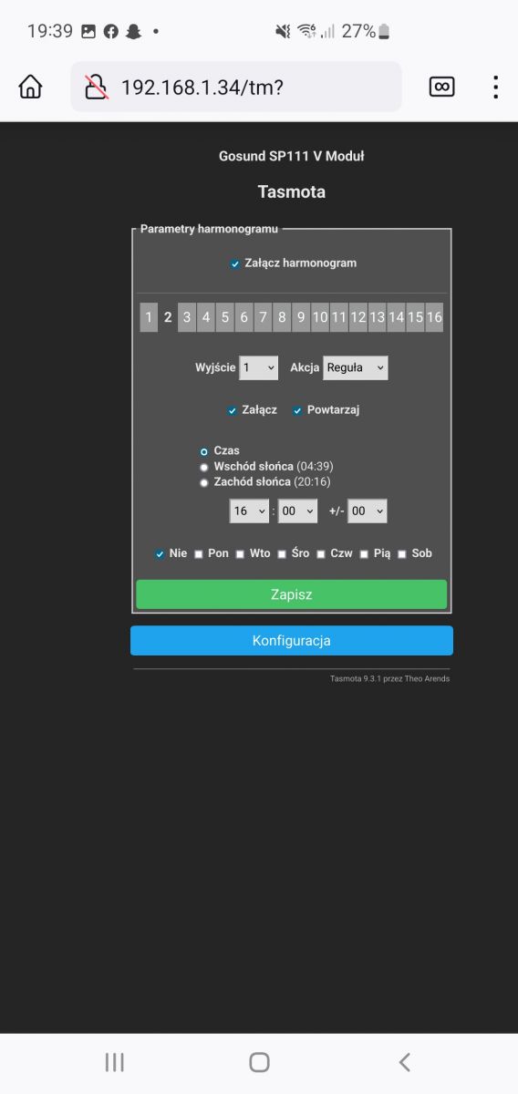

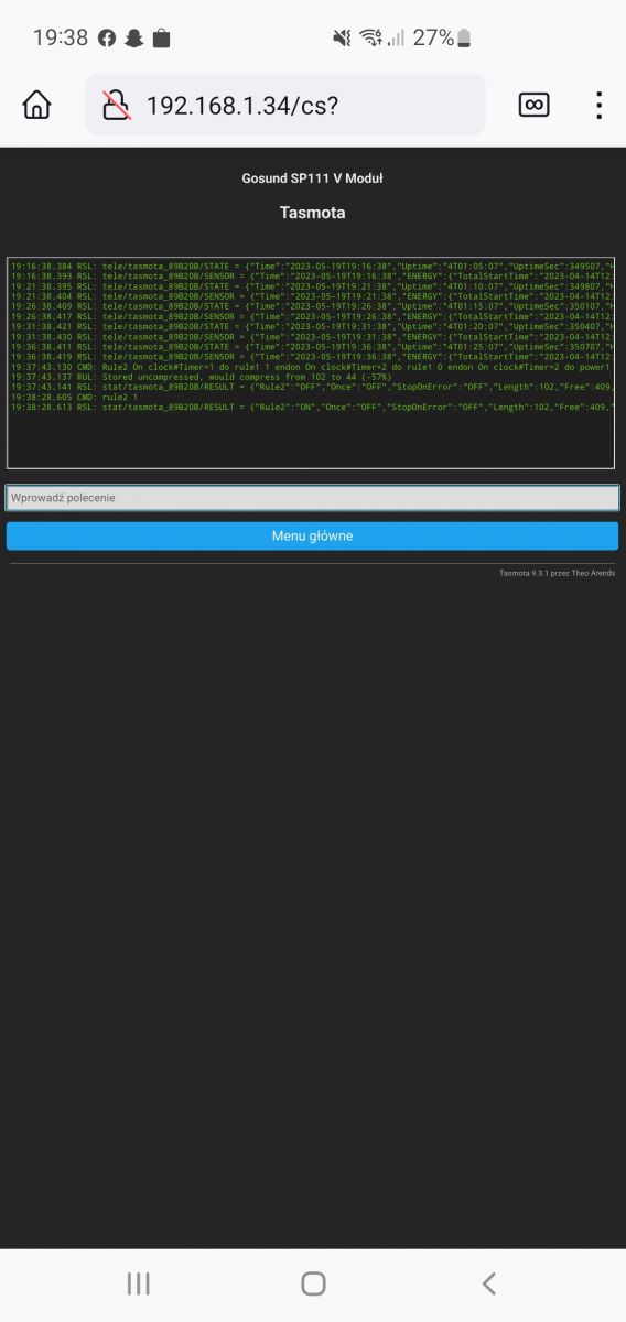

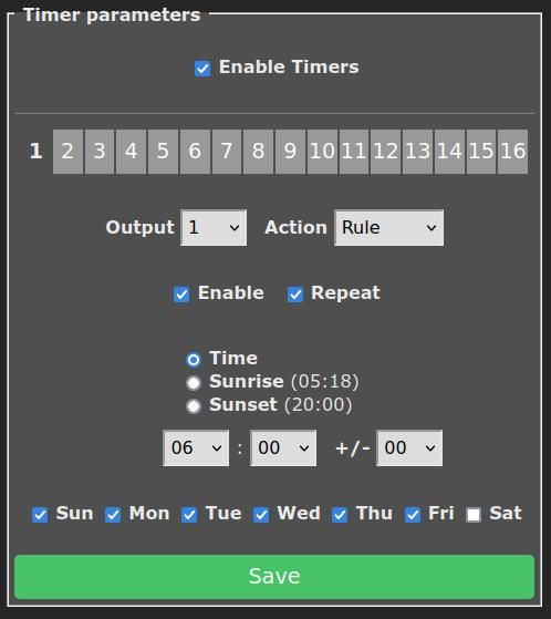

    First make a backup of your configuration, in case something goes wrong you can restore it. You have a rule 1 set up which controls the socket based on voltage. We will create rule 2 which will turn rule 1 on or off depending on the timers setting.
    Set Timer 1 which will switch rule 1 on
    Tasmota socket: Voltage reduction, schedule setting and dependence on voltage thresholds
    Set Timer 2 which will switch rule 1 off
    Tasmota socket: Voltage reduction, schedule setting and dependence on voltage thresholds.
    Then in the console write rule 2
    Rule2 On clock#Timer=1 do rule1 1 endon On clock#Timer=2 do rule1 0 endon On clock#Timer=2 do power1 0 endon
    and turn it on
    Let us know if it works

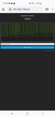

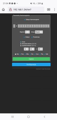

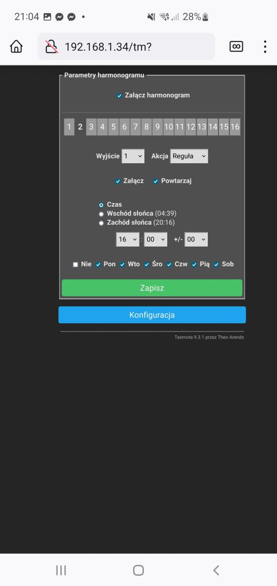

    Sorry it took me so long to write, but I thought I would not have to use these schedules and yet...
    I have done as you wrote. (I think I marked well, could you check?) I want the socket not to work only on Sundays from 9-16. I will let you know on Sunday when the sun will be sunny whether it works, I attach screenshots if you can see if I set it right. Thank you. Tasmota socket: Voltage reduction, schedule setting and dependence on voltage thresholds Tasmota socket: Voltage reduction, schedule setting and dependence on voltage thresholds Tasmota socket: Voltage reduction, schedule setting and dependence on voltage thresholds Tasmota socket: Voltage reduction, schedule setting and dependence on voltage thresholds .

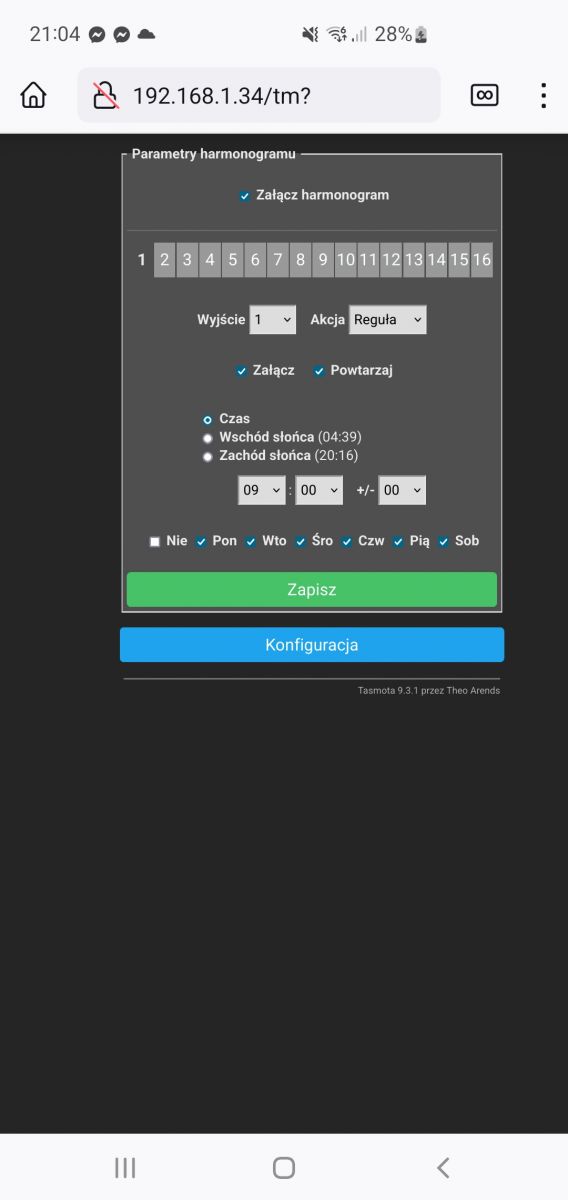

    In the schedule, you mark the days when the socket should operate and at what times, so you must mark all days except Sunday.

    raks0 wrote:
    In the schedule you mark the days when the outlet is supposed to work and at what times, so you have to mark all days except Sunday.
    Is it ok now ?
    Is these two commands typed again ? Tasmota socket: Voltage reduction, schedule setting and dependence on voltage thresholds Tasmota socket: Voltage reduction, schedule setting and dependence on voltage thresholds .

    grzesiekc33 wrote:
    Is it good now ?
    We'll see on Sunday.
    grzesiekc33 wrote:
    And these two commands enter again ?
    We only enter the commands once, now everything graphically in the schedule

    Well it works, only the hours didn't match because it was already out of order from the morning, not as set from 9 ;) but it's ok. THANKS ;)

    raks0 wrote:
    In the schedule you indicate the days when the socket should operate and at what times
    According to your schedule, the socket will operate between 9 am and 4 pm on Monday to Saturday. On Sundays, the outlet will not operate at all regardless of the hour.
