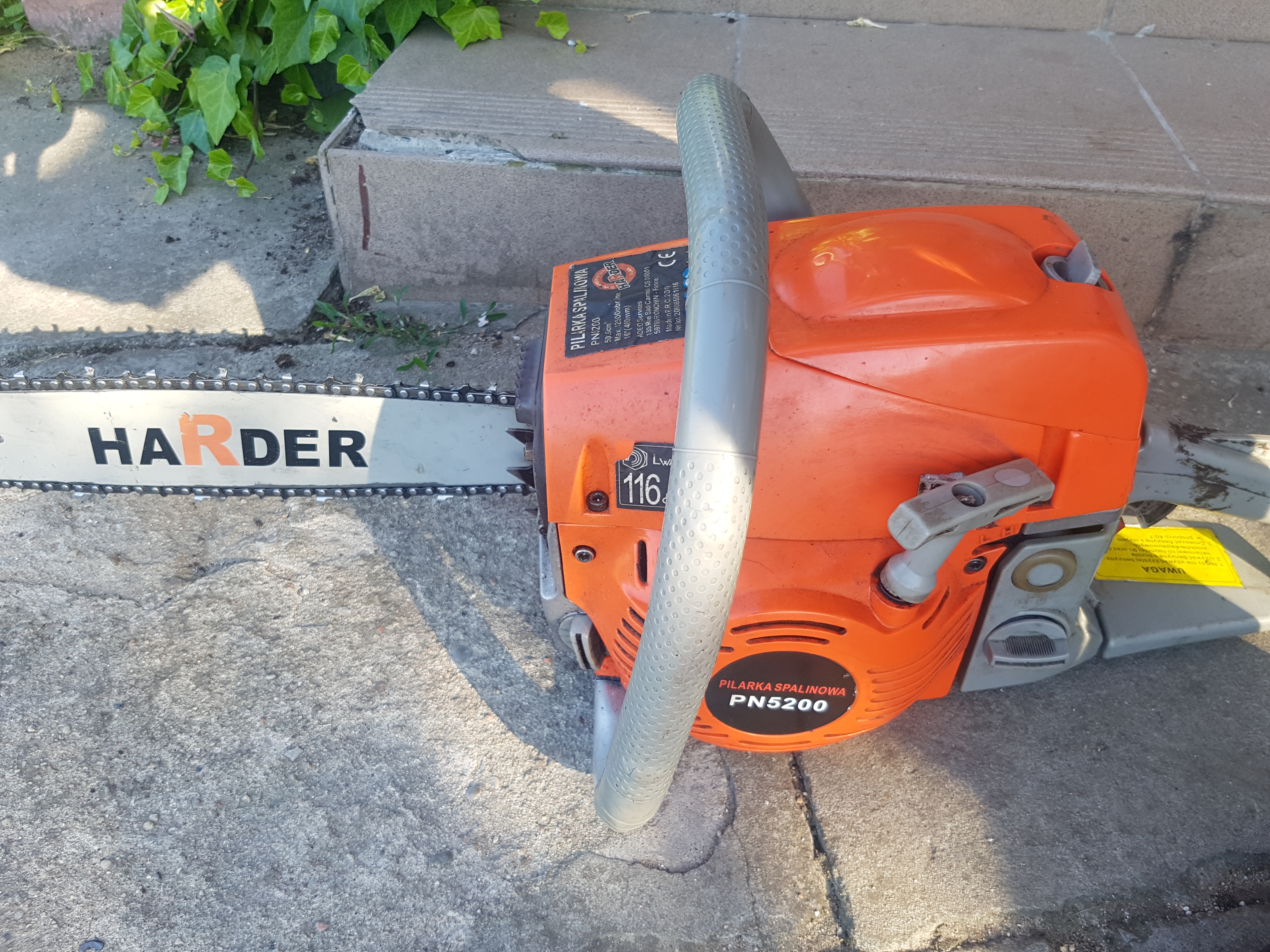

    Hello. I have a problem about it. The saw will fire, but if I add gas, it goes out. I cleaned the carburettor and even the suppressor. What could be the reason for this? Can anyone help?

    If the saw goes out, the candle is wet or dry, working normally at idle?

    Well, just how I start it starts to walk at high speed and then it gives gas that goes out

    So the problem with fuel, the hoses whole adjustment screws L 1 and 1/4 turn; H 1 and 3/8 set?

    You did not answer whether the candle is dry or wet after the engine is "going out". In my opinion, a carburetor for inspection (removal of impurities) and regulation. Also check the purity of the dragon filter in the fuel tank.

    This is the Harder PN 5200 saw. The candle is wet. So what do I have to do ?? clean the gas stove? or maybe someone would do this to me, that I would pay for checking and doing it

    First, replace the spark plug, tighten the carburettor to the cylinder (if the gaskets are full), adjust the adjustment bolts according to the instructions.
