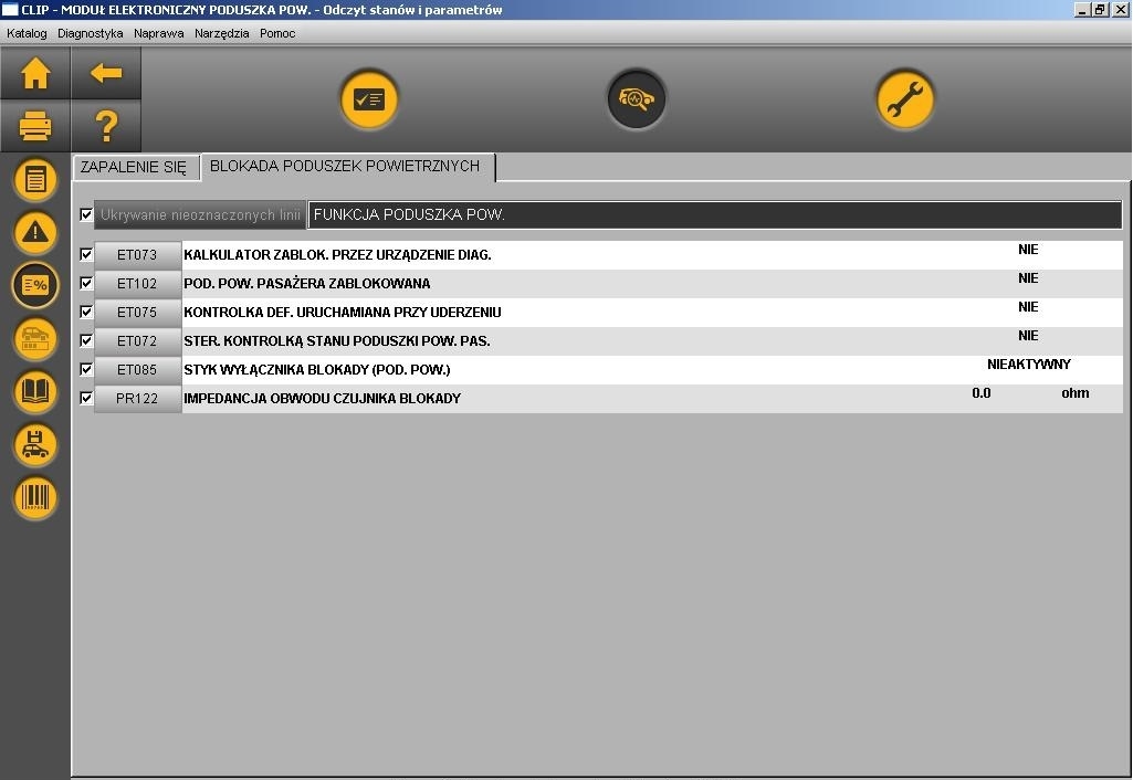

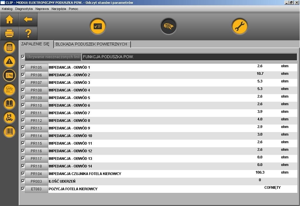

  • #12 16716816
    tomas1261
    Posts: 25
    Screenshots from the AirBag module
    AirBag Laguna II 1.9 DCI Dynamique: Dashboard Indicator Light On, Replaced Components & Solutions AirBag Laguna II 1.9 DCI Dynamique: Dashboard Indicator Light On, Replaced Components & Solutions AirBag Laguna II 1.9 DCI Dynamique: Dashboard Indicator Light On, Replaced Components & Solutions

    janek-krzysiek
    Posts: 12
    I would still try to look for an option that allows you to control the steering wheel lock with a computer and see if it can be done.

  • #16 16717208
    kamiloskop
    Posts: 555
    Help: 42
    Rate: 279
    See in the parameters you have the passenger airbag blocked. I'm wrong, correct me
