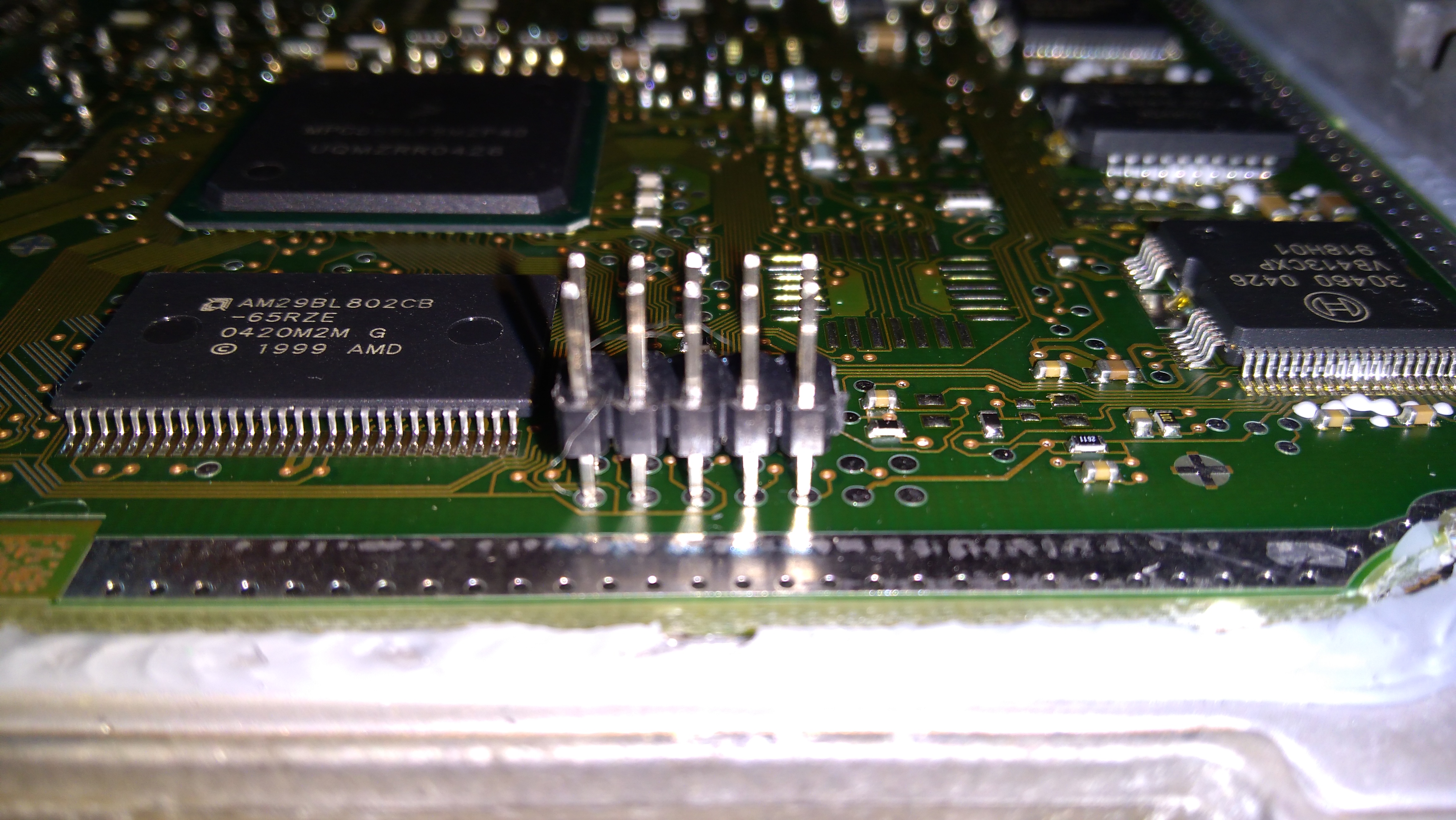

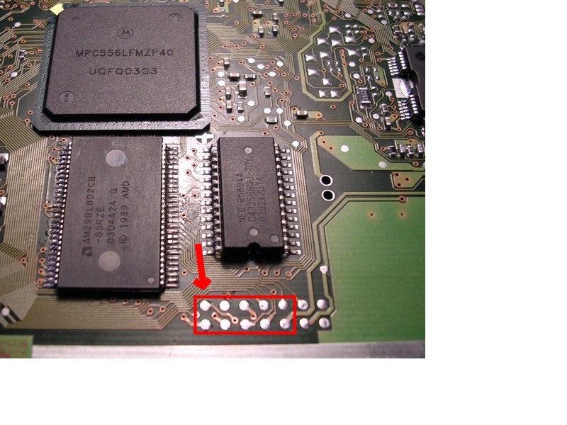

    Hello, I am looking for a diagram of how to connect the BDM 100 to the ecu edc16c34, I found such a picture, is it correct?
    • BDM 100 Connection Diagram: Correct ECU EDC16C34 Wiring Guide for BDM100 Interface xxp1000904_210.jpg (91.37 KB) You must be logged in to download this attachment.

    Correctly, if the threshold is functional, it should start. Each EDC16 connects like that. I just don't know if the BDM100 gives power on the tape or if you need to put it on the pins in the ECU.

    your picture bad connection, it should be like this, red arrow pin 1, tape with a red stripe also pin 1
    the power goes through the port, no need to power the driver.
    BDM 100 Connection Diagram: Correct ECU EDC16C34 Wiring Guide for BDM100 Interfacebdm edc...jpg (144.33 kB)You must be logged in to download this attachment.

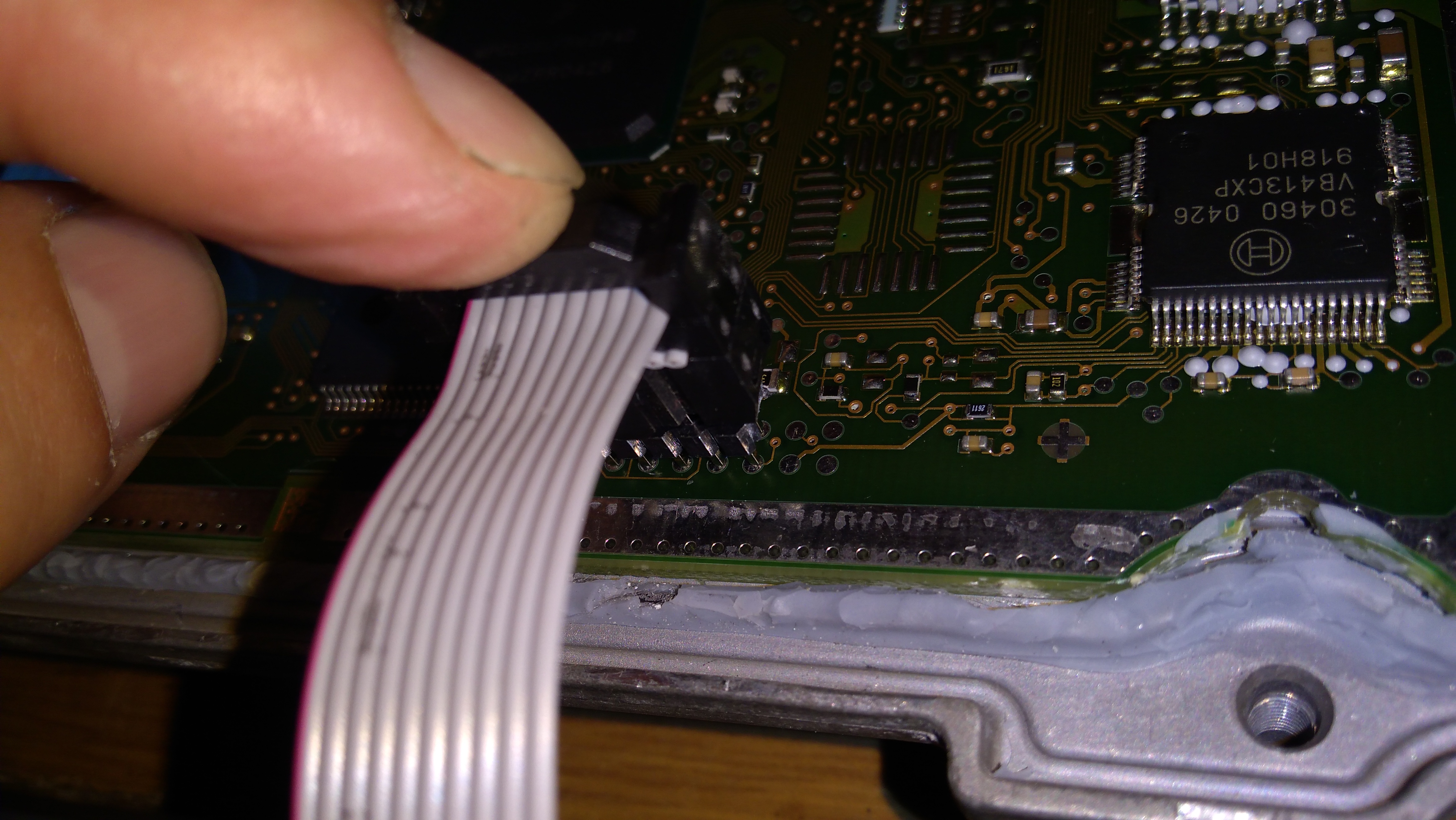

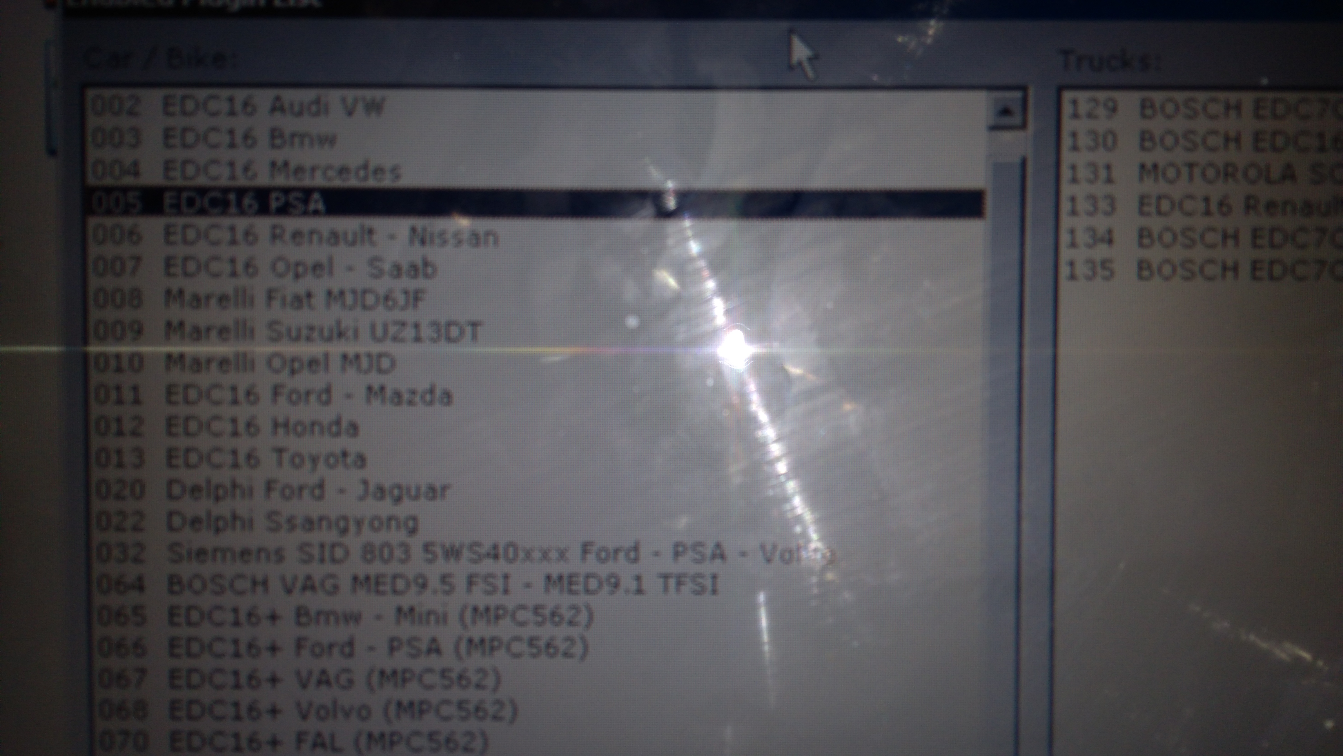

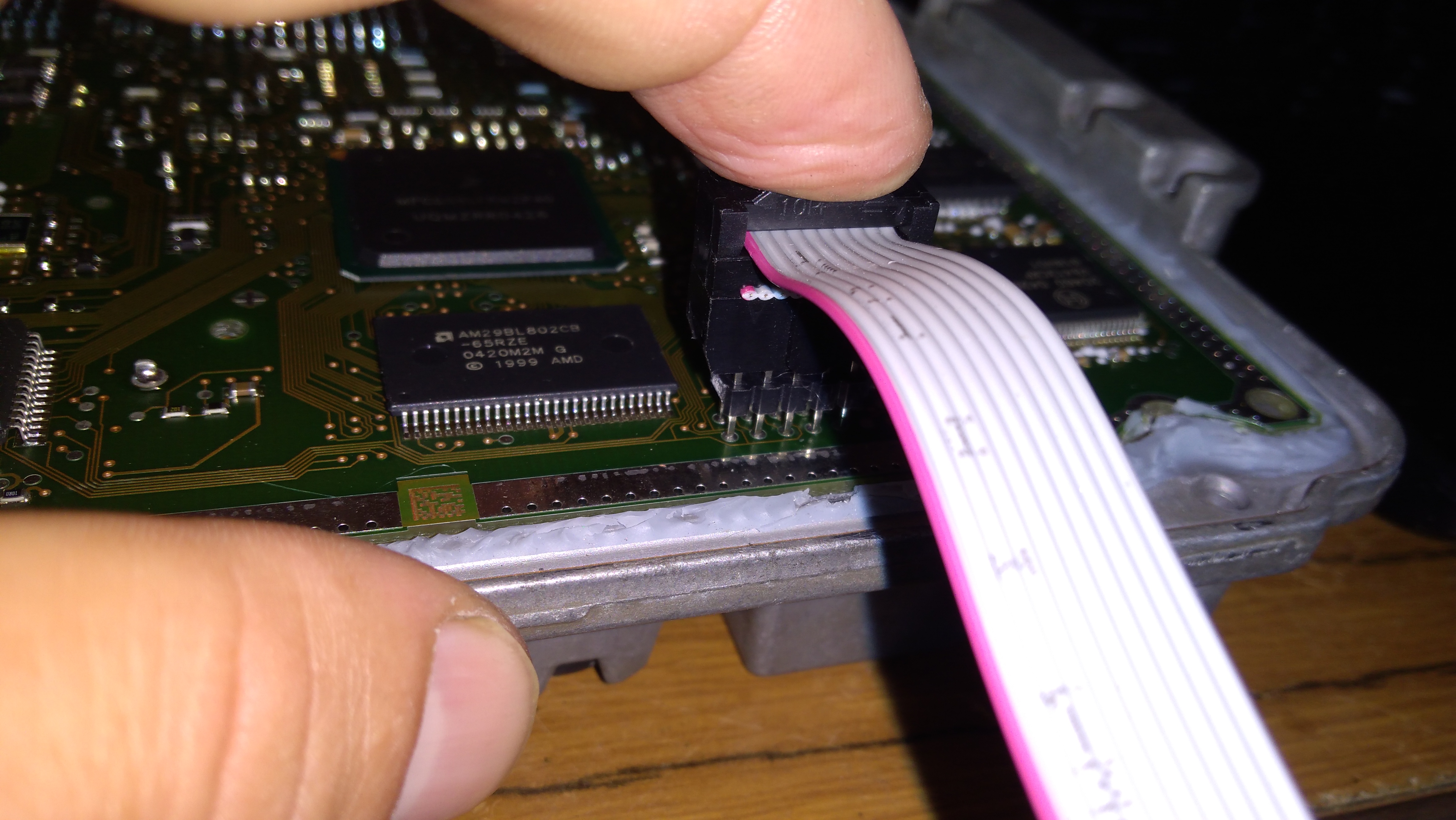

    I don't want to burn the next driver, will it be okay as I have in the pictures?
    • BDM 100 Connection Diagram: Correct ECU EDC16C34 Wiring Guide for BDM100 Interface IMG_20170927_122818.jpg (2.77 MB) You must be logged in to download this attachment.

    it's good, only the first picture, after connecting bdm should identify the driver from the machine, so it should not show this window anymore.
