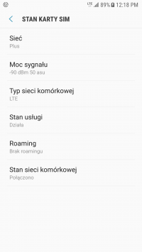

    I have a problem with Samsung Galaxy S6 FLAT, when my mobile data is off, the phone connects to LTE + and has a very poor range.
    If I turn on cellular data, LTE + appears and very weak range and after a while switches to LTE and is full range, but if I have switched off cellular data, the phone should maintain LTE + connection.
    The phone is on the PLUS network.
    Network in the StandBy state:
    Samsung Galaxy s6 - The phone has a poor range, connects to LTE + and loses cove
    Network when I turn on cellular data:
    How the network will switch to LTE:
    There was no such thing before.
    I am asking for help with solving this problem.

    And now, as I have switched off the cellular data and enter the settings -> Device information -> Status-> SIM card status and I write to it "LTE cellular network type" Should this be the case or should be switched to (UMTS). There is no LTE, 3G sign on the notification bar because the cellular data is turned off. Samsung Galaxy s6 - The phone has a poor range, connects to LTE + and loses cove
    If someone has a SAMSUNGA GALAXY S6 (preferably with a PLUS card) then I would ask him to check if he has LTE in these SIM card parameters (Of course without mobile data enabled).

    PitiStewart wrote:
    How do I turn off the cellular data and enter the settings-> Device information-> Status-> SIM card status and I write to "Type of cellular network LTE" Is this the way it should be
    Here he shows you what you have set and not what network is connected to.

    leonov wrote:
    It's just that if I change to 3G or just fall into such a network, UMTS shows up there.
    I only mean if the phone with no active cellular data should maintain the connection with LTE 2100 MHz (This is probably LTE +)
