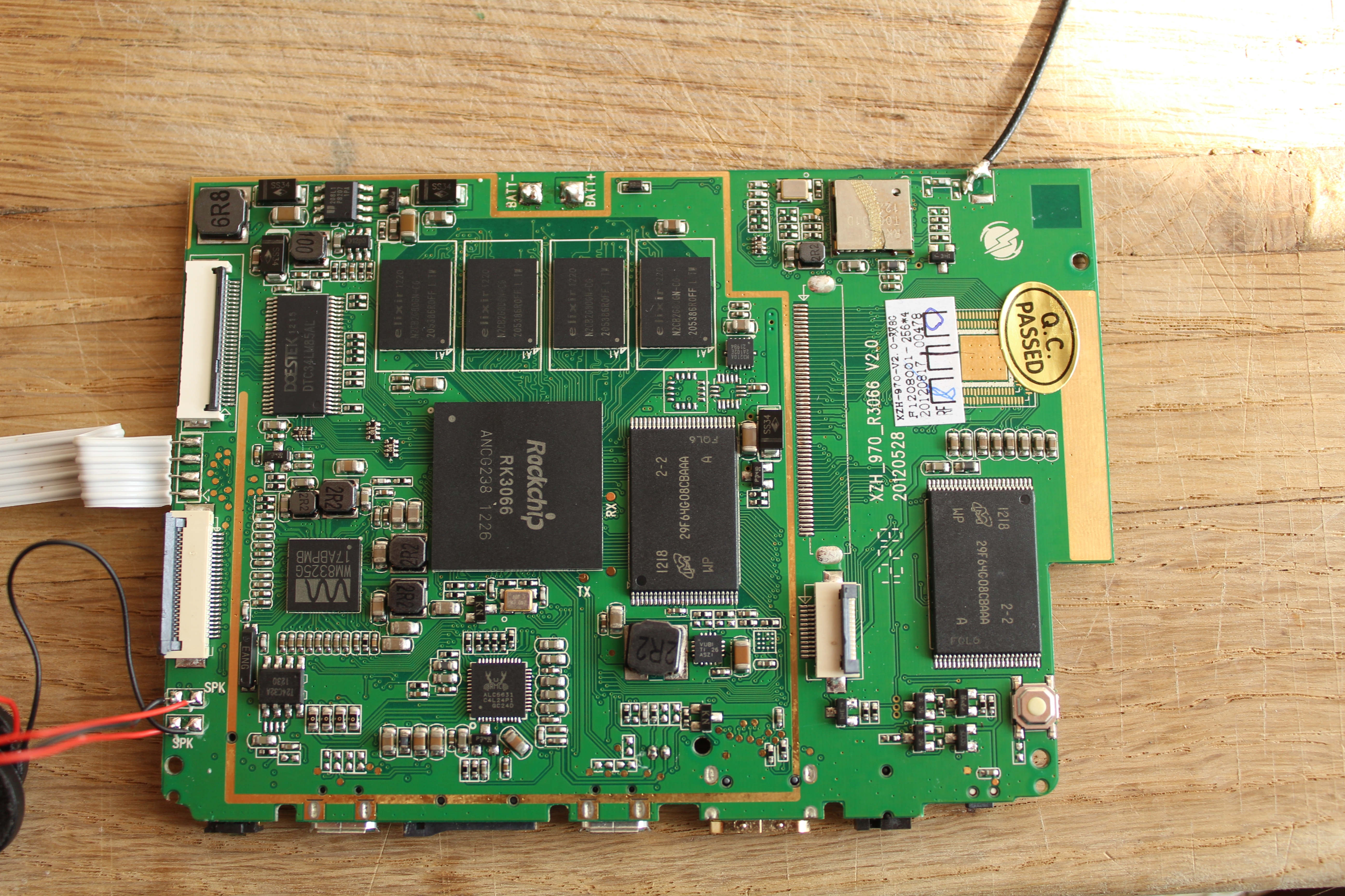

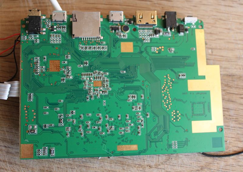

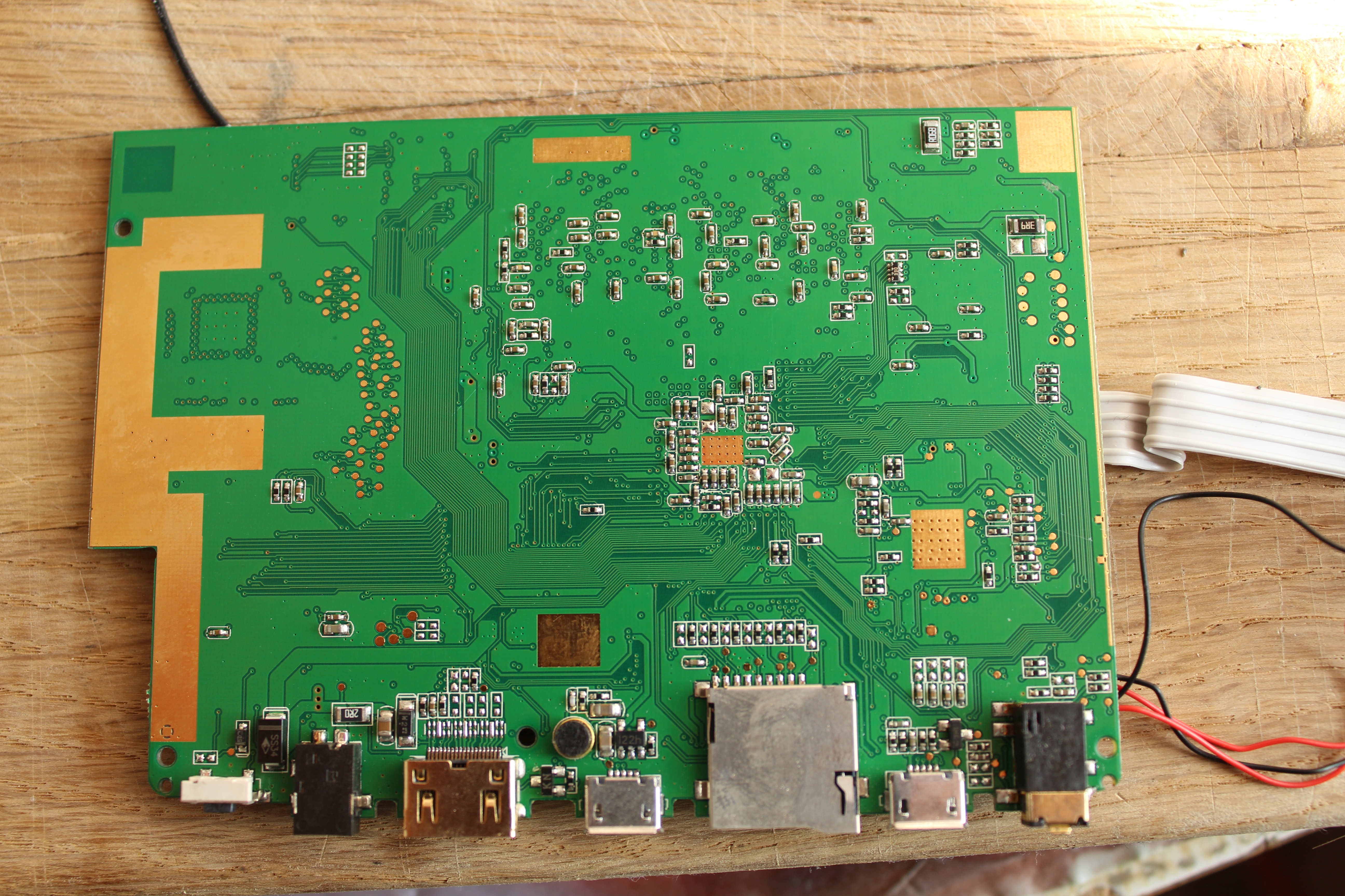

    Hello. I have a problem with a Kiano tablet, the device does not want to charge the battery on a connected charger. It turns on only on the charger for a moment and then turns off immediately. I took apart the tablet and measured the voltage on the 4.7V battery. After switching on, it squeaks all the time to connect the charger. Maybe anyone has any idea?

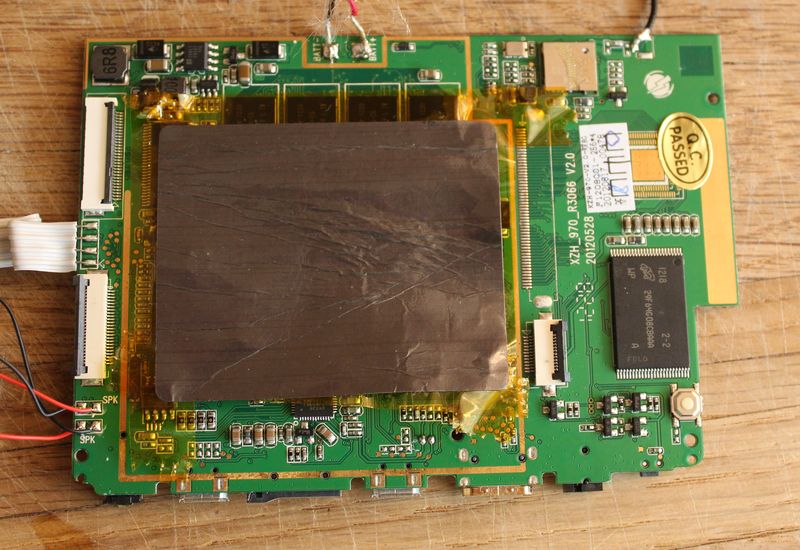

    Peel off this cover so that the electronics can be seen and add clear photos in high resolution.
    Of course, you connected the power supply to the power socket and not to one of the USB from what I remember, some KIANO models only charge the battery from the power socket. And the USB sockets are HOST USB and the other separate is the OTG socket.

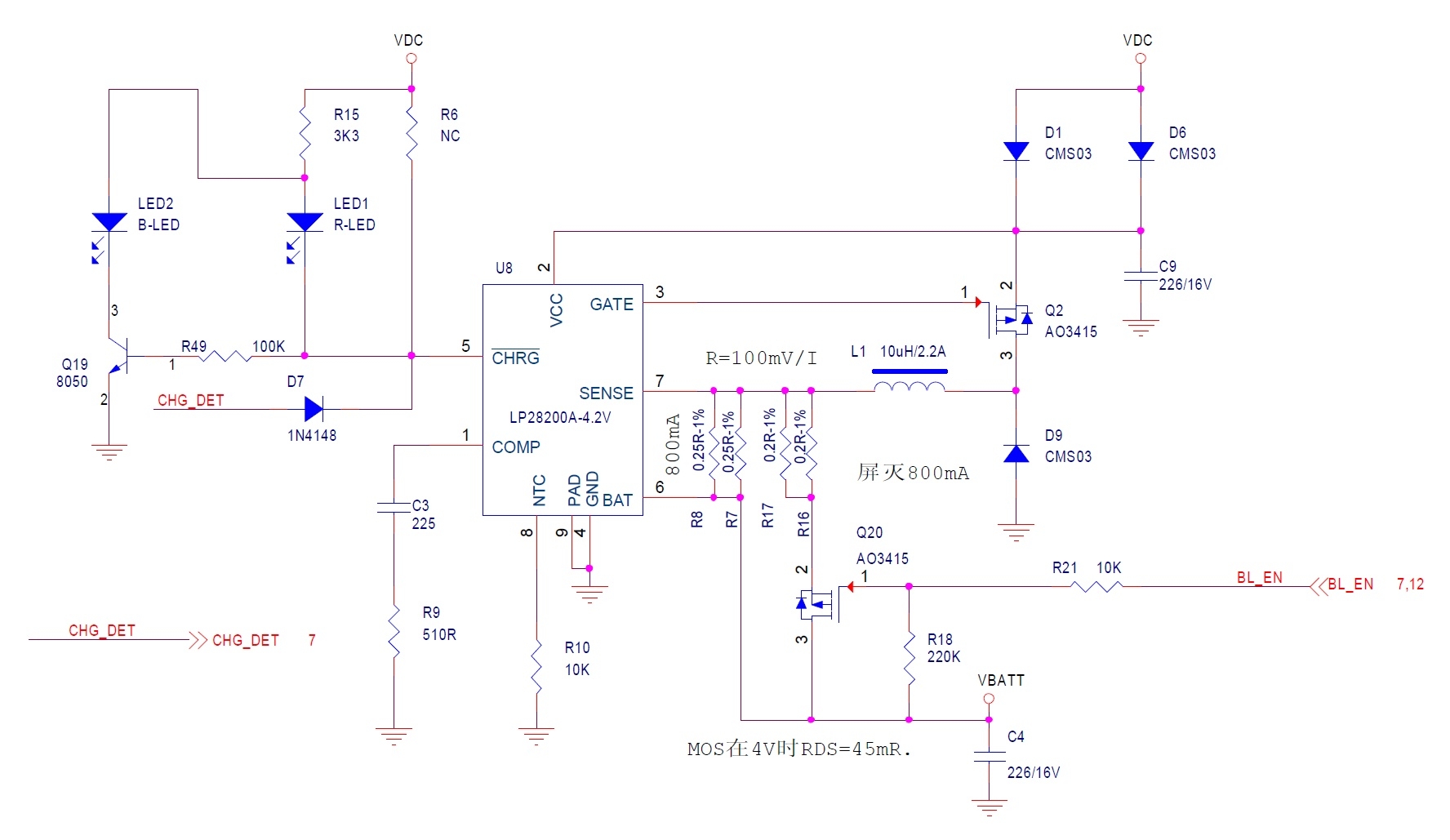

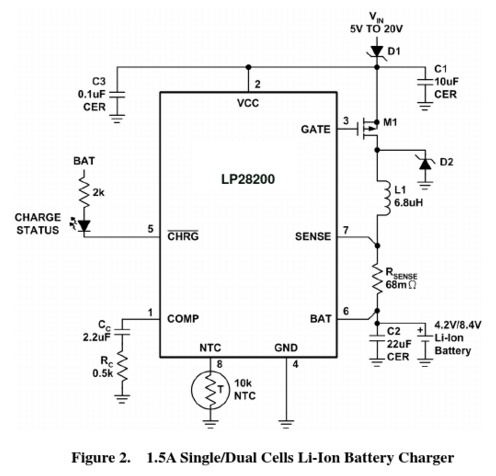

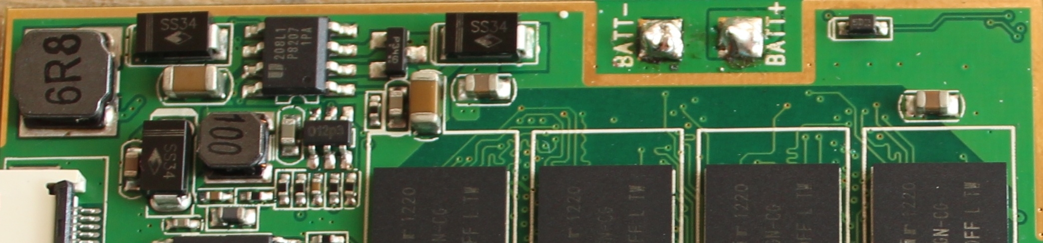

    Check the charging system
    EUP8207
    Kiano Tablet Charging Issue: Turns On Briefly, Battery Voltage 4.7V - Seeking Solutions
    Wide supply voltage range:
    4.8V to 20V - 4.2 version
    Other designation of the LP28200A system
    • EUP8207.pdf (649.55 KB) You must be logged in to download this attachment.
    • LP28200.pdf (833.4 KB) You must be logged in to download this attachment.

    I measured the voltage according to EUMP 8207 diagram,
    1- 0
    2- 5.14V
    3- 5.14V
    4- GND
    5- 0
    6- 0.25V
    7- 0.25V
    8-0

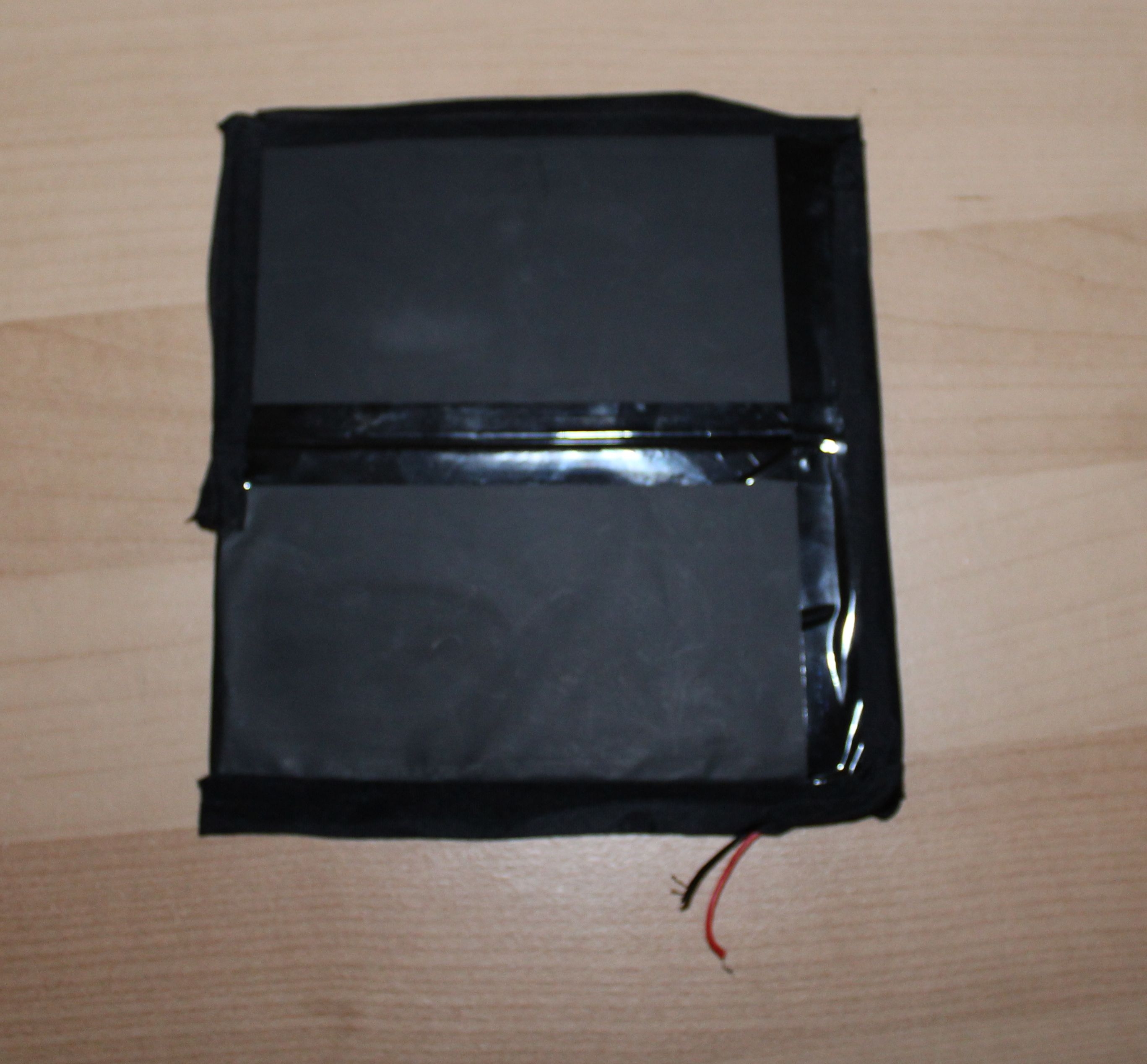

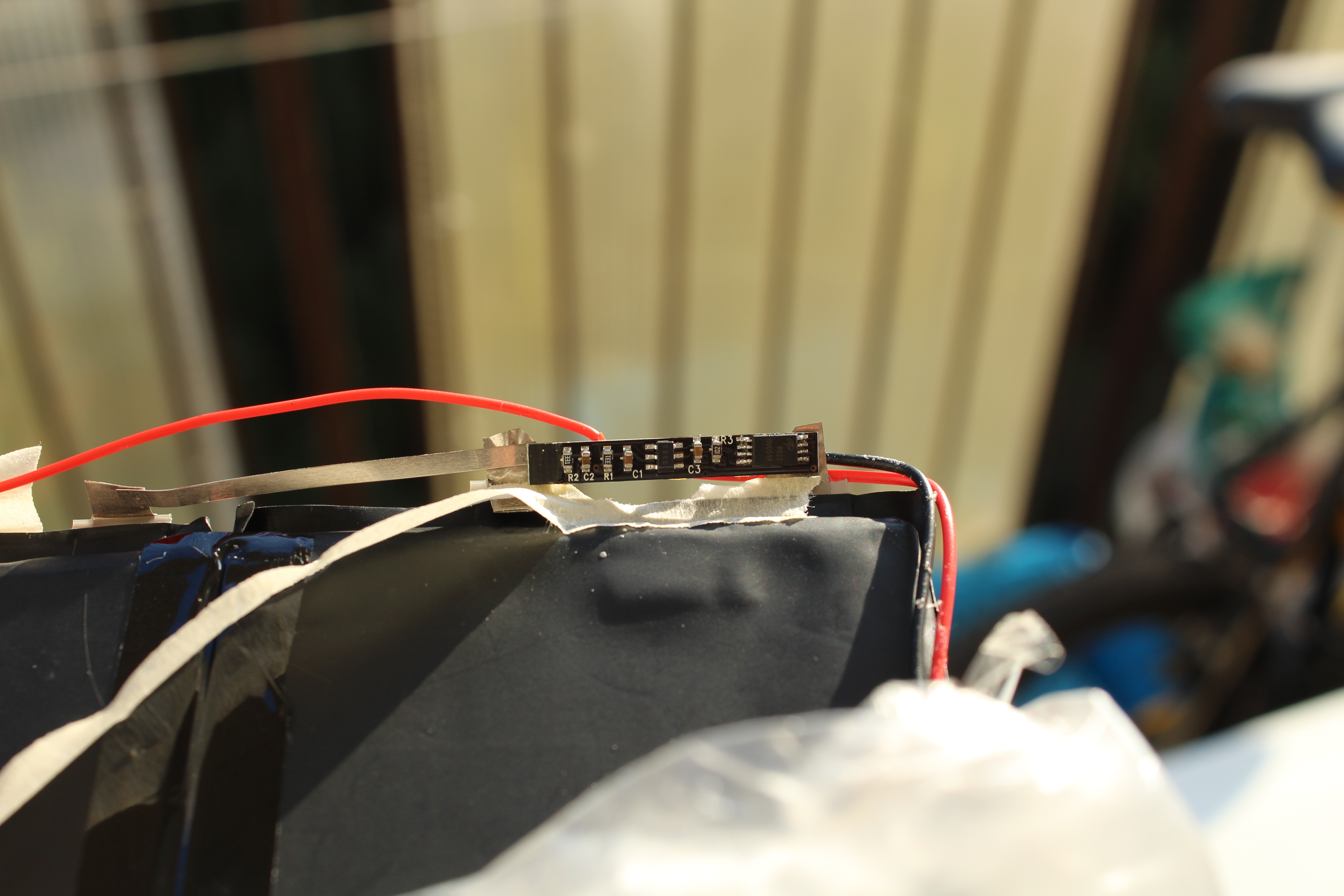

    It's hard for me to say they are 2 connected together. I have an idea to buy rechargeable batteries together to 4.8V and try if it will work. The charger is 5v 2A. I measured on a soldered battery

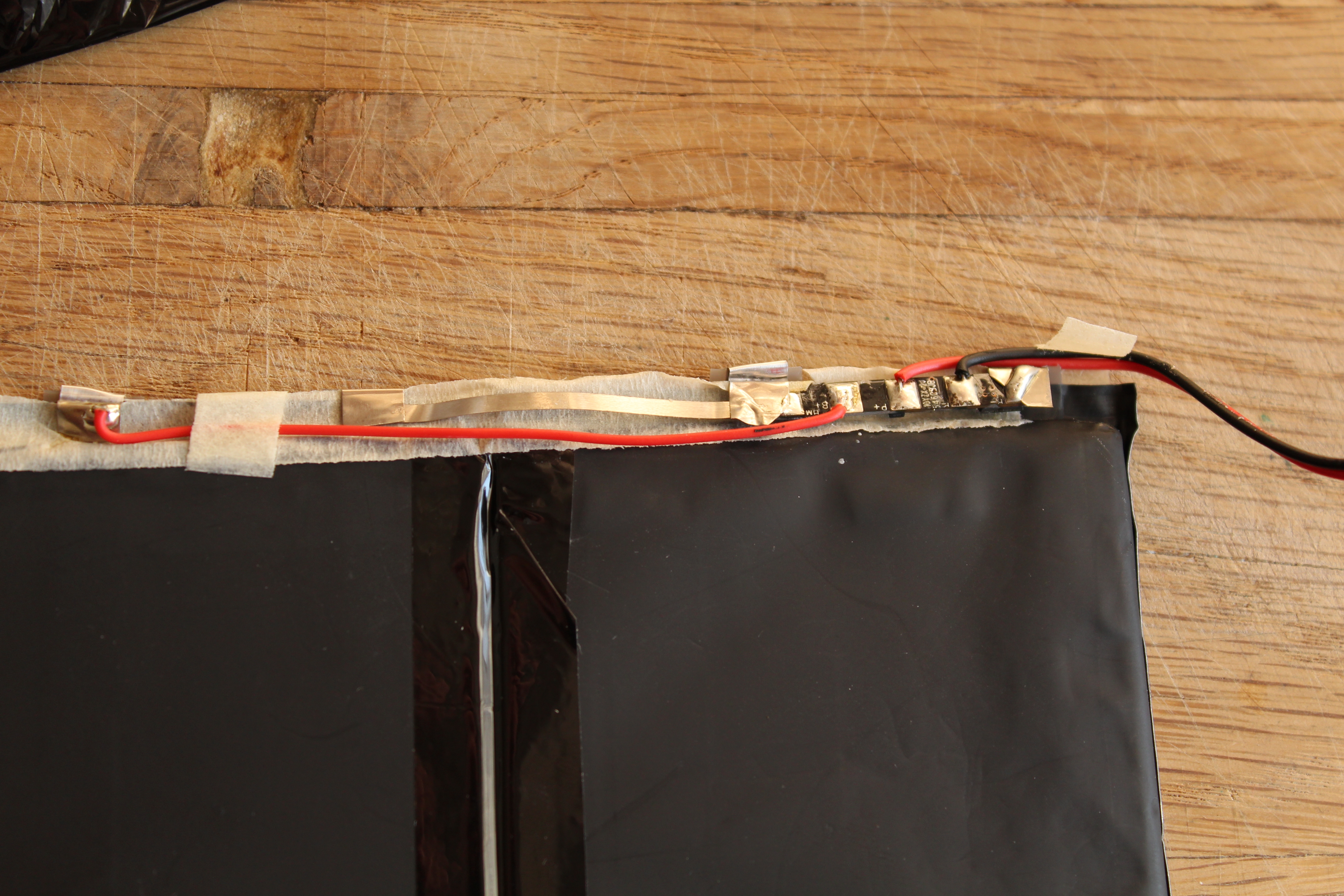

    The battery is usually on:
    3.7V max charged to 4.2V
    and
    7.4V max charged to 8.4V
    Strip these black tapes and check each link separately.
    Provide the model of this KIANO
    And smell if the battery does not smell such a sweet smell lithium, if so it is damaged put it in a bag and close tightly and recycle the vapors are poisonous.
  • #12 16731529
    seba1001
    Posts: 8
    The battery smells sweet. Kiano 10 Dual. One cell has 2.8V. The other has 1.8V
