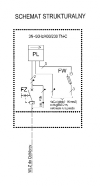

    Tauron Standard

    I even have the tauron standard printed. Today I talked to a guy who works in Tauron and he told me that the size 00 protection gives 50A and the power limiter as in the letter. He was surprised that for a 10 kw connection I should have a 32A limiter

    I don't know which region of Poland you are from, but Tauron (Krakow) has a habit of mounting BMs with a current of 32 - 100 A (depending on the post-transfer protection) and thus constitutes a pre-meter protection, while the post-protection is sealed and also serves as a limiter power.
