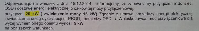

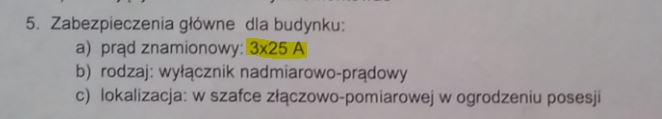

    I am currently reviewing the connection conditions issued by Tauron for one of the investments (reconstruction of a single-family house) and one issue attracted my attention. The ordered power is to be 20 kW, while the main security for the building located in the cable connector is to be 3x24 A.
    Is there something wrong here?
    The ordered power is 20 kW and the main security for the building is 3x25 A

    pearlchili wrote:
    I am reviewing the connection conditions to be issued by Tauron for one of the investments (reconstruction of a single-family house). The ordered power is to be 20 kW
    It is very possible that it is a fuse standard. 32A is 22,080kW.
    Do you lack power? 17.2 kW is not enough?
    It is a single-family house. That's only 2.75 kW of difference spread over 3 phases.
    In a single-family house, the total power taken from the network is averaged.
    For a short time, with 25 A, you can pull up to 30 A from each phase.
    It will not be possible to squeeze even 17.2 kW in a single-family house.
    It is important that the pre-meter is not S303 25 A but 3x 25 A.
    Preferably 3 power limiters of 25 A each.

    It doesn't matter if he uses all his power or not.
    Let ZE then charge a connection fee for 17kW and not for 20kW.
    You have to go to the ZE which issued the conditions and explain it.

    Don't bother, just go ahead and sort it out. Maybe a phone call is enough. If he paid for 20kW, why should he be aggrieved? You have to fight for yours!
    I suspect that someone made a mistake and typed 25A out of habit

    Of course, there is a card in Tauron and it explains for what power and security.
    Of course, here's 32A. And this is not a fad because it affects the selectivity of the entire security system.

    In my humble opinion, the obvious mistake of writing the terms. For 20kW it should be 32A.
    pearlchili wrote:
    while the main security for the building located in the cable connector is to have a value of 3x24 A.
    For the sake of accuracy, not in the cable connector but in the pre-meter in the connection-measuring cabinet.
